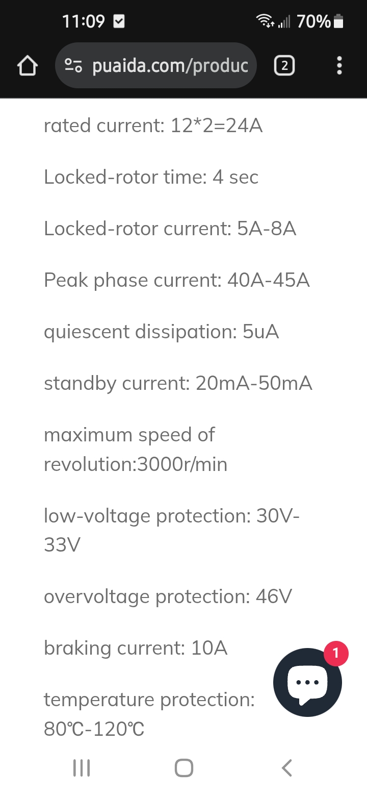

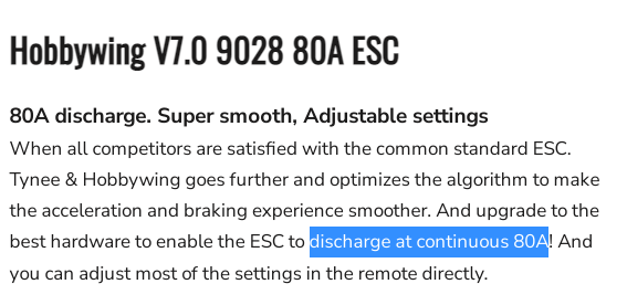

Does anyone know what the 80A on this HW ESC refer to? Are this motor amps or battery amps? Or any other manufacturer for that mater.
I don’t have this exact model ESC, but it says 24 battery amps max, and to use no less than a 30 amp battery.
40-45 peak phase amps
