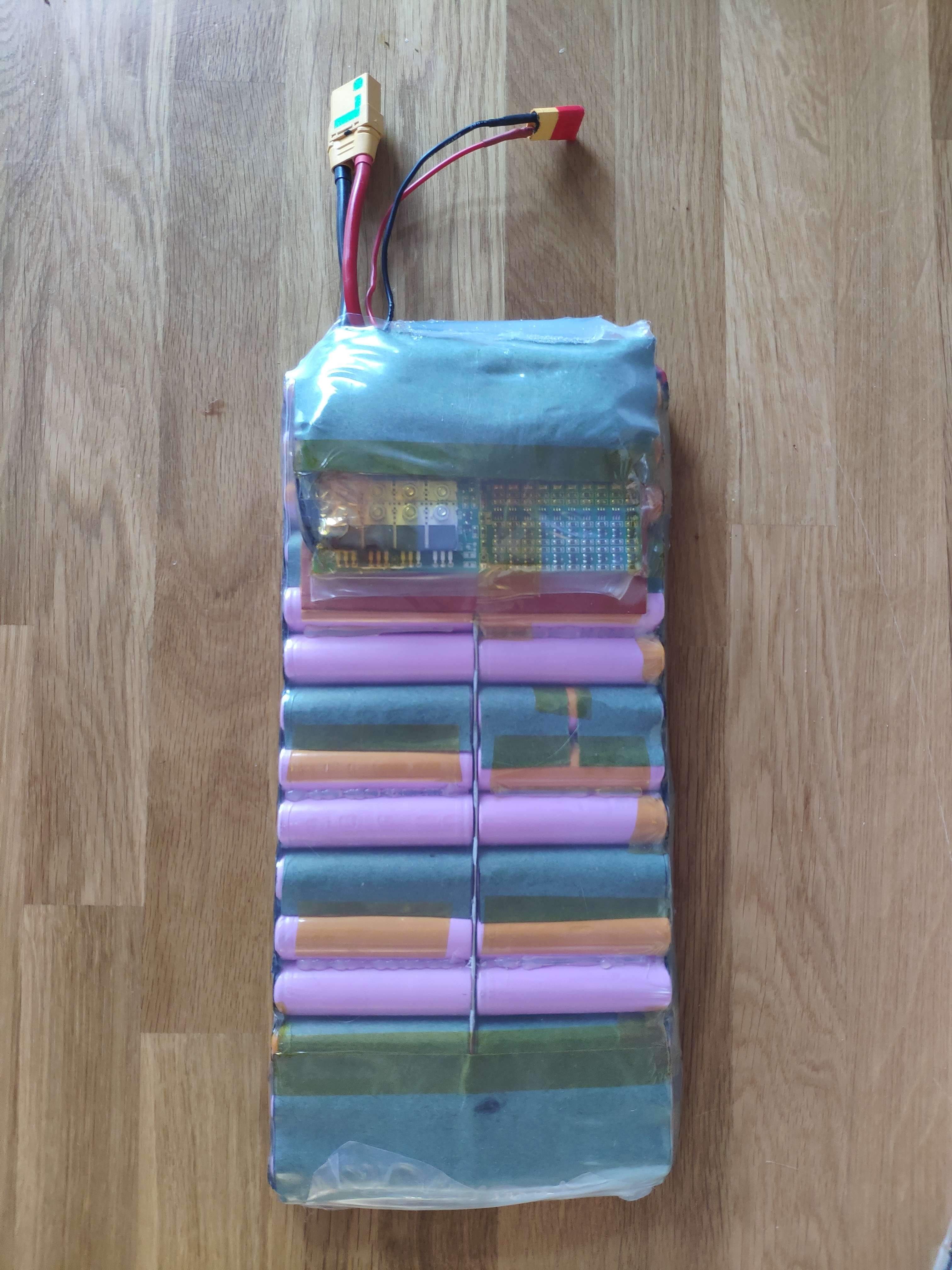

I just fill it with neutral-cure silicone
It’s better if you put a piece of fishpaper on the end as a “cap” before shrinkwrapping it.
And before putting the silicone in, you can put acrylic on the end piece of fishpaper (it will soak into it) to block water ingress.
Thanks for your response!
So this over the end of the battery, then shrink over the top, then acrylic on the fishpaper and seal with silicone?
Any tips on where the wires come out? I’m thinking I’ll use some nylon sleeve, and just shrink the tube around that…
Thanks for the advice @b264 and @rusins, battery has been unwrapped, fishpaper insulation between P groups added, rewrapped with fishpaper ends and neutral cure silicone.

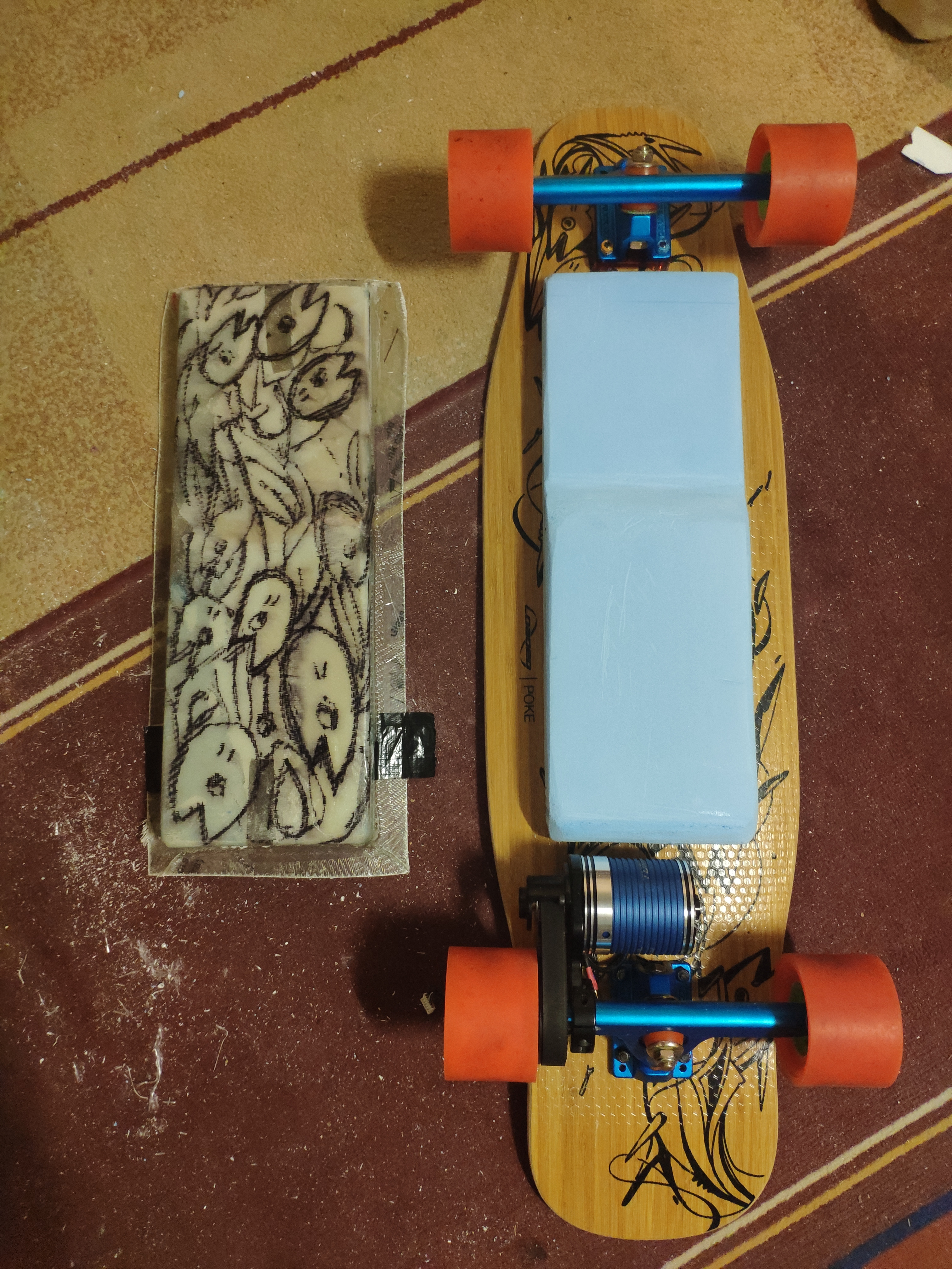

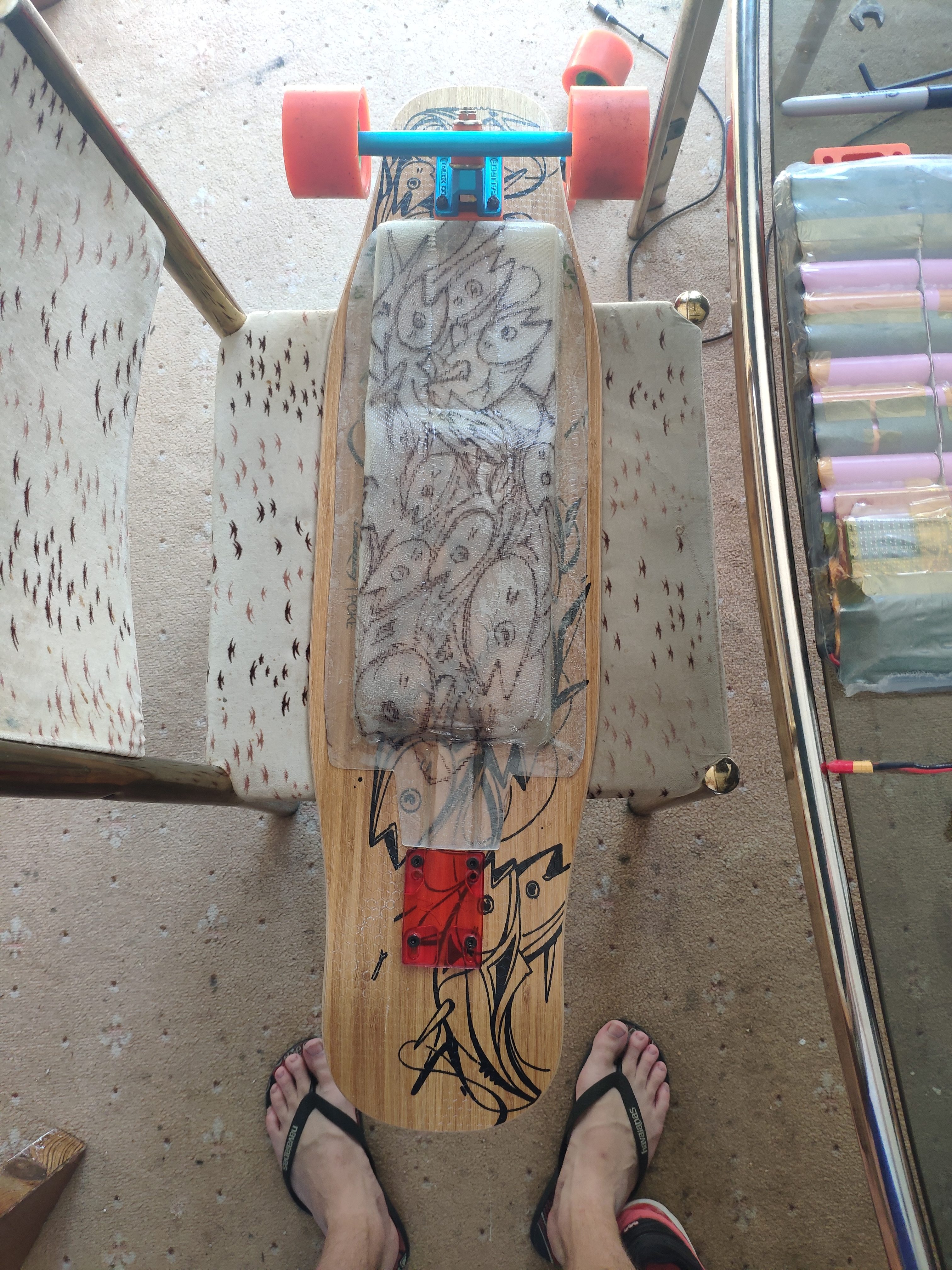

I’ve reshaped an enclosure mould, taking a lot more care now I’ve had the practice run, so next is to do some more reading on getting good corners on fibreglass and get this guy sorted. Rather than holes for phase wires in the back I think I’ll add a shallow channel so they’re more hidden - only visible between the e-riser and the motor.

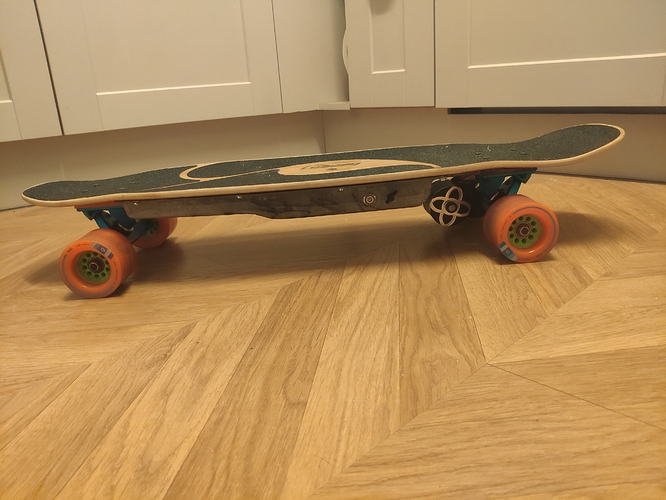

Enclosure MK2. Having seen the colours of the first, I decided to embrace the surf lifestyle vibe of the twill fibre, and reinforced the edges with a draped strip for extra thickness. I’m happy with the look!
Neoprene seal around the edge to stop excessive rubbing (I won’t be taking this out in any sort of wet).
Threaded inserts drilled - that was nerve wracking. Then just had to drill and solder the charge port and wire it all up!

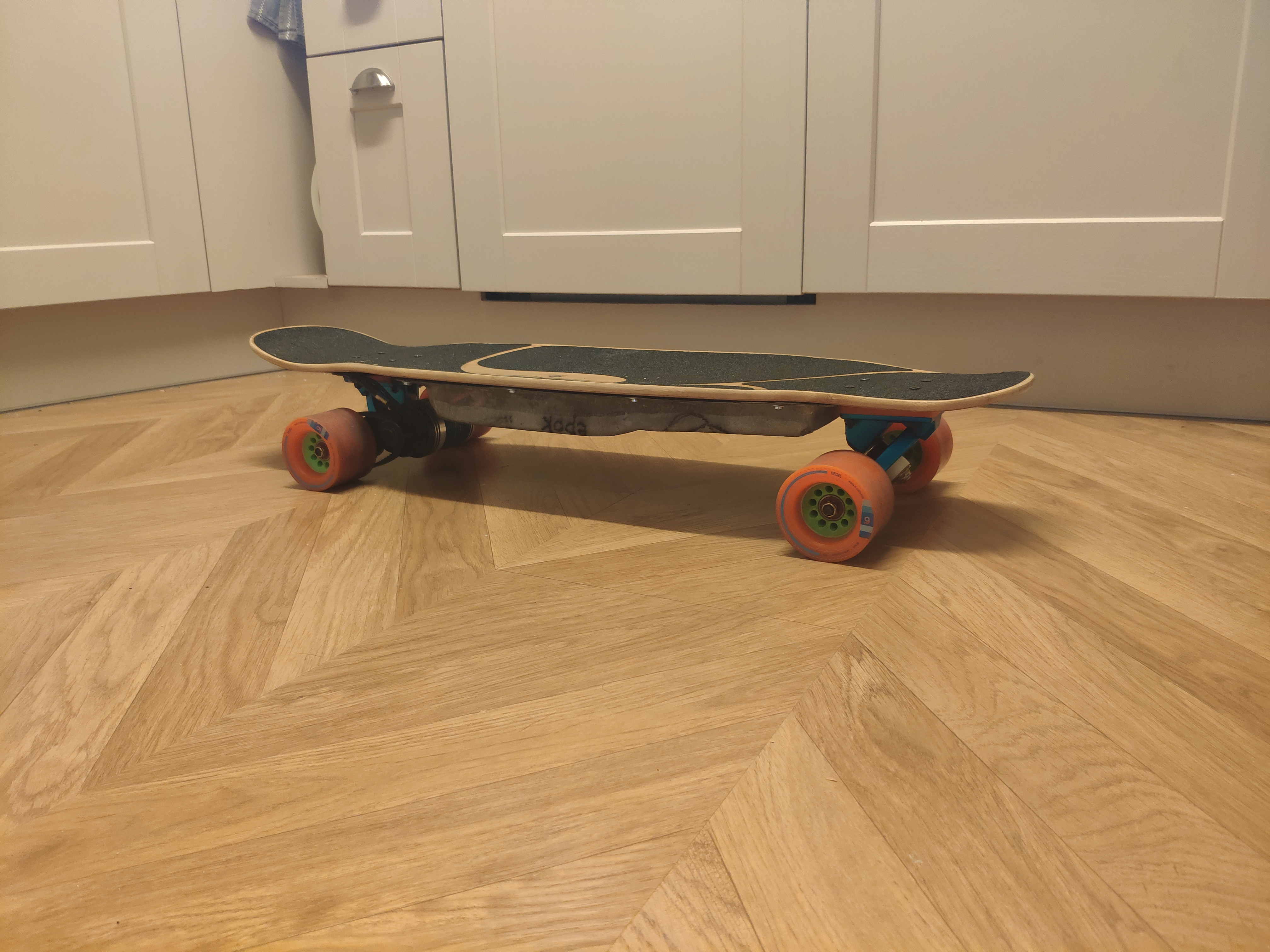

First ride up the road…success! May it see many more.
Thank you for all the help and support this forum has given, both known and unknown.
And a final photo, because I’m pleased with how the underside came out.
