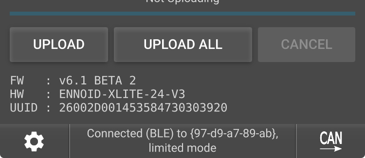

@ENNOID hey having issues with the xlite v3. It seems to work fine standing alone but connecting it to can is causing dropouts - full throttle and brake control loss for up to about 2-3 seconds.
As this presents as a remote signal loss issue i have tested thoroughly with the vx4, zmote, and puck in ppm mode and the vx4 in uart/ppm/ppm&uart and all three remotes have no effect on the dropouts with line of site from the remote to receiver. (Recever mounted inside/ external antenna/ external receiver in a colostomy bag on top of the deck). There is no issue with any of these remotes.
I used both the d100s from makerx and dual skp solos and the issue is independent of of the vesc.
No faults were thrown at any point, i have been logging all my test rides with the megan.
The can network cabling is very robust, i have reworked it three times in order to create the best possible connectivity using twisted pair for the canh canl and isolating as well as possible to prevent interference and get 99-100% communication with all devices on the network except the xlite which is in the 70-80% range with a 10tpi data cable and less than 60mm length.
I tested every combination of connected devices (d100s, skp solo, megan, xlite, tja1050-esp32) and i get cutouts only when the xlite is in the network.

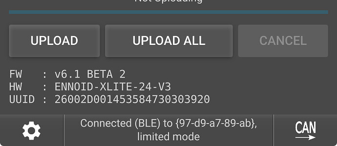

The xlite is on FW6.1beta2 which is what it shipped with to me.
