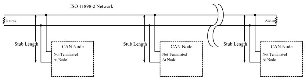

is can bus termination a problem for us when there’s more than two devices? i thought our devices had termination resistors built in.
Iirc total resistance of the can should be 60ohm- so whatever gets me there in the end. If two devices (the solos) have 120ohm termination resistors i am set. If the megan also has a 120 ohm resistor then thinks need tinkering. The ennoid xlite afaik doesn’t have a terminal resistor.

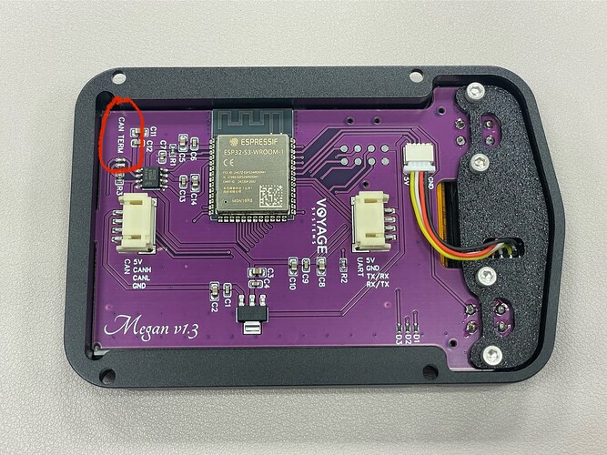

Megan has a CAN terminal resistor but it’s disabled by default. If needed it can be enabled by creating a solder bridge here:

Don’t quote me but I believe it’s not strictly necessary to have exactly two terminal resistors. It will still work with 1 or 3 as well, though it’s not ideal.

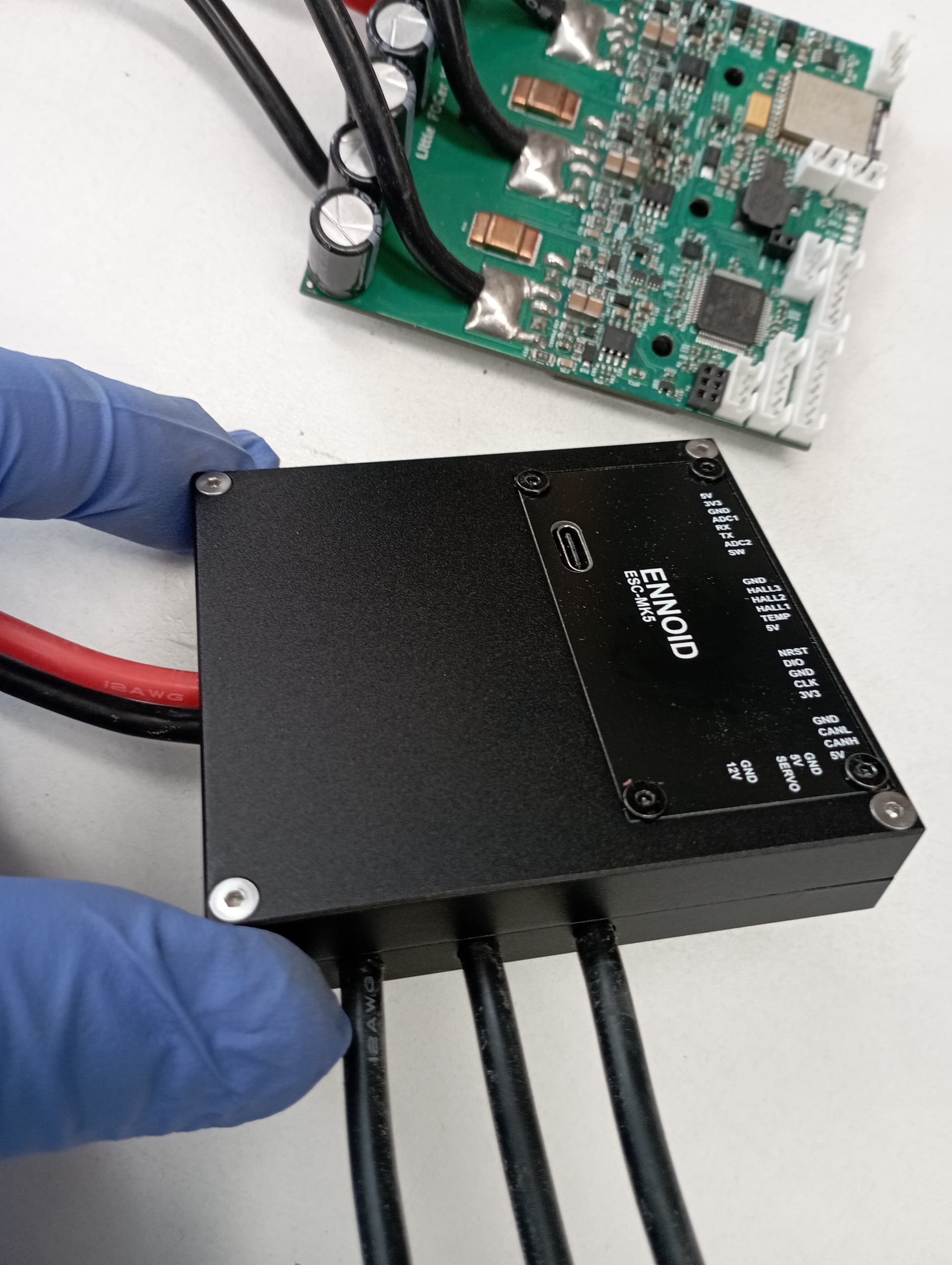

It’s been a while since I posted some news about my latest VESC. Many asked me questions, so I will give some info here.
I’m now up to version MK5 and will probably keep updating/improving/testing the whole thing before going into continuous production
Here are some details and some pictures:

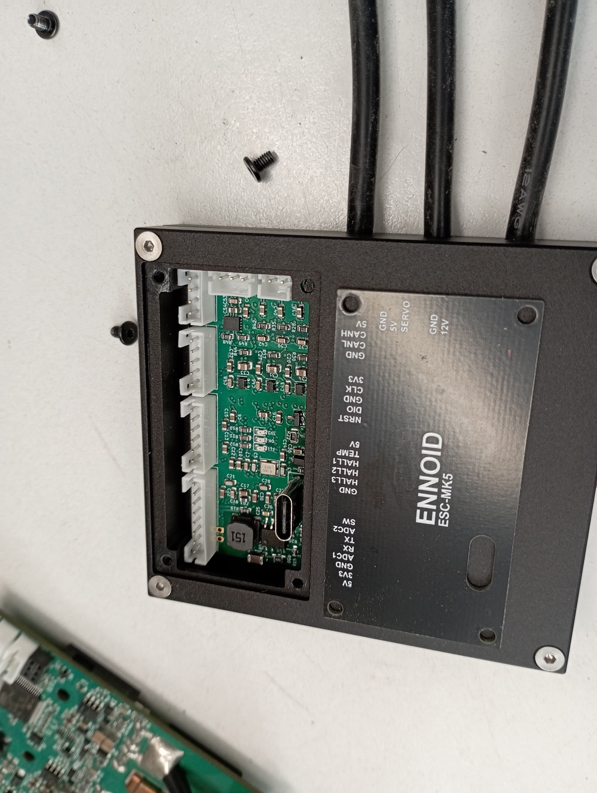

I have a stable 100V version running/being tested for more than 2-3 month with very good results and a 150V version coming-in next week. Both support momentary switch which is a new feature in it’s category. Before that, I went through 3 hardware iteration before getting the push button/auto-shutdown+firmware to work flawlessly. The 100V version also has phase shunt sensor which allows a more efficient and smoother operation than usual low side shunt. Also a first AFAIK. it uses a 6 layers 2 oz fr4-cu pcb with blind vias when needed. It is simply the most complex PCB I have ever made so far
The aluminum case is actually the biggest challenge on my side. I had to go through many iterations and still doing many changes to make it perfect. Cooling is a big deal when it comes to high power and the actual case is very good at it. It is also possible to get the whole VESC watertight when using julet connector to interface with external devices which is very nice.
The 100V uses 1.2mOhm-100V rated mosfets and the 150V version uses 3mOhm-150V rated mosfets. (Using TOLL mosfets)
That mean that the 150V version will not be able to carry as much current as the 100V version on paper, which was to be expected, but both will be limited by the XT60 connector anyway.
Here are the things I’m still working on before going into main production:
  • Reposition the main battery wires for having a top entry instead of the actual side entry
  • Switching to a dedicated 3 pin connector for the switch + another 3 pin for ADCs instead of the actual 8 pin connector
  • Making the Bluetooth module optional underneath the top panel
  • The remaining space under the top panel could lodge a VESC express+SDcard
  • Trying the LM5013 for up to 3.5A 12VDC output on the 100V version
  • Adding mounting holes to the case
  • One additional side hole for passing HALL wires next to phase wires
