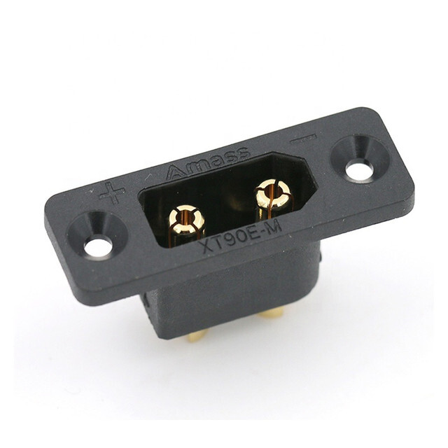

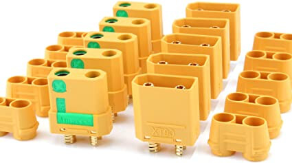

+1 DV6 and loop key is a great option

Isn’t the DV6 now the Pro by default? It says on the website the Pro was discontinued and the DV6 upgraded. Also, would most people recommend a loopkey over a MakerX antispark?

It’s fairly untested and no matter what people say anti sparks are still known to fail
Yes, at least most people here would,
