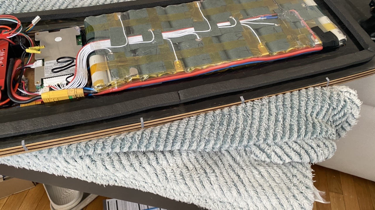

Hello, as the title reads I’m trying to get or make an enclosure spacer for my build. My battery is slightly to tall for my enclosure and I need to add a bit of height. Any suggestions on what I should use? Know of anyone who can make one?

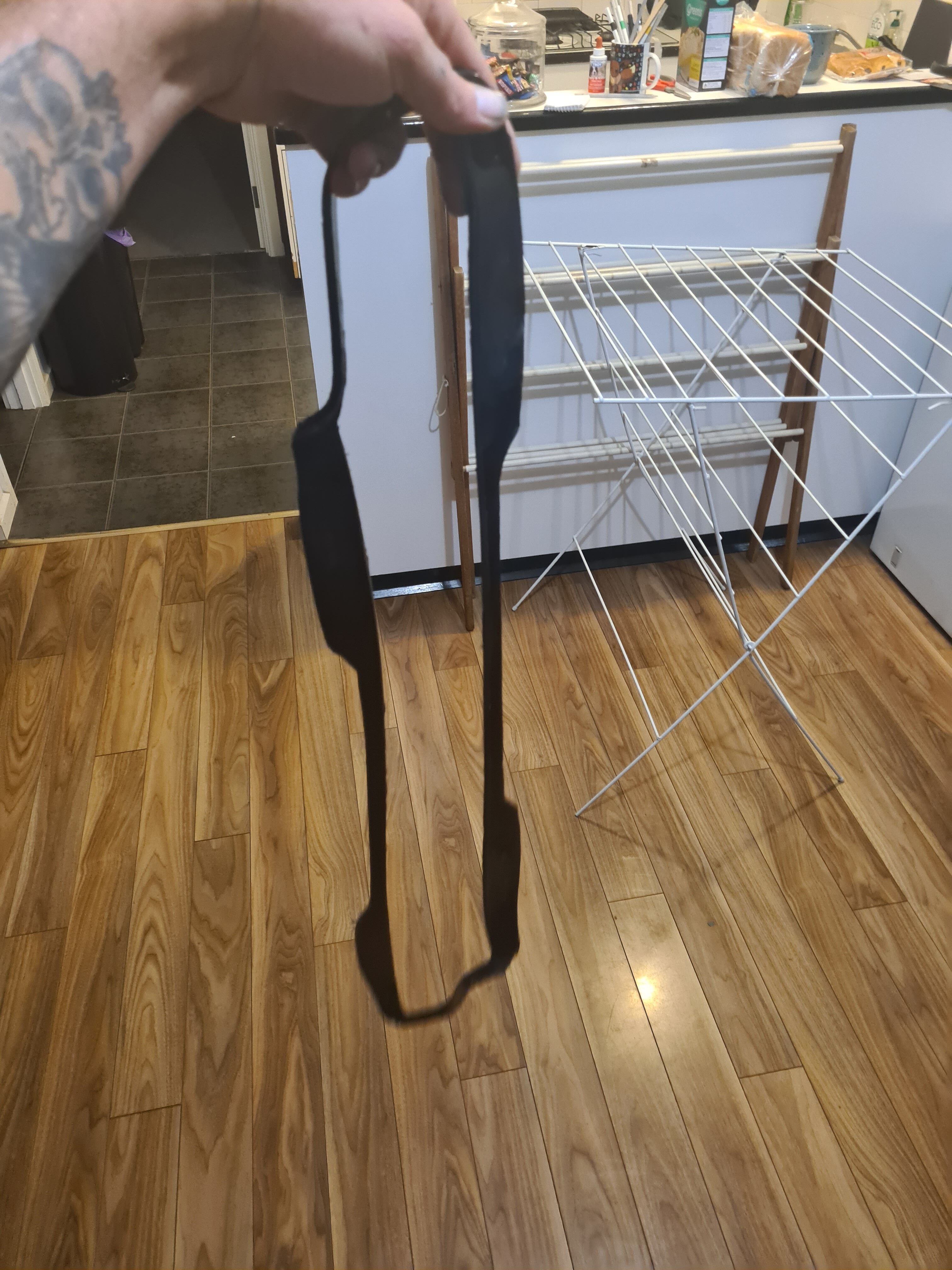

I am using this. It’s fairly thick 10mm and soft. So far so good for the last 2 years on multiple boards.
