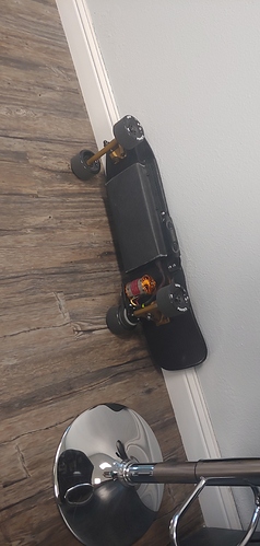

Did mine with a heat gun and edge of the desk. Fits 10s3p with space to spare

Jesus, theres like no space between the enclosure and motor/mounts
Barely.
Fortunately haven’t had any problems with it since.
Damn that’s a good fit… should use it to make a buck for abs/fiberglass enclosures.
