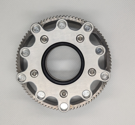

Idk how often people usually replace gears, but from the passed 2 years of (abusive) wear and tear on mine I don’t think they’ll ever need to be replaced. Hardened steel lasts seemingly for ever.
You will need better alignment and tolerances though.
My guess would be that 15 instead of 10 will give a 50% longer cycle life. Since thats aproximately how much more surface area you add.

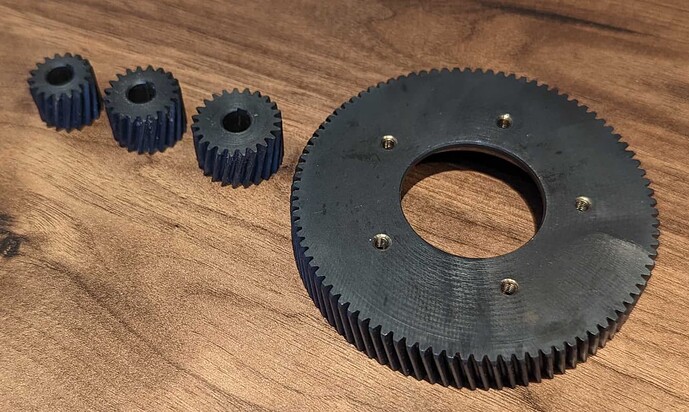

i think you can definitely shave a lot of weight off the bull gears via pocketing. theres a lot of steel there that isnt doing much except increase MOI and overall weight. you could probably take off about half the weight of that gear which would put you ahead of BN if i had to guess. this does complicate machining a fare bit tho so maybe not worth.
i’ve nearly worn out the steel gear on a steel-pom greased gear drive. fast high mileage will eat a drive for breakfast. (hardening will help wear)
i’d take 50% longer life for ~13g weight, reliability is king imo
this is probably (like you said) highly dependent on the precision of the gear’s alignment. if you have perfect face contact then id imagine increasing face width by 50% might even get you more than 50% extra cycle life because the pressures on the tooth surfaces are reduced in addition to there being more gear that needs to be ground away before failure.
How many miles? Backlash makes a big difference on gear tooth wear. There are many of us with over 1k miles on gd and barely any noticeable tooth wear
yeah i definitely agree. i think the weight savings is more than 13g tho. Also, I think the main thing you gain from smaller face width is the increased space afforded for motors tho.
That photo is of the prototype V1 gears. The V2 bull gears are already pocketed that’s one of the ways I managed to reduce weight . Great minds eh :wink:

Totally agree mate especially for mountainboarding where people are riding on rough terrain, pushing the limits of toque on steep inclines and doing jumps; robustness is a high priority.
The downside is added weight, but I think I’ve solved that, only 687g per drive is pretty decent. The width of the drives are not an issue either I have 6384 motors mounted and there is plenty of room for 63100 motors :metal:

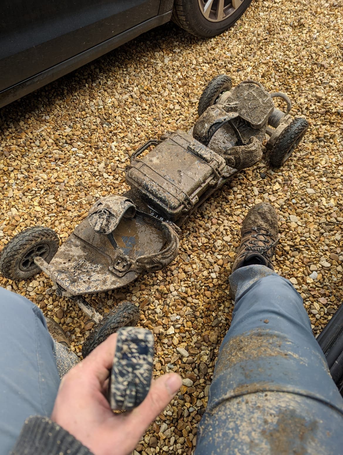

Update! – Prototype 2 Testing
Sorry about the lack of activity on this thread, I wanted to put some miles on the V2 prototype drives before going any further with the design. I’ve pretty much been riding exclusively offroad including mountain bike trials and pump tracks, in both dry and wet conditions to see how the drives hold up mechanically and to corrosion.
So far there have been no mechanical failures, the main issue I had with the V1 proto was the truck clamps coming loose from the hanger, and some tolerance issues with bearings and pinion gears, thankfully this has been completely fixed with V2.
