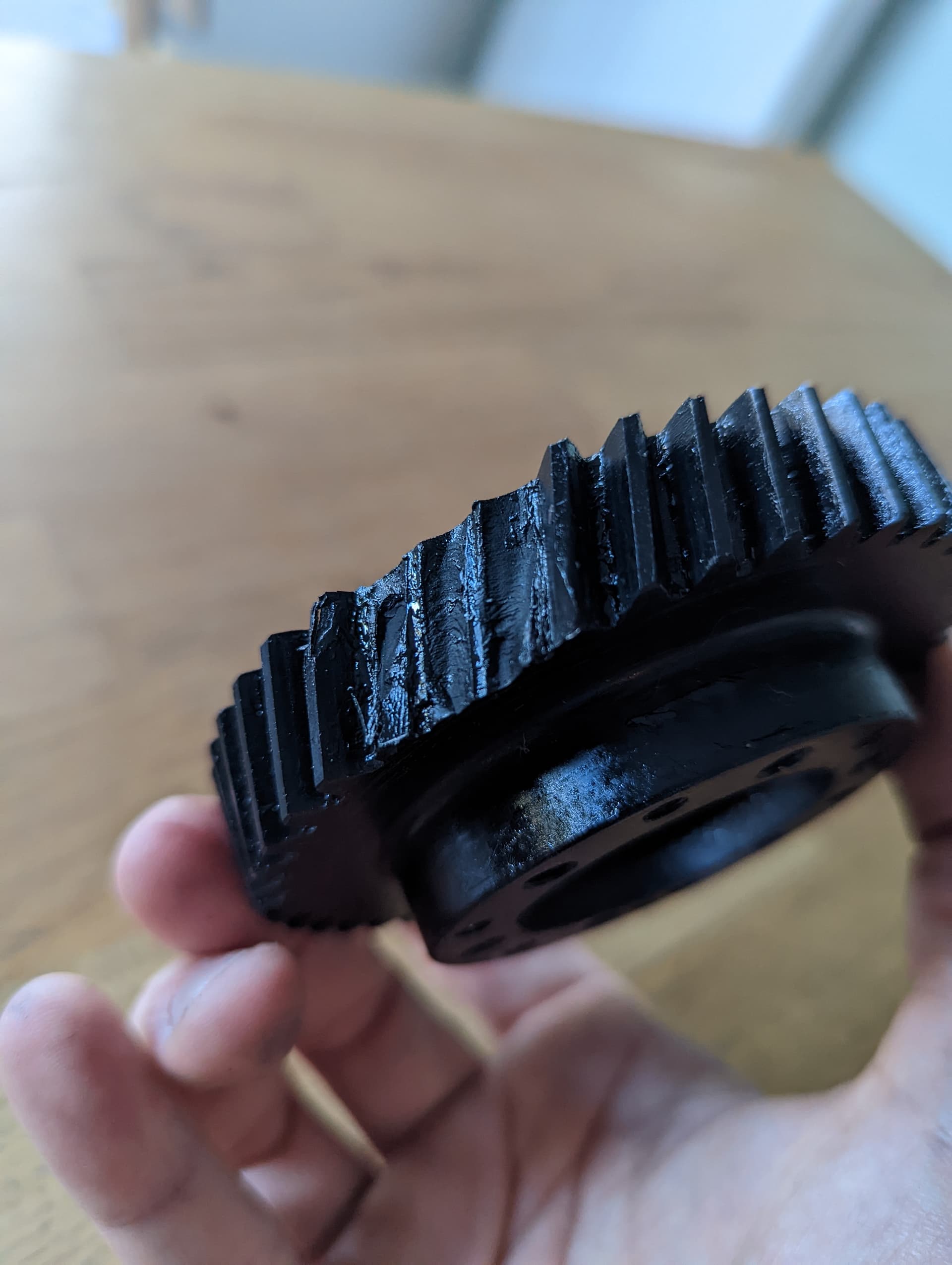

most breaks are from backlash or fast speed and impacts
also mod 2 gears are high pitch, and mod 1.5 have more of a deeper growl sorta sound (just what i’ve found form riding the two)
