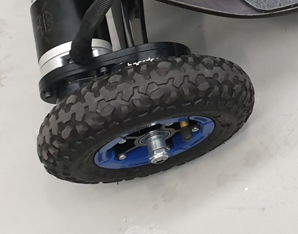

One observation I had while installing the BN drives this week was that there was a hell of a lot of axle left over that needs to be accommodated for with a spacer. (Apex airs, bn m1ats, trampa superstars)
I could just move that spacer to be in between the hanger and the clamp, but then i would lose significant surface area between hanger and clamp.
It would be nice if the actual clamp piece accounted for this and gave you maximum contact with the hanger while also being spaced appropriately.

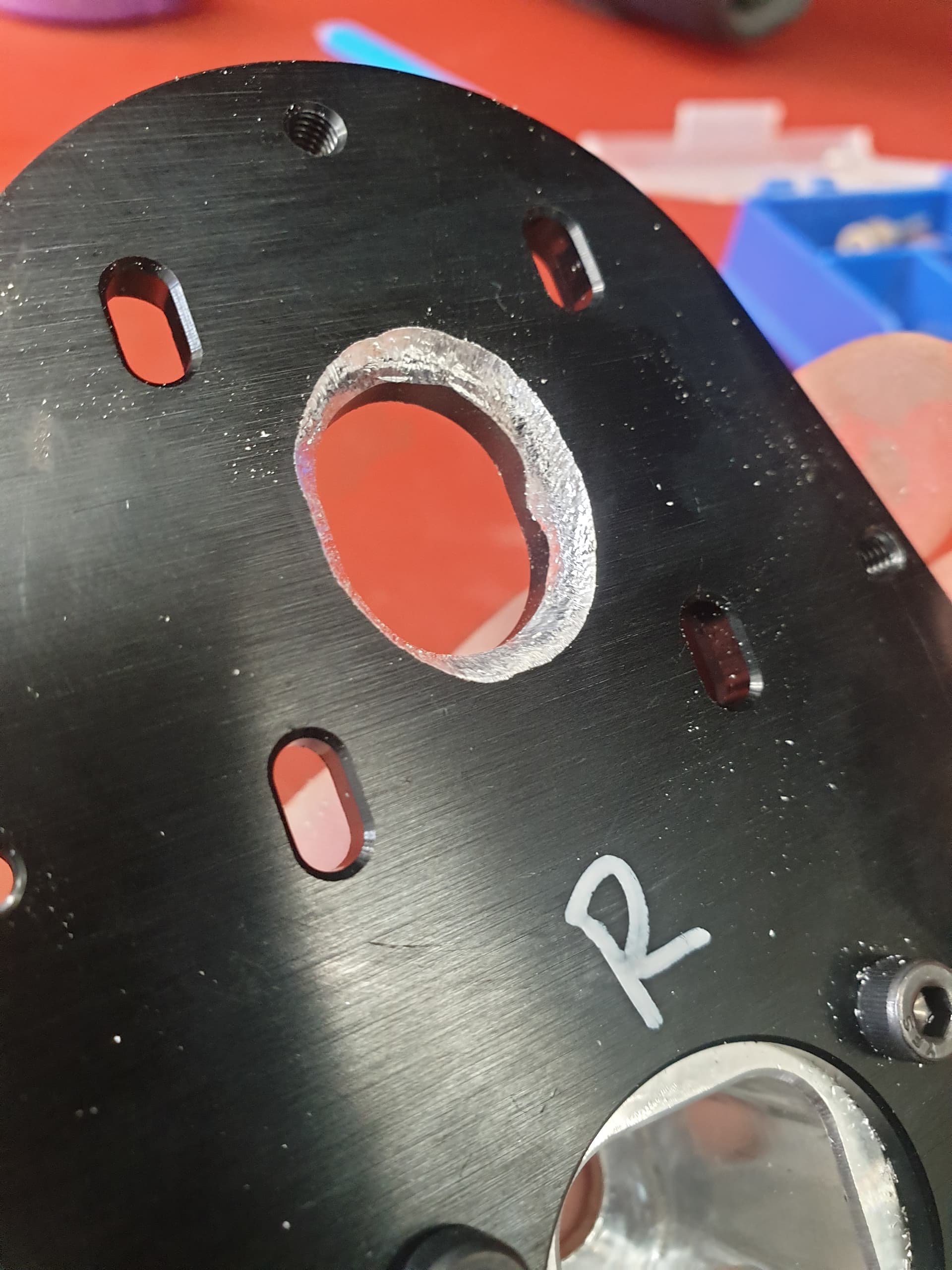

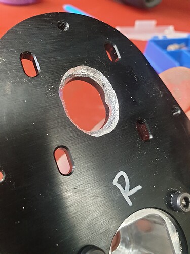

Also this one has stung me a few times with different mounting systems/motors… some motors have the shaft circlip proud of the mounting face. It would be nice if all mounts took this into consideration, as it requires some crude work to allow the circlip to spin freely if the hole is too small :sweat_smile:
