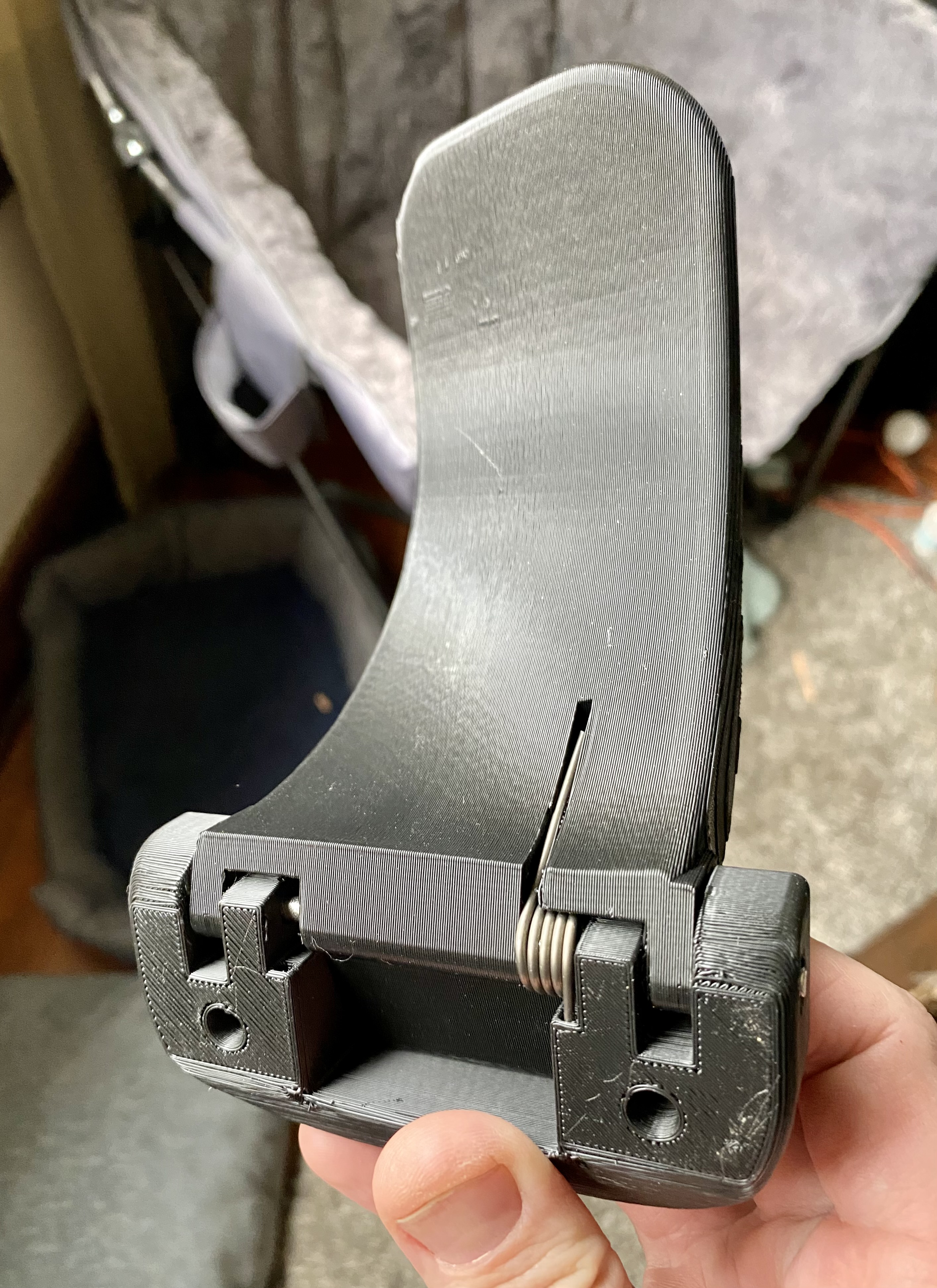

The bindings are an exciting part of the build. I’ve been thinking about a ratcheting open-toe binding for a while. I finally got around to designing one and so far I like the results. The basic 3D printed models feel really comfortable and sturdy. I’m looking at quotes for Multi-jet fusion prints made with glass filled nylon so that I can test these out with a more “production-level” prototype.

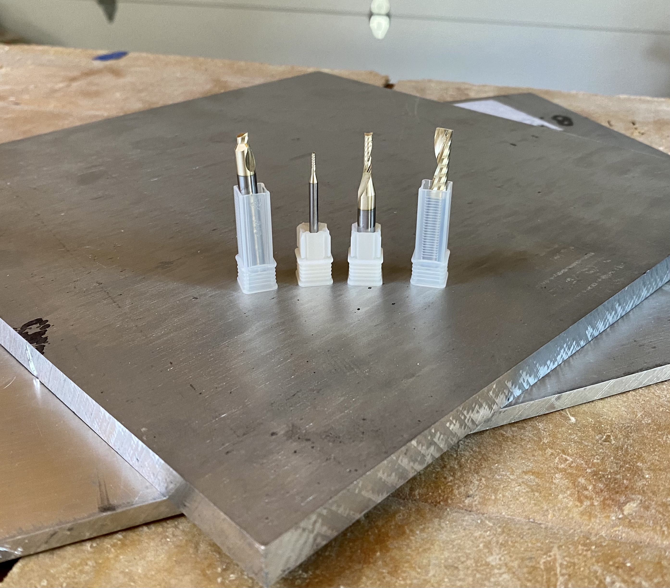

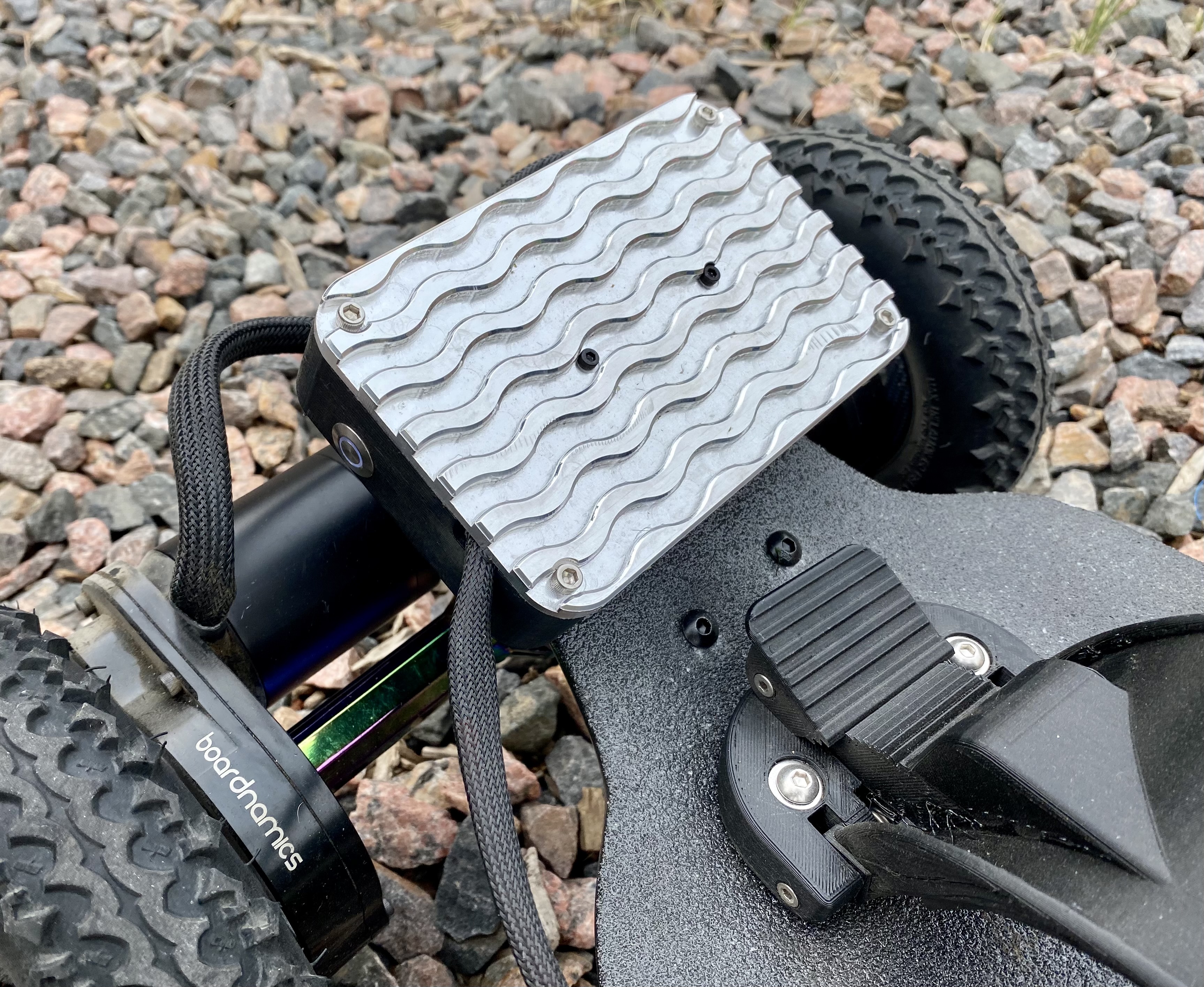

I printed up a box for the zenith and I made a custom heatsink for it. This was my first real try at working with aluminum on my table router. I ordered all of the right bits and I got some 1/4" aluminum sheet for the project. Things went well. The heatsink looks sharp and I didn’t ruin any bits :sweat_smile:

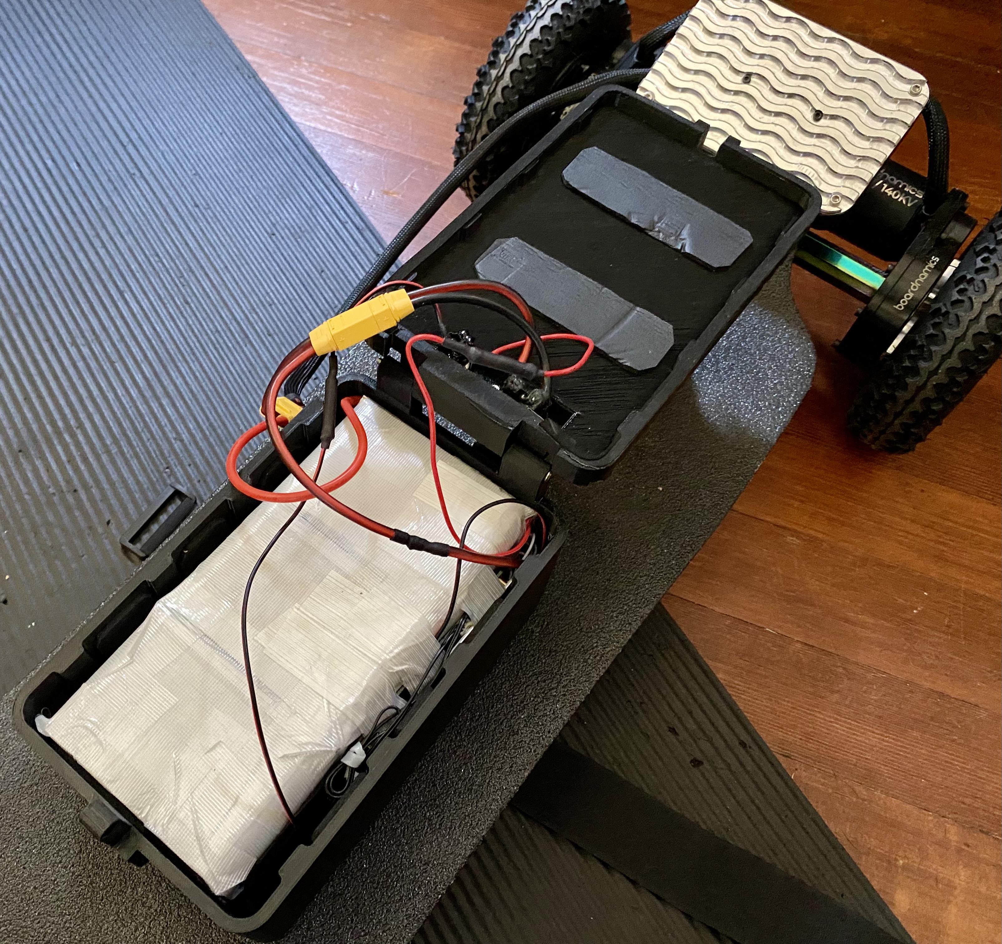

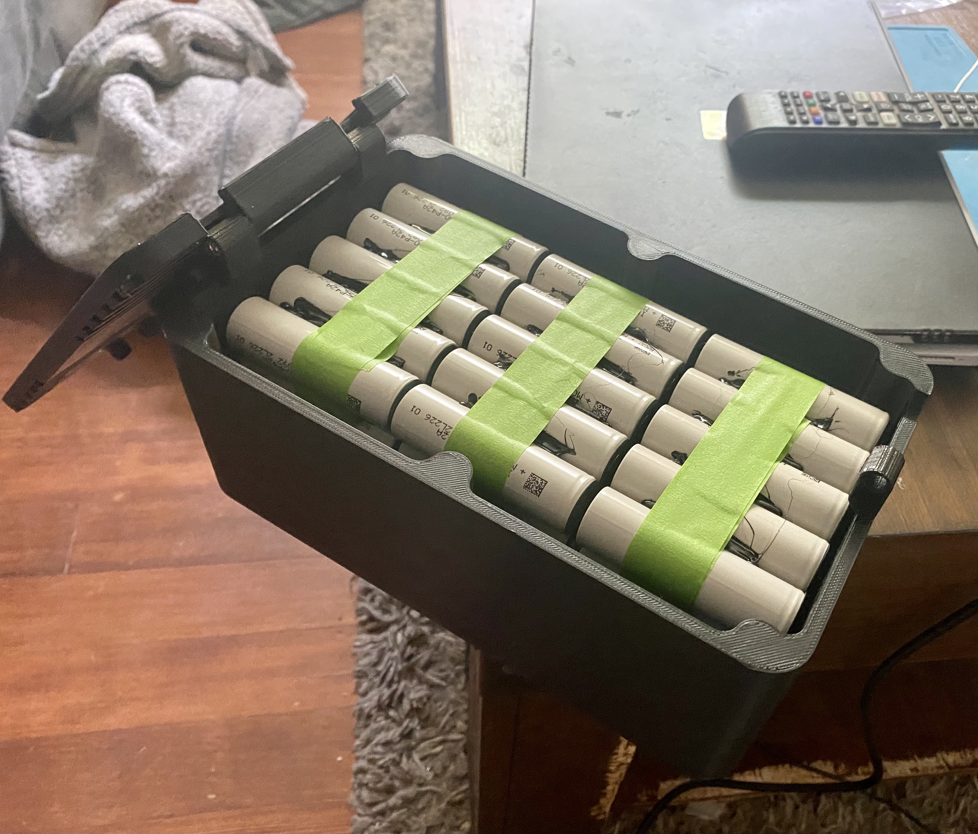

Lastly, I maxed out my printer and made a custom battery box. It’s big enough for a 12s5p 21700 p42a pack. and it’s also easy to interchange. I matched the pattern on top of the battery box to the heatsink. Also, I added a loop-key with a panel-mount XT-90 that I found at duckbatterysystems.com :+1:
I’ve been riding this board quite a bit this week. I might be onto something with these bindings guys. They worked out really nicely. Made out of the right material, they could be legit.
The boardnamics set-up screams a little at high speeds, but not too bad. I like having stuff like this available in the states and the quality seems really good. So far I like them quite a bit. Speaking of having things in the states, I’m excited about the zenith. The price is right and I can get a new one in three days if it burns out. That is if BKB ever gets more in stock :roll_eyes: With a heatsink the Zenith is doing really well. It’s hot here and I’ve been pushing it. The performance has been great.

I’m stoked to see what you figure out from testing the bindings more. Do you have a sense for what amount of force would cause them to release? Are you planning to use them more for stability/control or jumping? Maybe both? :slight_smile:
The only decision I have a hard time with is the free floating battery wire. I feel like I would trip over it, but I get that hiding it is a bit tricky. Maybe you could run it long the edge of the deck? That’s me projecting though.

Thanks man! I worked hard to make the ratcheting system robust on the bindings. The goal is to be able to use them for jumping. So far I’ve only used them for stabilization and they work well. I modeled the bindings using a 3D rendering of a pair Vans Sk8-hi’s (a personal fav). This along with some trial and error made them pretty ergonomic. I stuck some neoprene to them which made them fairly comfortable as well.
The battery is 21ah so it should last a while, but I haven’t had a chance to do adequate range testing.
Great build all around man! Those bindings are a real winner. Whether you sell them or release the files, they will be very well received.
I’m getting quotes for injection molding. I’d like to make them with fiberglass-filled nylon. The quotes are reasonable.

That enclosure melted while I was riding on a hot day :joy:
