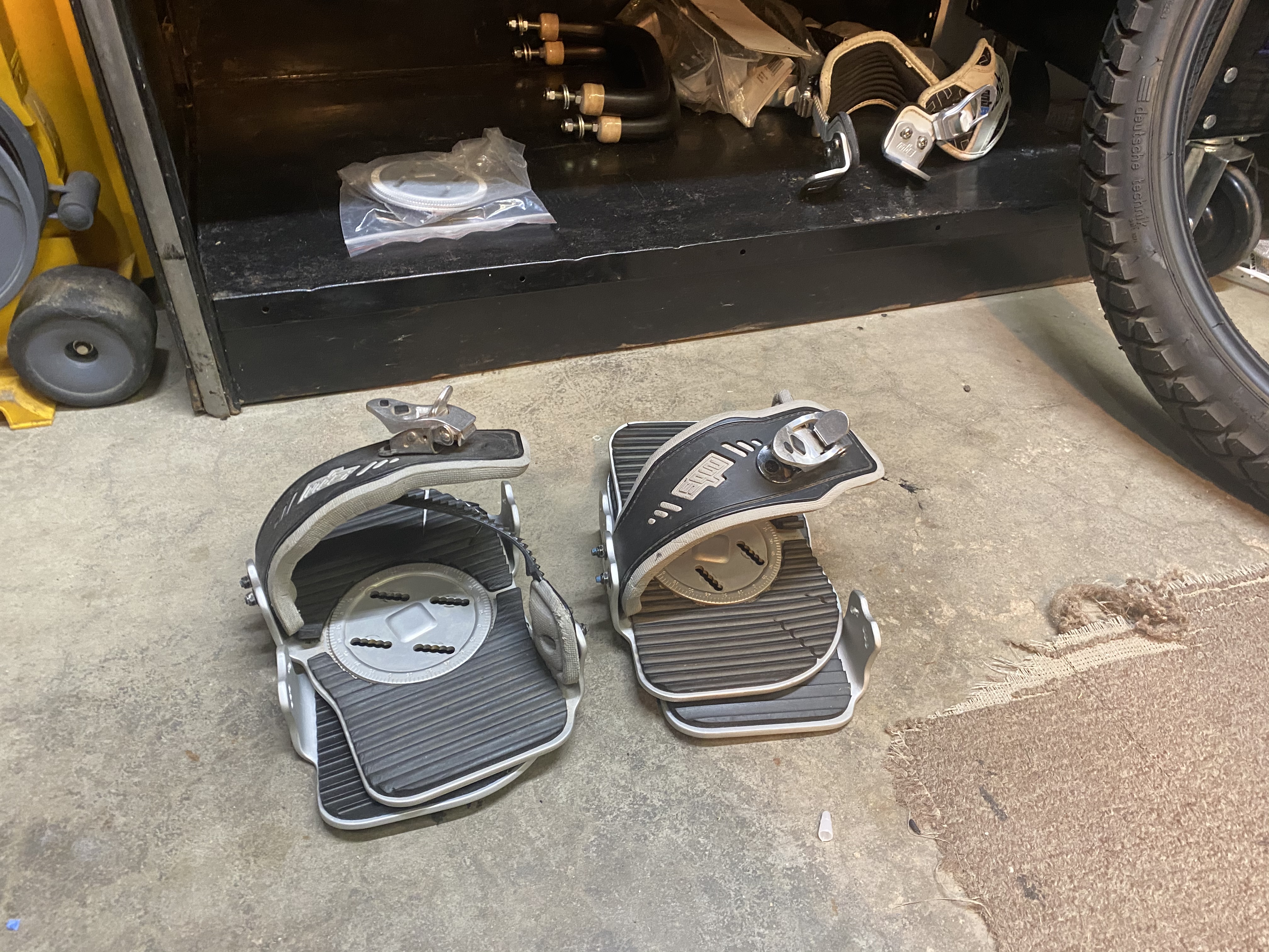

YOBIS v2
@Saturn_Corp gets along great on the yobis bindings from @dani. I would have ridden them more, but I already had 2-3 set of freebord bindings.
-community sourced
-meaty
-potentially slick under hook. Fixes with grip tape
MBS f4
-kinda stiff
-material started flaking around bends.
-could slip out of
-nylon L braces.
MBS f5
-good Contour to top of foot
-probably don’t belong on Hummie deck
-better riders than I love them. I traded them away for batteries

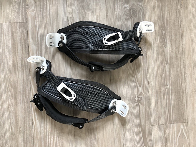

Trampa bindings
-does the job
-kinda thin and may not grip if u ride loose w/o heel.
-light
-ratchet strap doesn’t get caught up in binding padding as with my f5s were prone to.
freebord bindings
-l put on everything.
-hated by deckoz
-needed by s5300
-interferes with toe side turns when racing
-can wear a hole in your ankle if u ride hard. I wear long socks and flip them down to add padding.
-leather insert on hook works great.
-PR guy was a dick once on Instagram.
