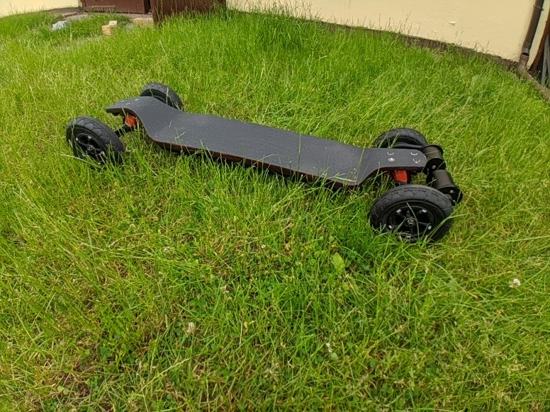

I never showed you completed build:
More posts about this build coming soon I hope. I’m looking for new trucks with mounting btw :smiley: I don’t really like chamber trucks for long street rides, hard to turn the board at low speed at any degrees. They are stable af though. :slight_smile:
