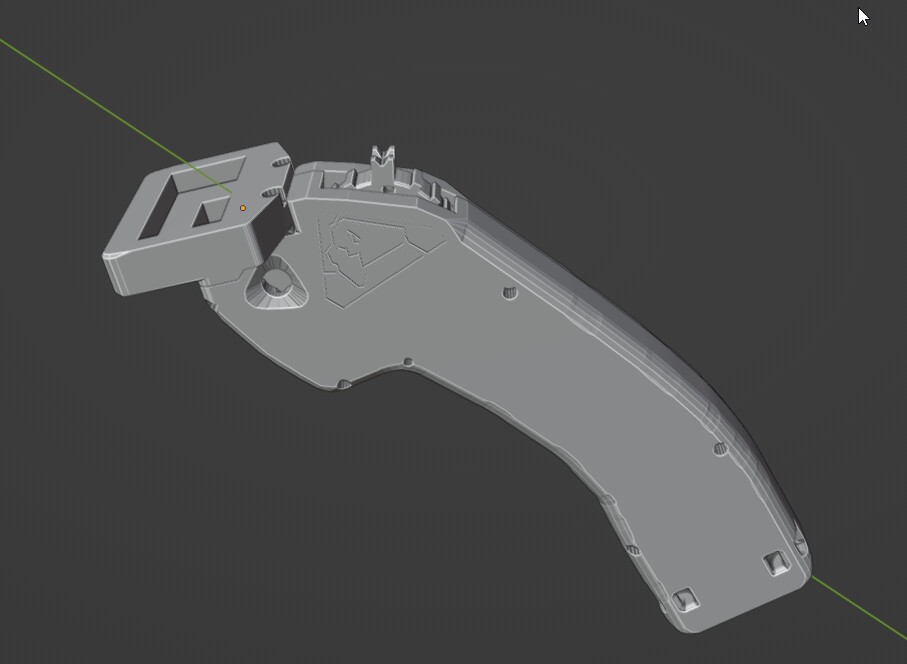

I wanted a remote with a number of specific features:
  • High reliability, low latency connection. ELRS.
  • Durable throttle control with bearings, high reliability sensor and tension adjustment.
  • Ergonomic grip for use with wrist guards and gloves.
  • Telemetry.
  • 3d printed with easily sourced components.
I’ve been gradually working on this project for over a year, at this point I’ve implemented all key features, and I’ve been riding using the prototype for the last 6 months and it works great.

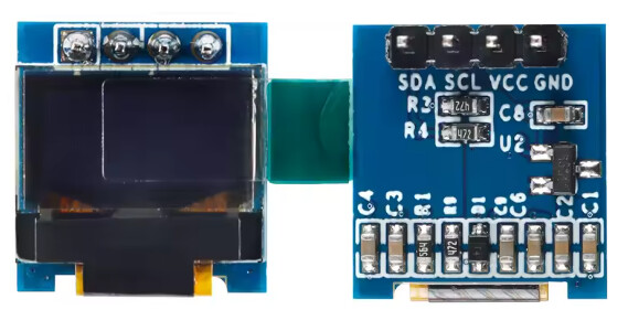

  • OLED 0.49" i2c 64x32
    aliexpress link

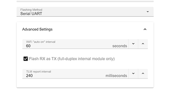

How to flash Ep1 as TX
Go to ExpressLRS Web Flasher
Choose Receiver:
Choose latest ELRS and these receiver settings:
Set your bind phrase, go to Advanced Settings and check “Flash RX as TX”
Download firmware and flash using WIFI (to be added).
Or flash using FTDI adapter and UART, while boot pins on the receiver are shorted (to be added).

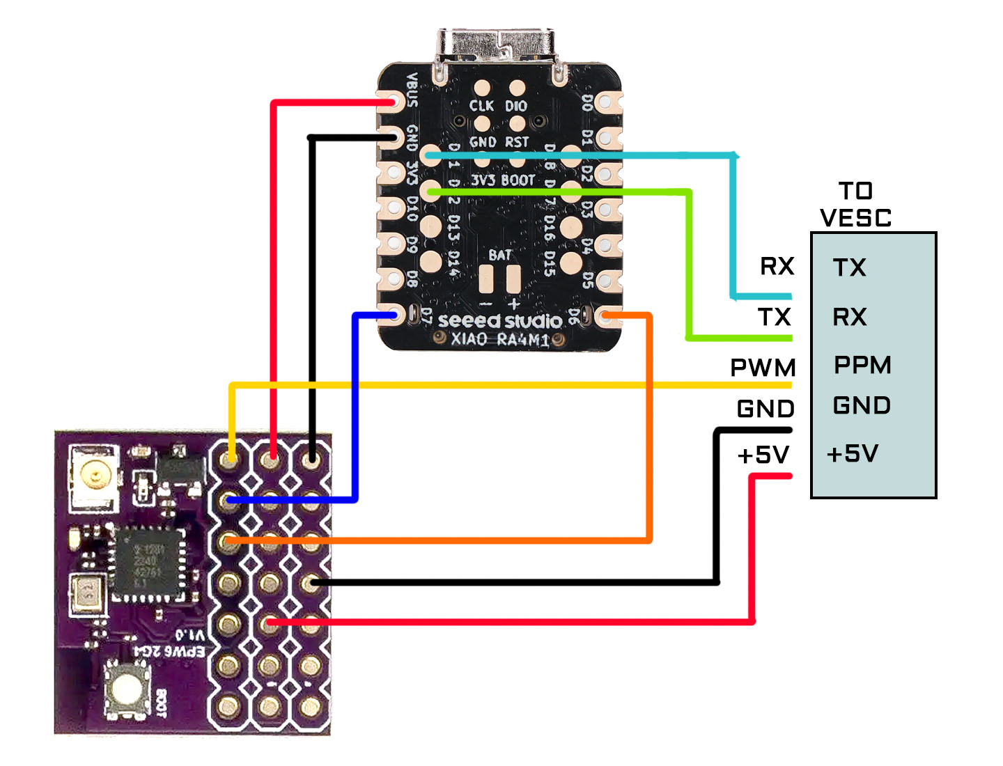

How to configure EPW6 for PPM and UART telemetry
CH1 is throttle PWM, I’ve increased mine to 100HZ, test this for your particular VESC. Make sure to setup failsafe pos to 1500.
CH2 and CH3 should be Serial TX and RX.

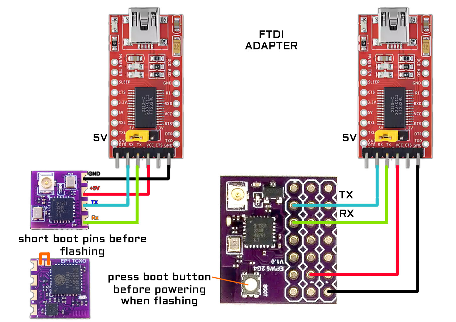

How to flash with FTDI adapter
The “I wasn’t asking” method that I prefer over WIFI flashing.
Bridge the boot pin or press the boot button before powering up before flashing.

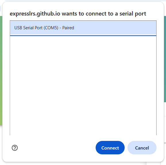

Use flashing method “Serial UART”
Select your FTDI serial in popup

Updated receiver chematic, wrong UART connection.

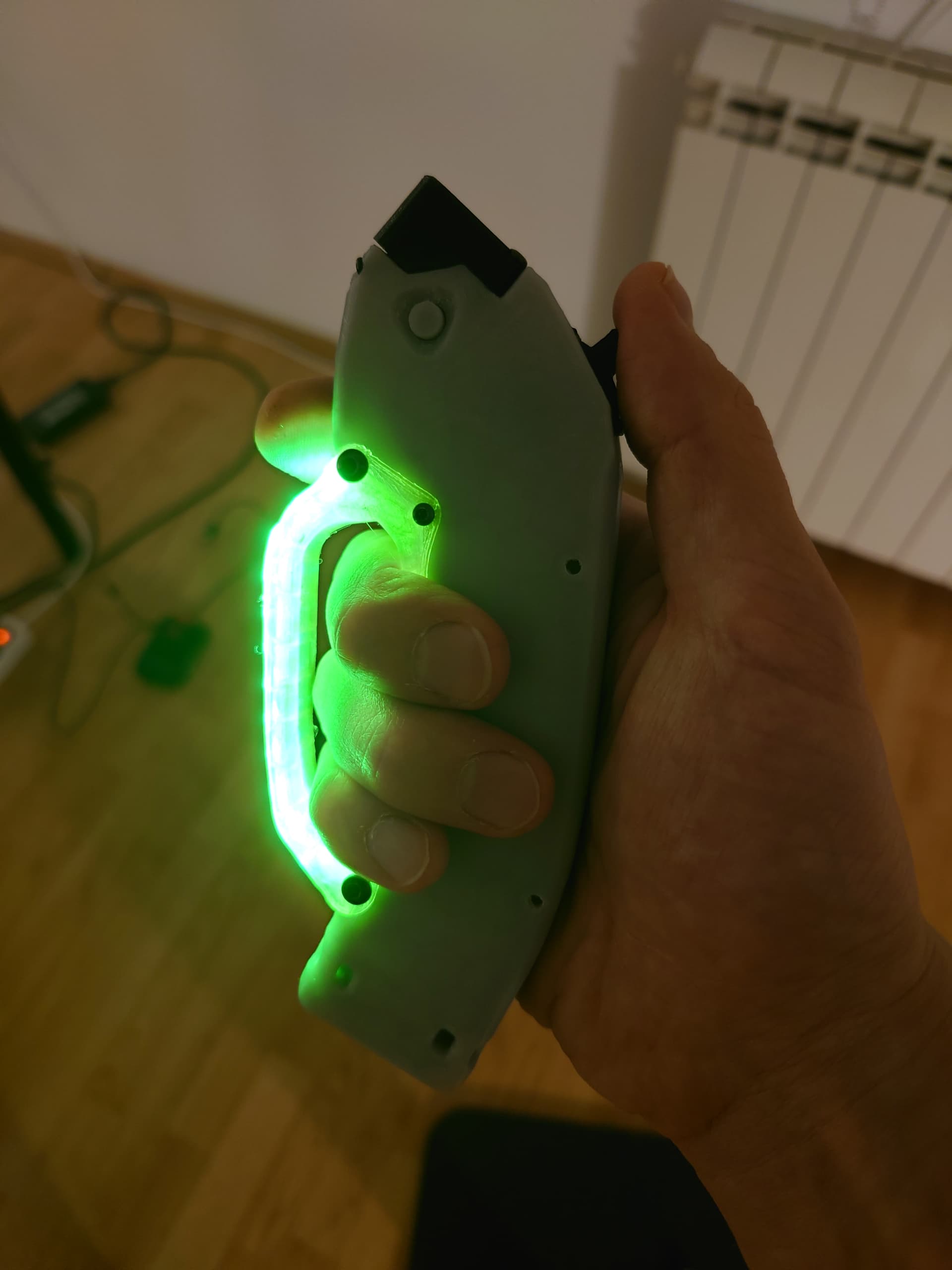

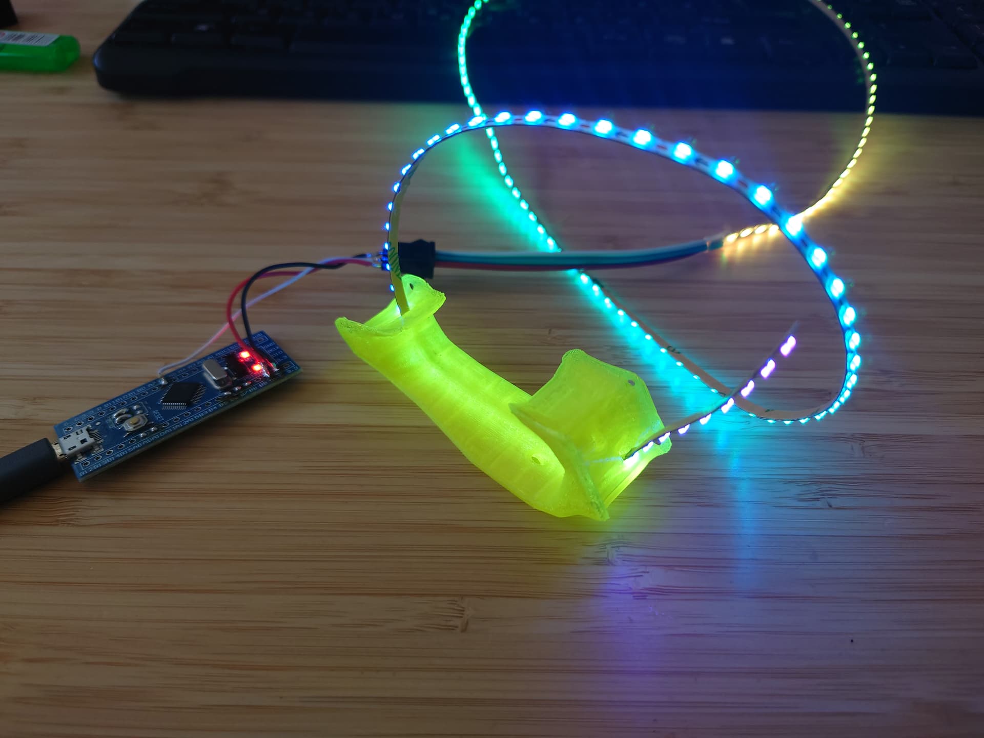

LED strip arrived, really wanted to try this idea with a channel inside the grip.

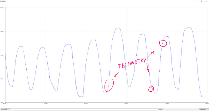

Also discovered telemetry bug after wiring LED strip. According to ELRS documentation in 1:32@250hz ELRS sends bursts of 3 telemetry packets, so sometimes it was missing 2nd or 3rd telemetry packet. Neopixel overrides all interrupts so with 12 LEDs it was missing a lot, and telemetry was really slow.
Still testing it, but I think skipping screen and LED update for 5 updates after first telemetry receive solved it. No missed telemetry anymore.
It’s only telemetry, control transmission was unaffected.
Also realized I need to add bigger grip sizes.
BTW here’s the throttle graph on the receiver, the steps are telemetry transmit from receiver (normal behaviour).
I always test the signal smoothness, I have a spare receiver hooked to a controller and a servo (too much testing, I’ve killed that servo :frowning: )

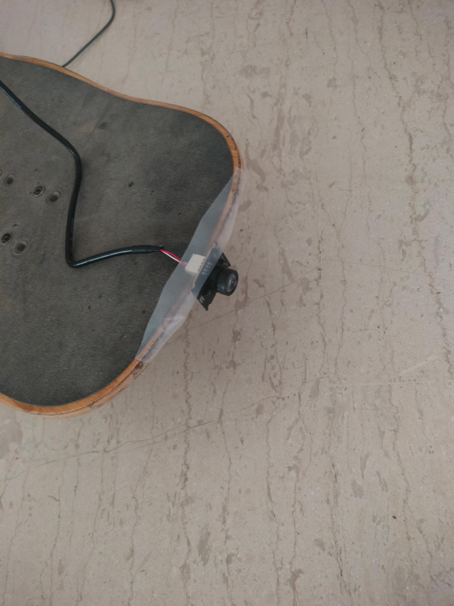

I tried it with the camera on the rear of the skateboard. I used a Raspberry pi (+ webcam) working as a server/wifi-hotspot and a phone . I like it a lot, you can even see me leaning :face_with_tongue:. Anyone can try it with an esp cam?
