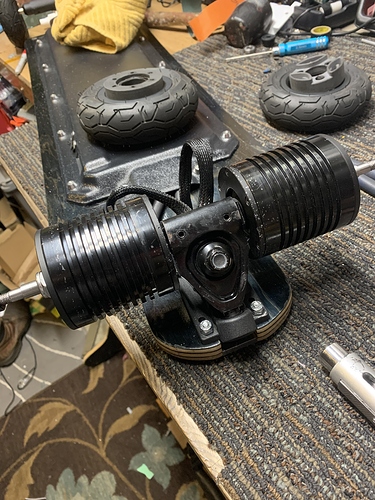

Maybe worth to drill and tap 2 holes for grub screws on the elofty drive to secure it in there even more. From my experience, if there’s even a tiny room for rotation, hard braking will unscrew the nut holding the drive in and make it loose. Grub screw onto the mating surface should prevent that.
Good idea, I’ll take a look at that.
If you can manage to get two in, at 90 degrees to each other one away from phase wires and one 90 degrees to it, it may totally eliminate motor rock…
good Idea @Winfly

In fact I just bought another used eLofty drive system from a member here and I’m going to make a 4wd eLofty 'thane board
:racing_car: :dash: :dash:
Made some custom axels today for the front Kahua hanger I’ll be using. Now the wheelbase width will match.
Was gonna wait until tomorrow for the press at work but said fuck it. Shits getting real tonight.
That’s about it for tonight. Gotta admit I’m pretty stoked. Wondering if I can drop thru mount :thinking:
DOIT
don’t be askeered… I think with a 35 degree base plate and your bottle nose board shape it’ll work a treat.
forward for science
BTW looking real good!!!
That’s pretty cool!
alrighty ya talked me into it. Got the front truck done drop thru. It’s gonna need a tiny bit of deck filing for clearance. I’m thinking I might need to router the top of the deck for a flush mount.
