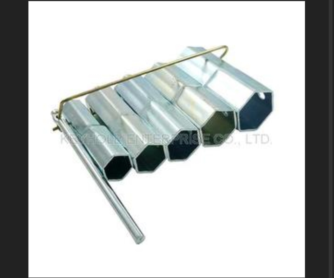

Anyone have a recommendation for a ratchet bit that clears the axle, and allows me to take off and put back on this can nut?
I don’t actually know the size of the nut… So maybe just recommend your preferred set of long ratchet bits? :sweat_smile::joy:
There’s about 40mm of axle to clear before the nut
You need to take of the adapter first, then a normal wrench will fit on the nut :slight_smile:
I’ve removed the screws on the adapter before, and didn’t really know how to take off the adapter… It wouldn’t come off easily and I didn’t want to break anything :joy:

Haha yea i think ur screwed then, use blue loctite for parts you wanna remove “often”. No idea how to remove philips screws with red loctite lol, hexagon is already hard to remove.
Faucet wrench is what I use. Cheap as shit and works great.
(Screwdriver through the holes for leverage.)
Hell yeah, thanks Bill
Now to figure out the size of the nut… :thinking:
They usually come in a set.
that big assed nut on my elofty’s was 19mm if I recall correctly
and that’s what I call it, forever more, the motor nut shall be known as “the big assed nut”
Need a cheap way to remove the “big ass nut” while not removing the adapter screws?
Buy this:
https://www.homedepot.com/p/Husky-3-8-in-Drive-19-mm-6-Point-Metric-Deep-Socket-H3D6PDP19MM/202913533
3 doll hairs and change for a 6 point 19mm socket, and it’s easier than pie.
(It should be noted though that my drives had the nuts glued in… At least I think it’s glue. Don’t be afraid to give it some oomph)
