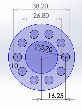

Looks fantastic! Did you have to do the CNC milling again or did my original dimensions work?
Your original dimensions did not work. I had several prototypes made before it finally happened.

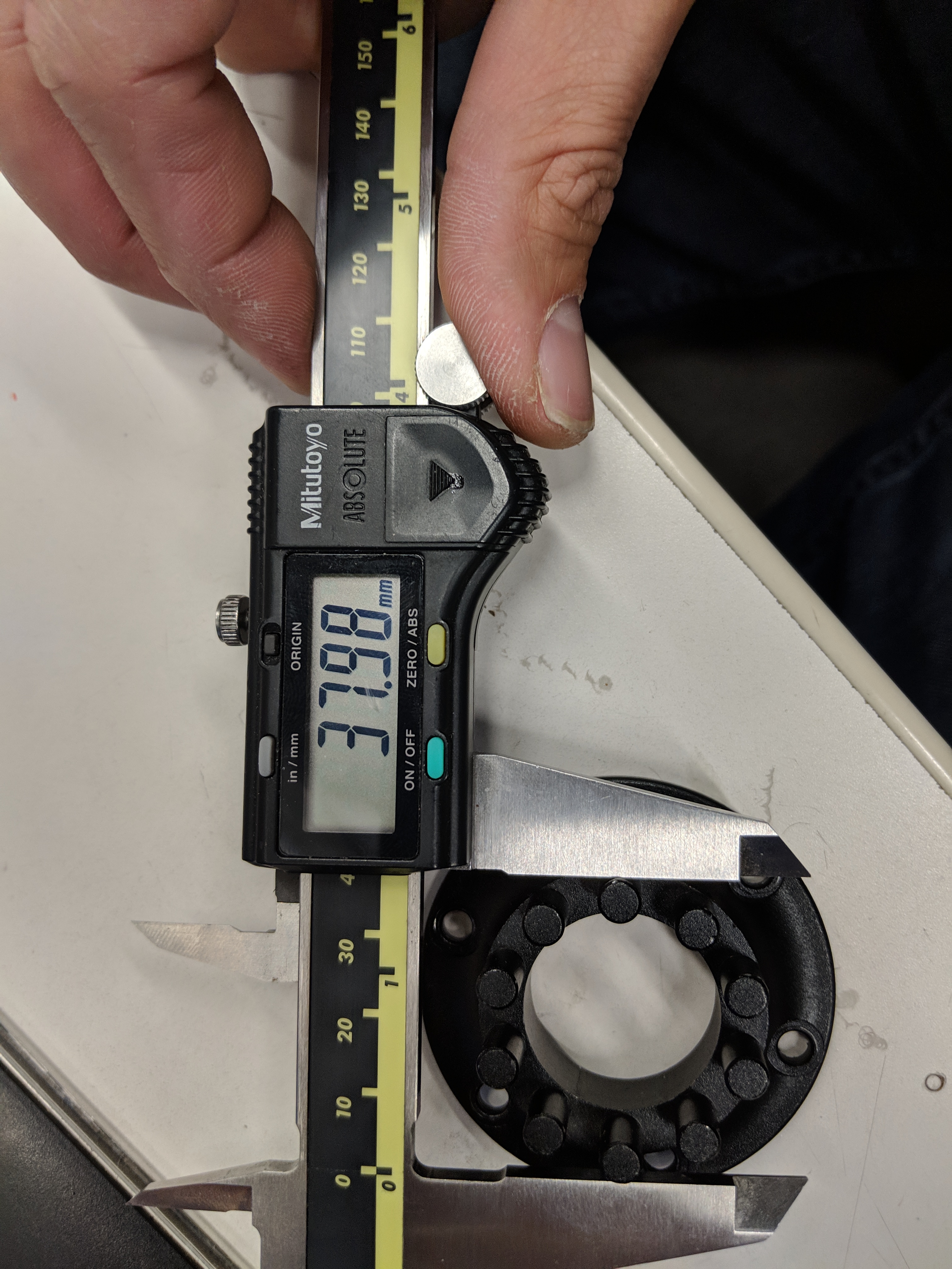

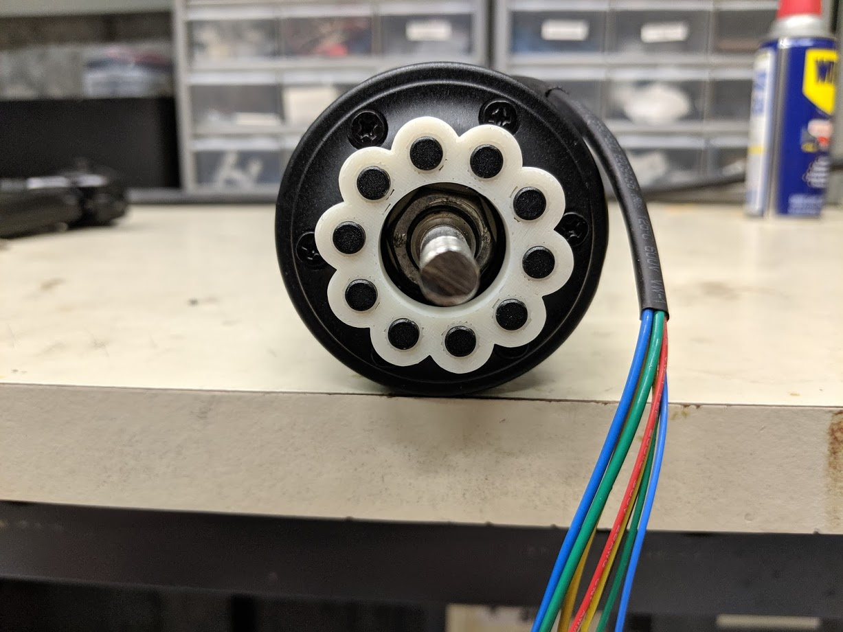

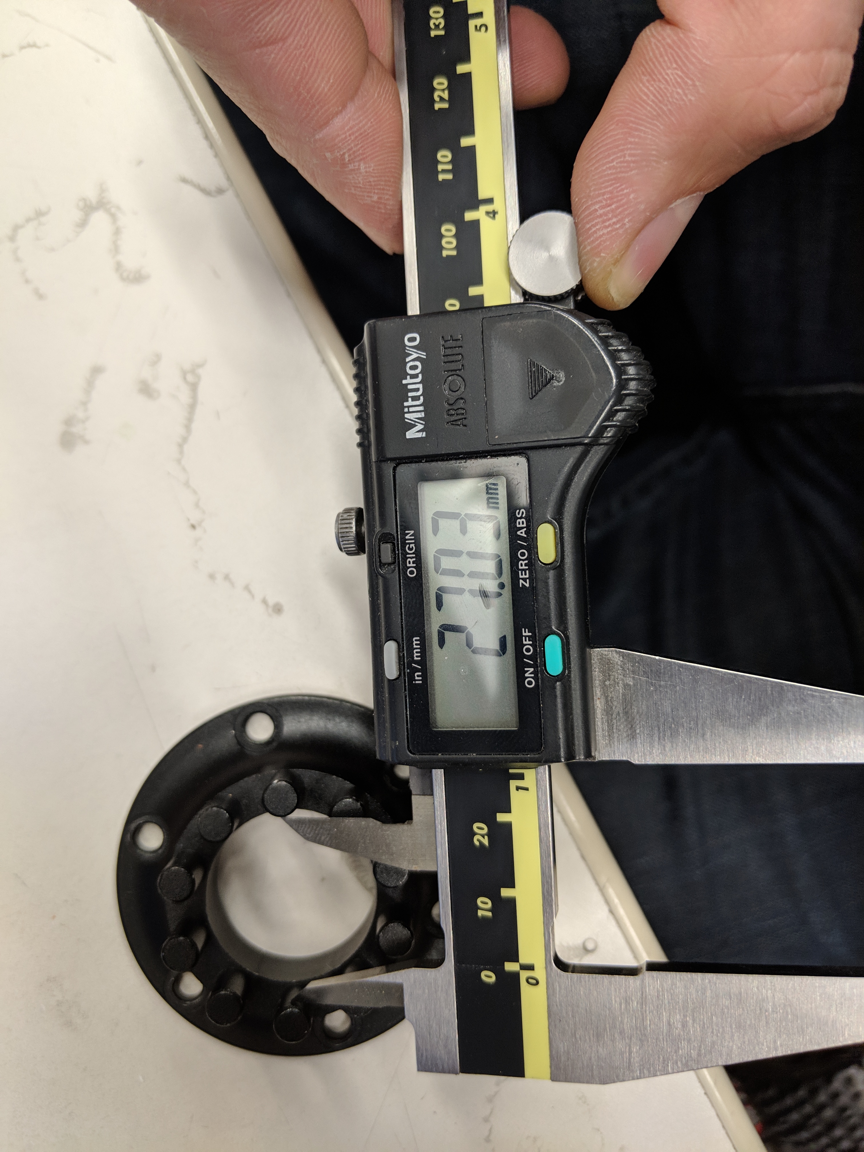

Since you said it didn’t work for you, I printed 2 test pieces(hole dia 5.7 and 5.9) and they fitted exactly as they should with 5.7 having no play at all. Hmm, maybe it’s the printer’s fault.
I did the same but with POM. Metal to metal fitting require high tolerance. +/- 0.01mm would result in either too small or too much play for my liking.
5.6mm to 5.9mm would work for POM, press-fit to drop-fit.
