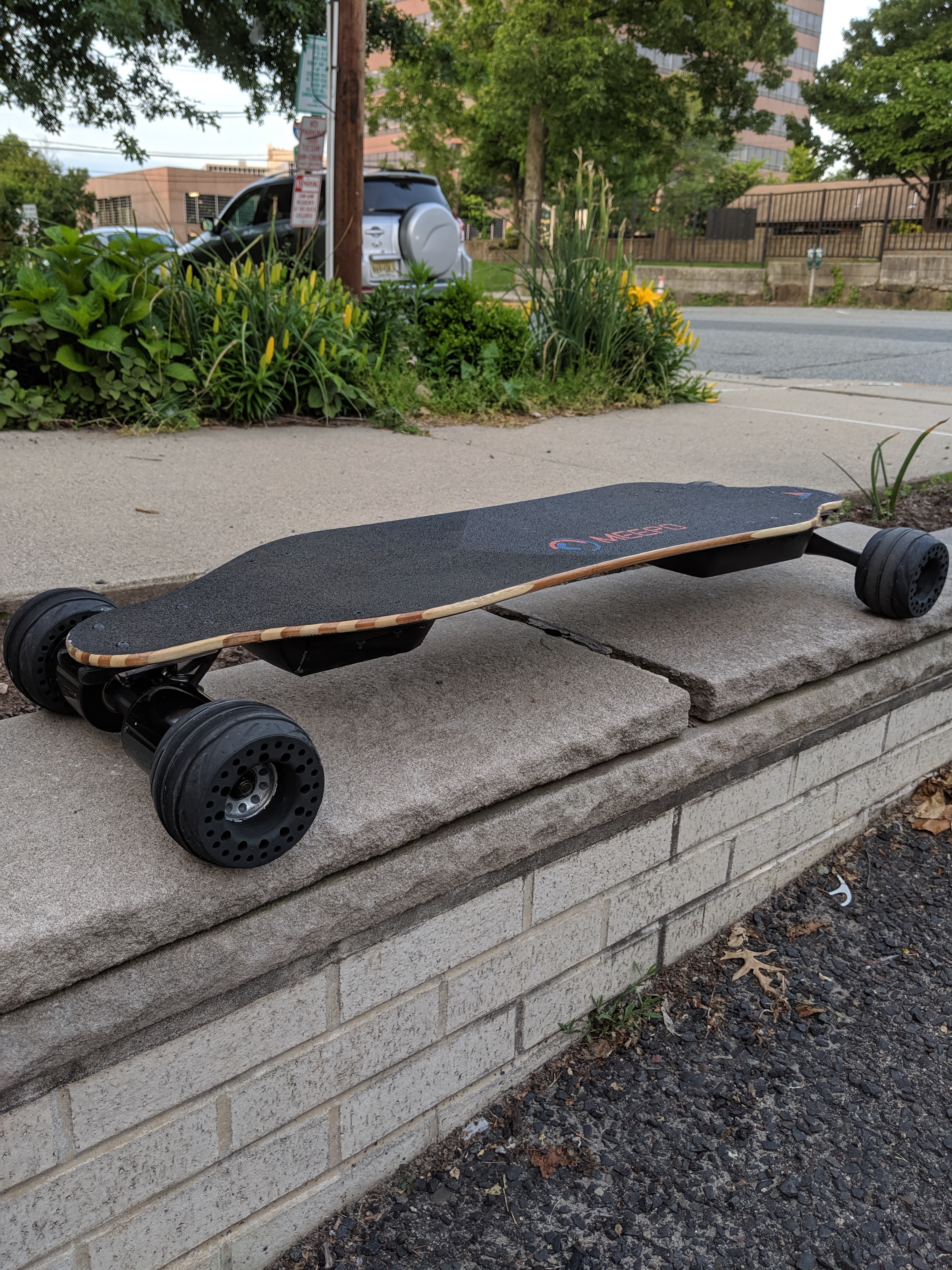

Heres my elofty DD that replaced my meepo nls hub motors and unity as the brain.
Settings so far on Sanyo 10s2p
20/-12
55/-50
Feels faster and climbs better than a boosted board which is what I was after so loving it.
Also just got the 105mm tires

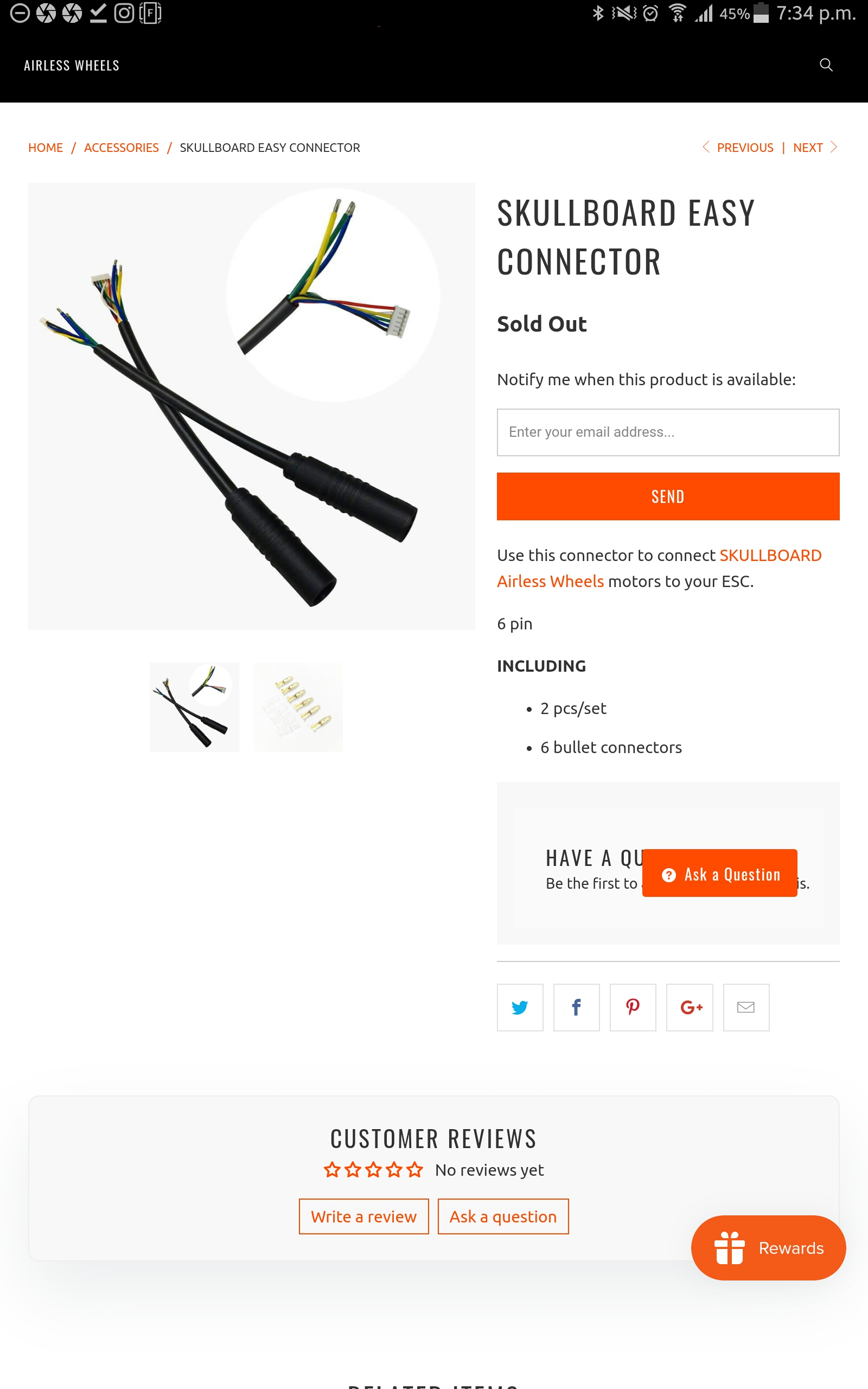

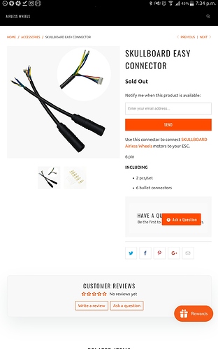

Don’t see the motor wire adapters listed anywhere on Lofty’s store, did you guys ask for them explicitly through email?
If you’re talking about these:
They have been phased out in favor of MR-type connector.

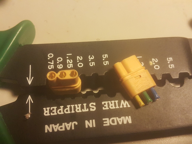

Can someone post a photo of current gen connector?

wow, where does one even buy a connector like this?
写真をありがとうございました。
Hope that helps. Maybe Amazon has them too. Amass MR30
