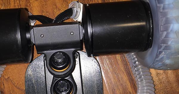

it was on the REPLACEMENT motor that the endcap unscrewed from the can!
and I cautioned you when you were at the factory that this was an issue… so far I’m counting 4 motors that this has occurred
Usually I can see loc tite but in this case the can did not appear to have any.
same as mine… zero locktite used during factory assembly

Wait, so all the rotational resistance for the wheel is dependent on the can not unscrewing? No wonder it’s only happening on one side.
apparently!
that has been my findings, also seems to be related with how tight the hangar bearing is secured in to the can end-cap.
If the bearing is locked down good and tight, the end cap has to stay on. If the bearing is loosely installed into the end cap, it can rotate (or better stated, resist rotation and unscrew from the can, during acceleration)

Could you guys drill and tap the cans for socket screws?
If this is possible, I would absolutely suggest that.
I considered that actually, but adding high-strength, high-temp epoxy to the threads was considerably easier.
this what I told Nathan when he asked for my solution…
Though a bit more involved than I would like from a consumer standpoint, swapping and curing then repeating in the other direction has merit.
yeah I agree, and even tho this is a DIY site, I bought these drives under the assumption, and based on the success of the early version drives, as a bolt-on and use solution. I didn’t realize how much time and effort was involved in keeping these drives alive.
The motor swap idea came to me when I was trying to figure out how to adequately tighten and seat the end-cap on the can, however, I 3d printed a tool and used that to tighten it all up. If you’re a back-yard mechanic or a hack, a strap wrench and a pipe wrench would work, but the cans would be awfully ugly when you’re finished. The epoxy threads and swap drive sides is labor intensive, but not all that difficult, and would require no additional tooling.
