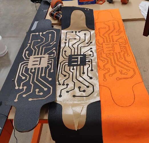

Now fast forward another 6 months later, I still had the original grip tape from when I bought the deck. It was time to make something custom that completed the look.
So I started with a paper and pencil which ended up in CAD as usual.
After some zaps on a laser cutter with black and orange grip tape, the idea was materializing:
The ET logo in the middle looked a bit clunky and I don’t claim to be any sort of graphics designer, but I thought it turned out pretty good overall and completed the look of the board.
