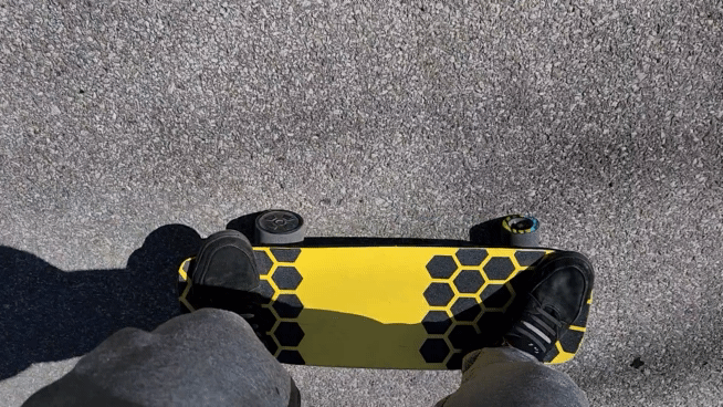

I was searching for motor mounts for these trucks but didnt find any.
Also researched about Hub motors, but mostly found motors with an axle coming out and the wires in the middle of the axle. Or motors with a square shaped port, which need to be an exact fit.
grafik
Then I found the drivetrain kit from Loaded called “Ultimate”.
The hub motors they use work with round-shaped hangers like the “Paris” trucks.
A conical shaped spacer sits between the axle and the motor.
This spacer then gets pressed against the axle when tighting the wheel nut.
So its quite universal principe for all hanger types.
For the “Hamboard” Trucks, there is just a minor file job to do and the motors fit perfectly.
If you are interested in this exotic and unusual esk8 ride, here is my video about the full process:
After doing my first test ride, I can add the following:
  • The “Ultimate” drivetrain kit is quite smooth and powerful. Fair enough for this setup. 42 kmh reached.
  • The “Hamboard” Trucks are so much fun, especially on low speed, the tight turn with much lean add a unique feeling to the ride.
  • At higher speeds 25kmh+, you need attention and focus to your feet. any wrong movement can lead to crazy turns.
  • Carving also needs more attention but feels supercool. strong kick.
  • The complete board is very lightweight and handy.
So if you are also searching for the perfect wave, you may give this a try :call_me_hand: :surfing_man:
