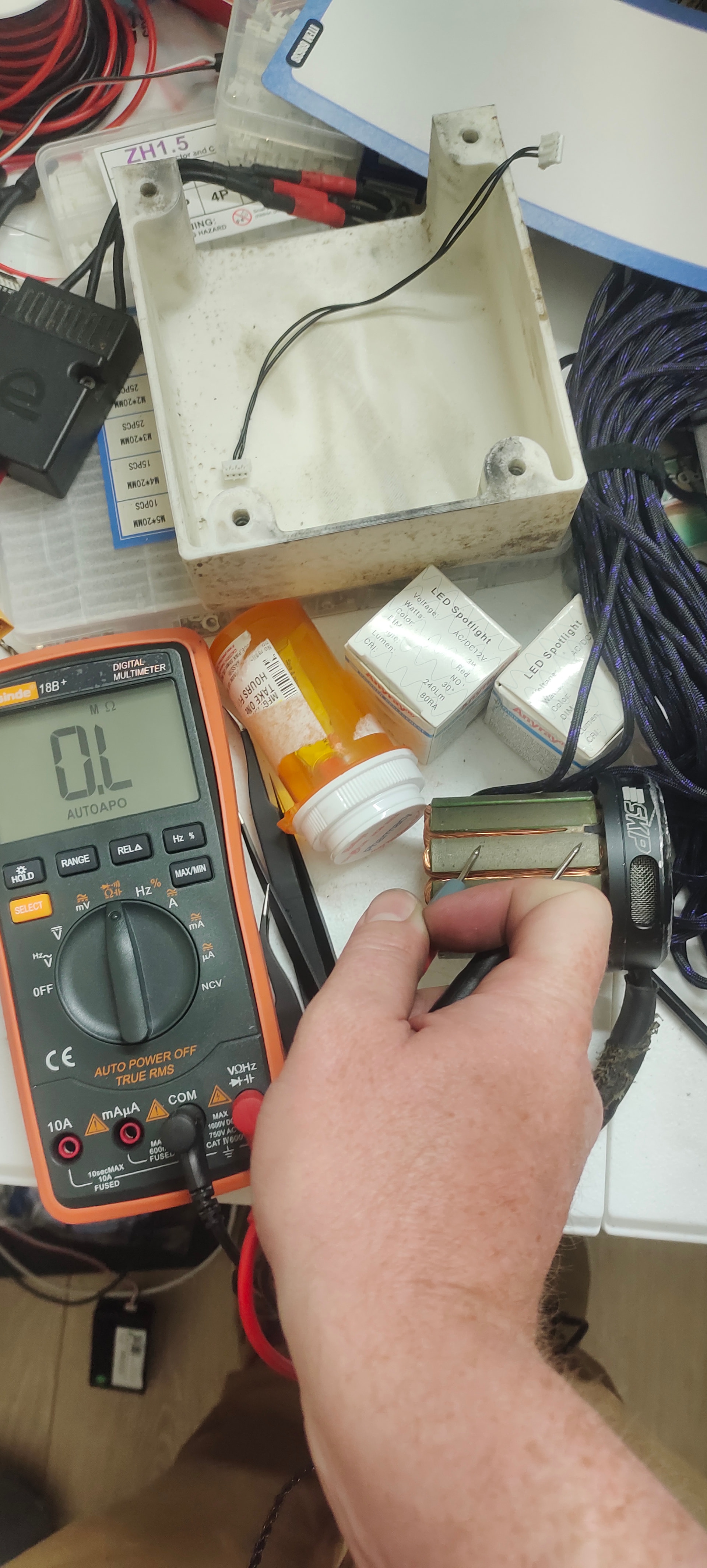

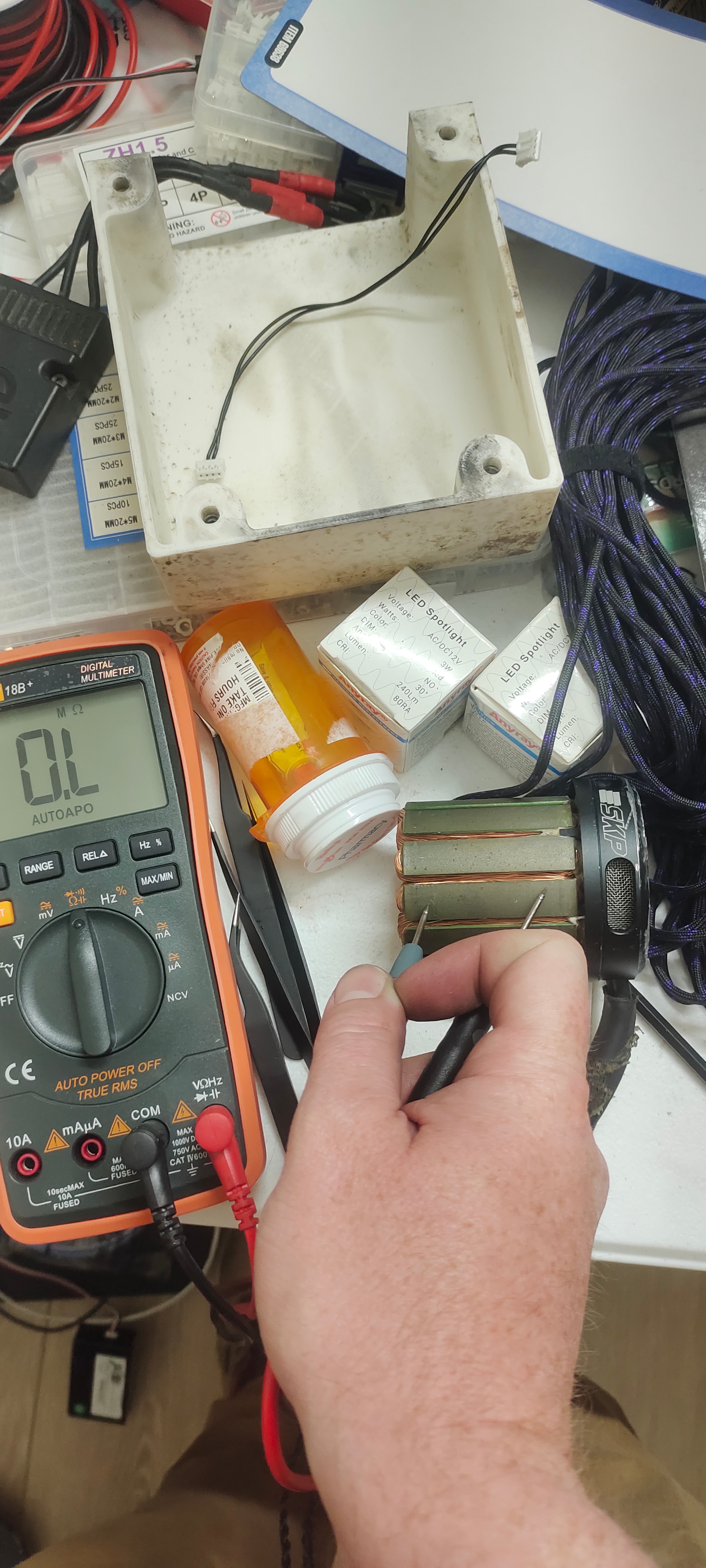

How much electrical resistance does it show from one side of the stator to the other on same tooth?
It’s hard to get a solid reading but hoping some people post what motor they have and what resistance it shows. Why manufacturers go through the trouble of making laminations but then don’t insulate them well from each other, I don’t know

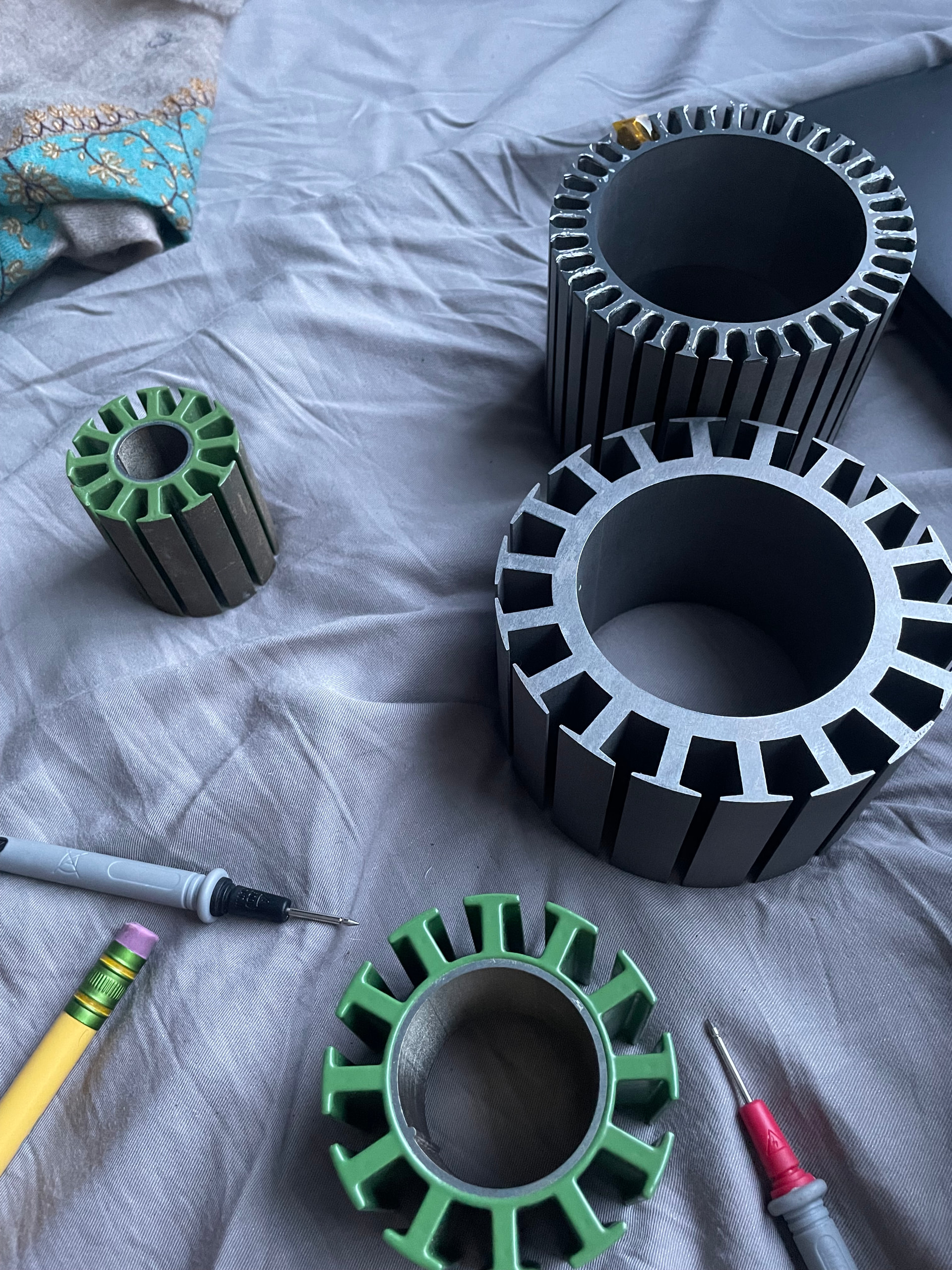

All the stators I have of various sizes and 50-60mm tall show between .2 and .8 ohms. I’m trying to find out if this horrendously low resistance is typical.
The low resistance of the stator results in eddy currents and heating from high frequency. It seems these motos we use aren’t nearly as insulated as ones made for industrial use
