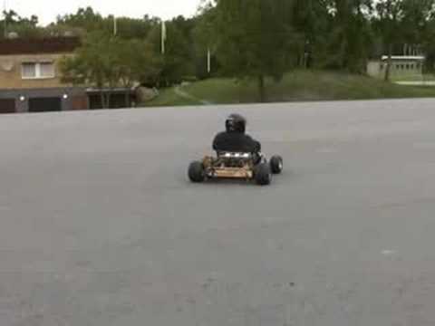

For motors, you’ll definitely want large, not sure how large as it depends on the size of the kart - Alien Power Systems makes some pretty large stuff. In this old video, the person used a clutch mechanism to avoid burning out the motor and controller. Something like that is recommended, esp. at the weight over a skateboard.

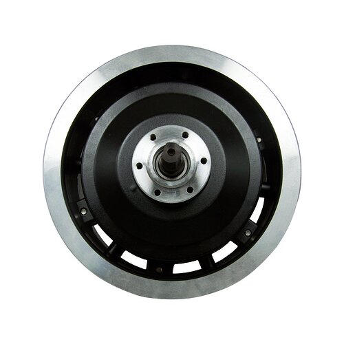

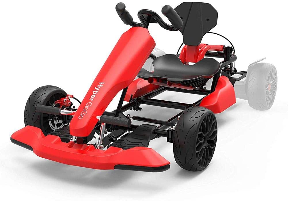

Use this
With some light fabrication to get these
To work with the hoverboard go kart thing with a big ol battery.
Seems like it would be a fun and cheap go kart build
