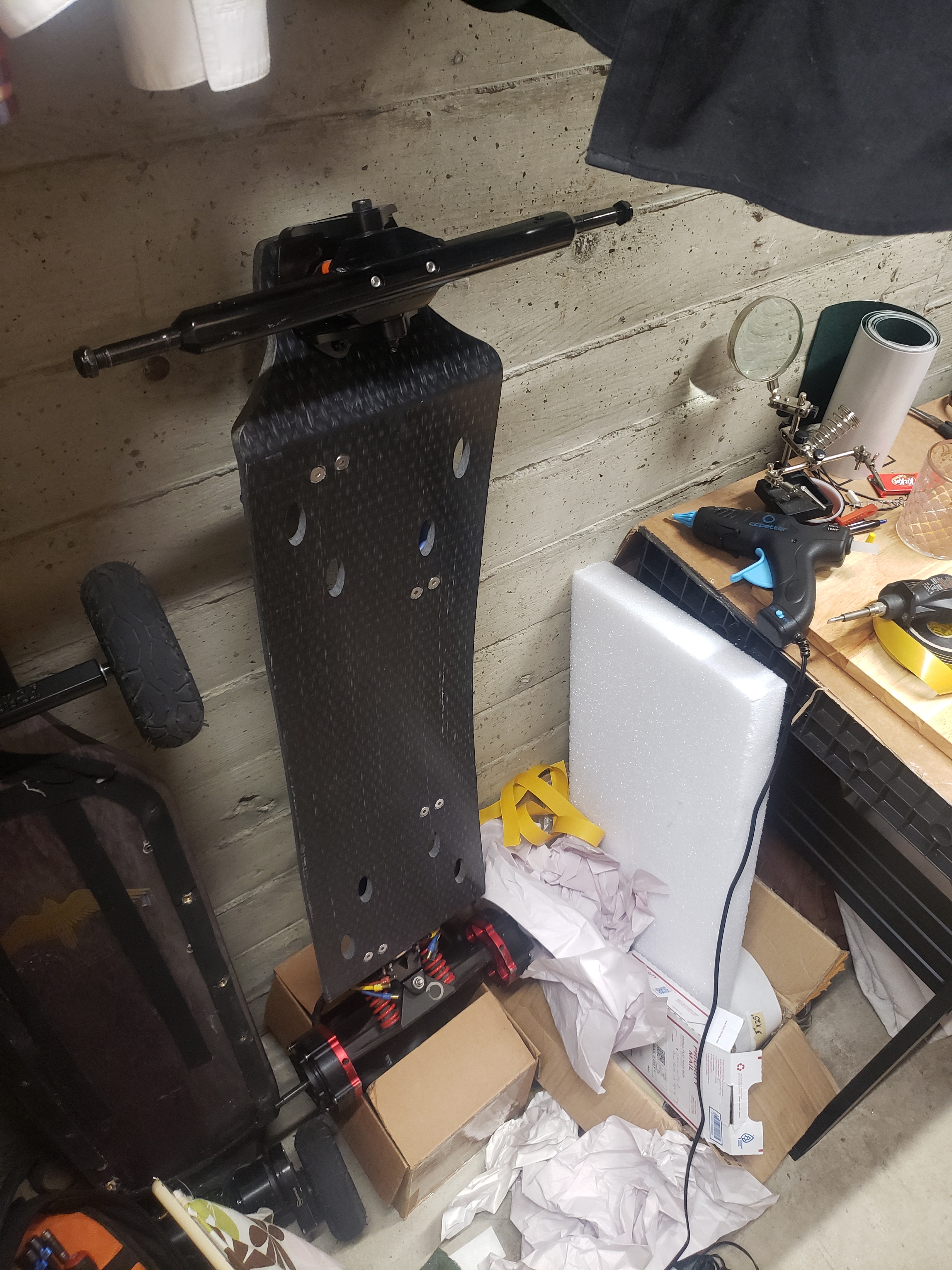

As I am receiving the TD deck with cutout soon enough, and it’s pretty much the same as the hummie deck, and planning my 12s8p 50e double stack, would like to know if everything would fit inside.
The GT40 enclosure is single stack, no option for a DS for 12s8p at the moment
Understood, but there is a cutout inside the enclosure which is 13mm deep. Double stack 21700 is roughly 44mm, minus the cutout, the enclosure would need to be 29mm of height minimum.
If I use a rubber gasket around of 10mm, the height would need to be 19mm.
Would that fit then ?

I dont think so, the SS enclosure will fit a 21700 will little room with a 2mm rubber gasket, if you add 13mm of the cutout you will need to add another 8mm of rubber gasket, that might not look/work good.

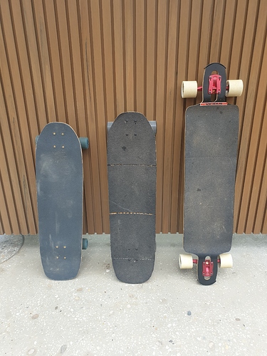

This is the Titan Project X Flex V3 Prototype deck, just to prevent confusions.
The Redember 44" seems to be similar sized and shaped. Maybe you can give a small compare review/first impressions of these two gorgeous pieces of art :slight_smile:
