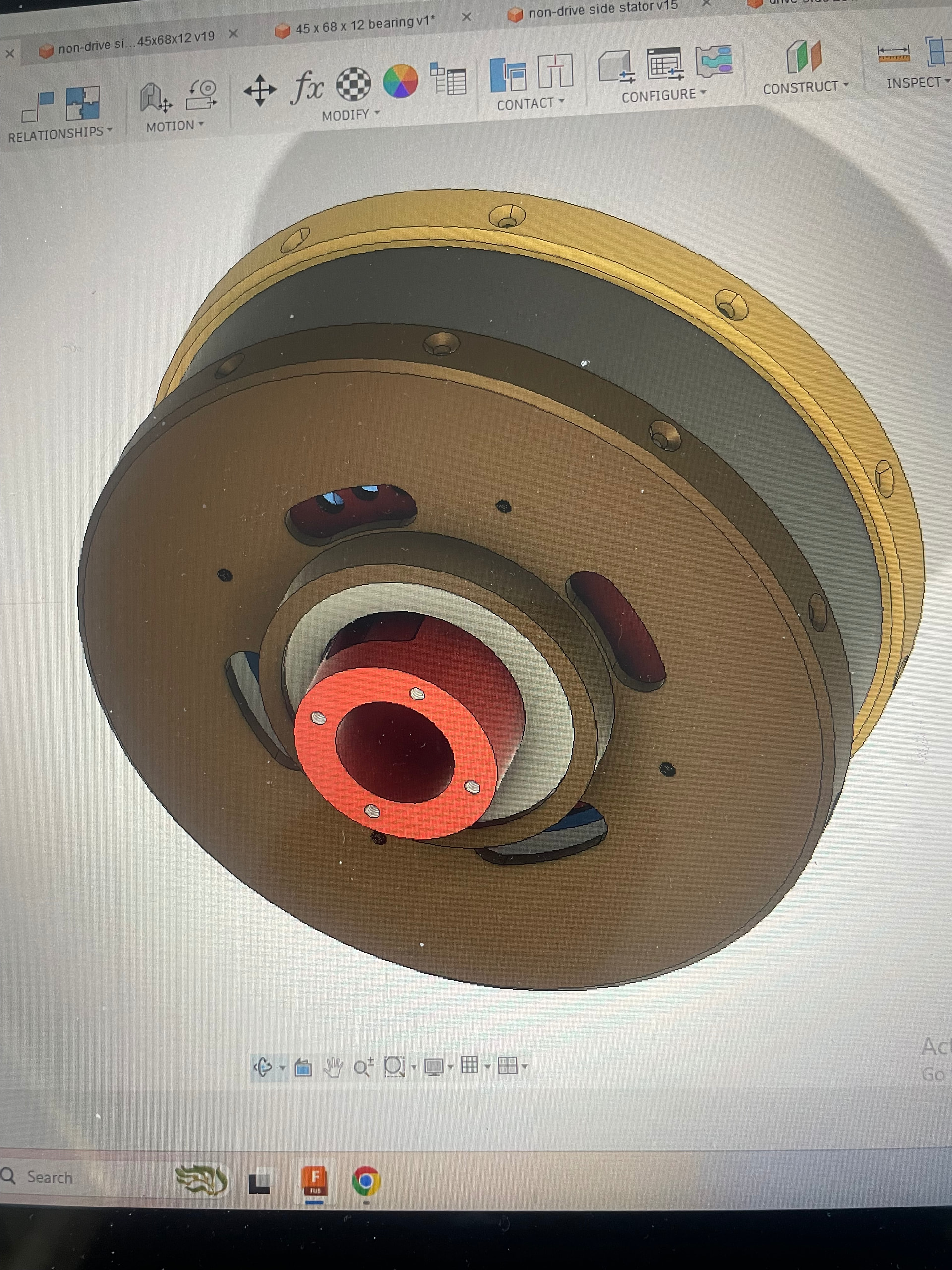

Can you post link to the motor? How does it look from the other side?
The motor side I posted is both the air inlet (hollow shaft) and the outlet (the four kidney shapes). I haven’t added a fan design yet but figured those four kidney slots would be a good more central area for the fan to work with. The goal is to pull in the shaft, into the motor, and across the airgap, and back out the same side
It’s a hub motor design with a fixed shaft.

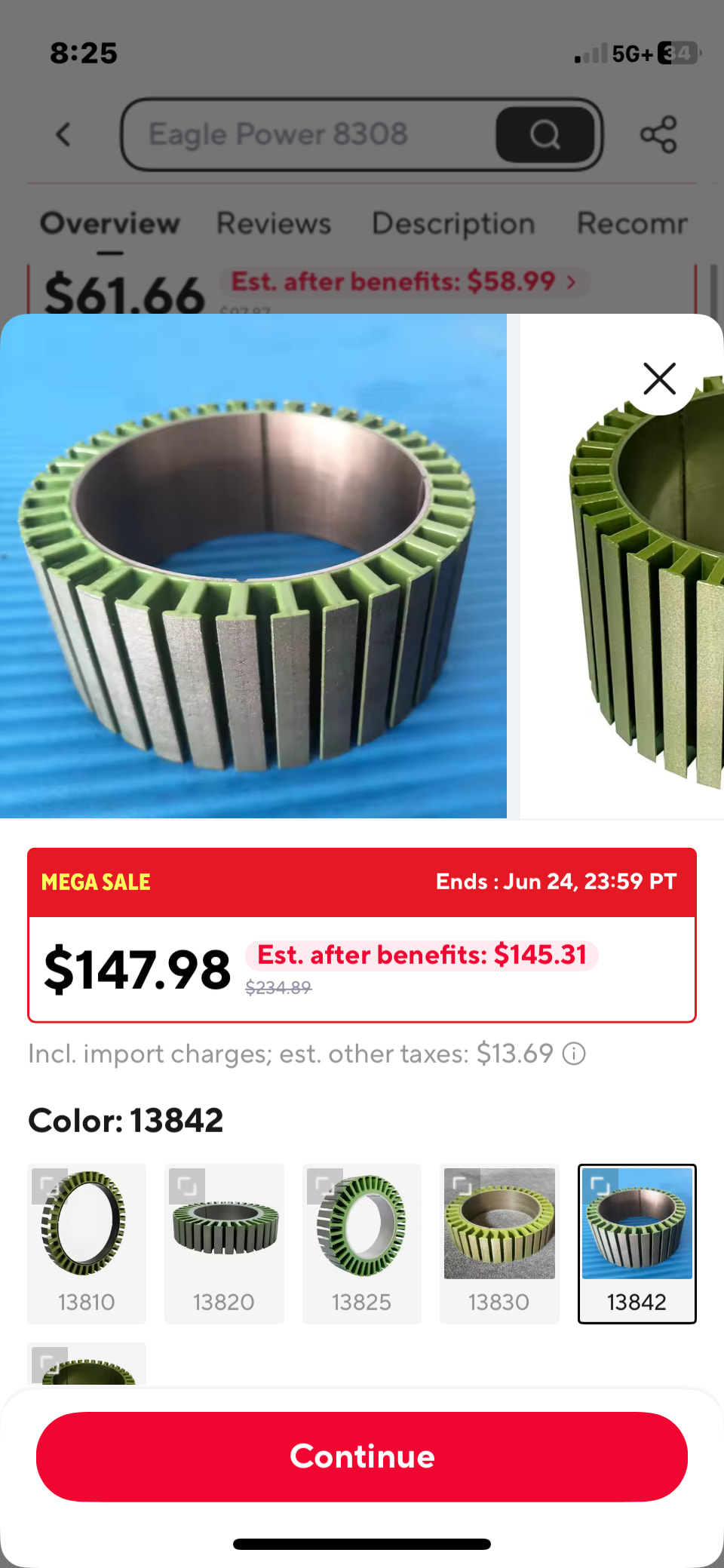

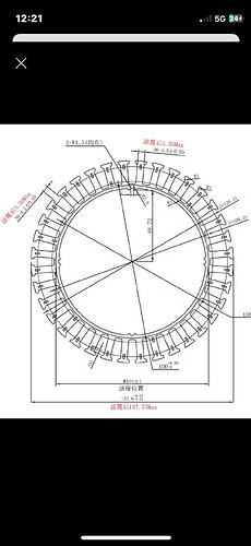

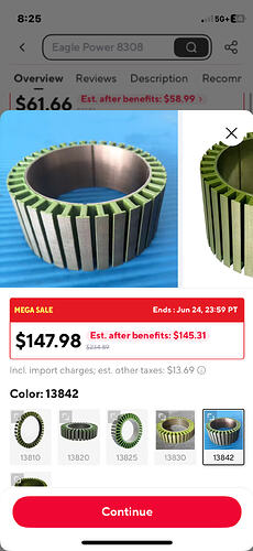

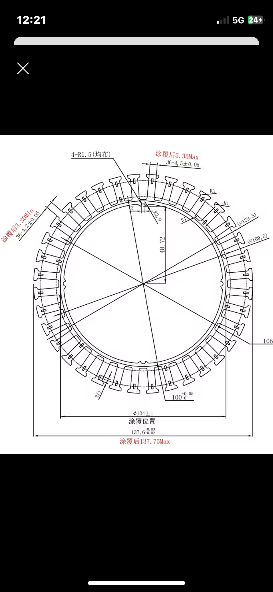

I’m using this 138x42mm stator
