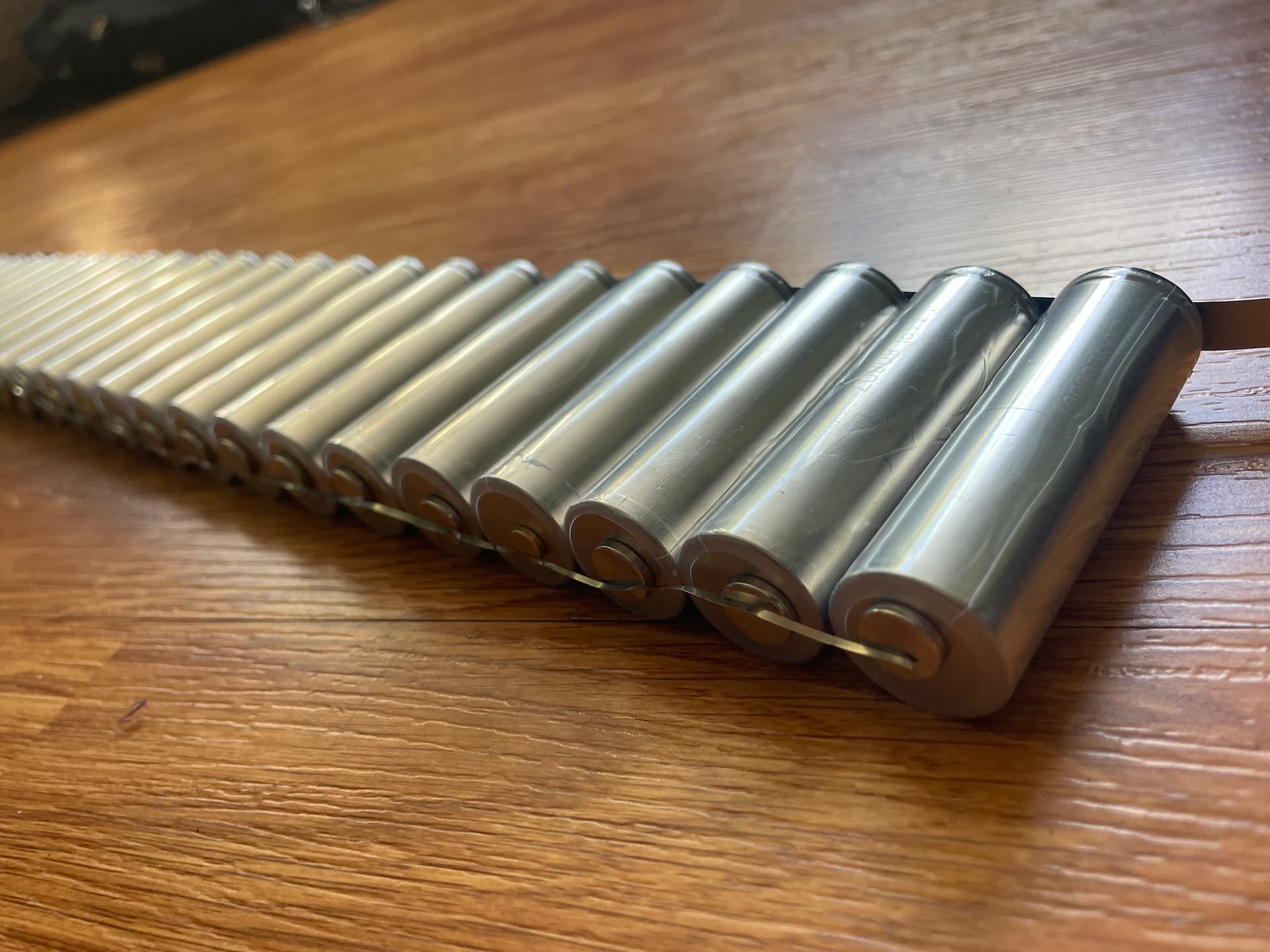

I’ve got (120) 21700 cells I need to somehow balance to a certain degree before ok to connect the bms. Im looking for a quick and simple way to put them all in parallel and then can connect to my power supply, and also wondering what voltage spread is acceptable to have between groups when connecting a bms

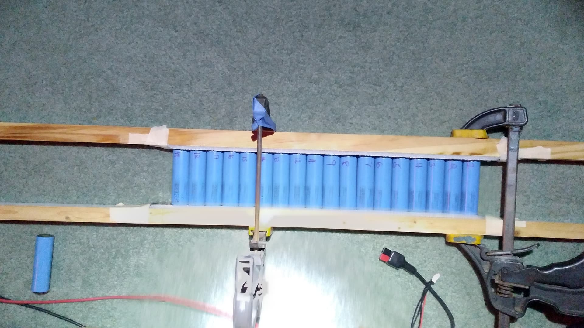

My plan so far is to connect as many in parallel as I can with magnets and steel strip that’s showing today.
You can make it easier by using copper strips and magnets instead of trying to connect each cell individually. Line up two long copper strips one for the positives and one for the negatives. Place your cells in a row with all positives touching one strip and all negatives touching the other. Then use neodymium magnets on top of each cell to press the strip down firmly and make contact.
This will quickly put all the cells in parallel and allow them to balance with each other. Just make sure the voltage spread between cells is small (ideally under 0.05–0.1V difference) before connecting, so the equalizing current isn’t too high. The thicker the copper strip, the better.

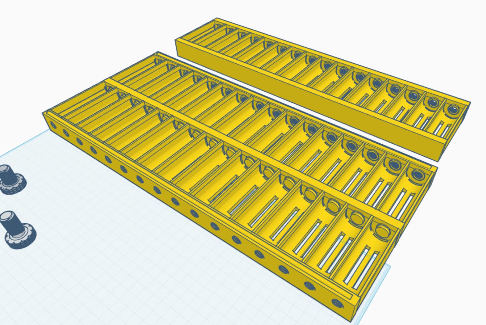

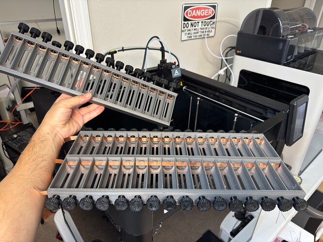

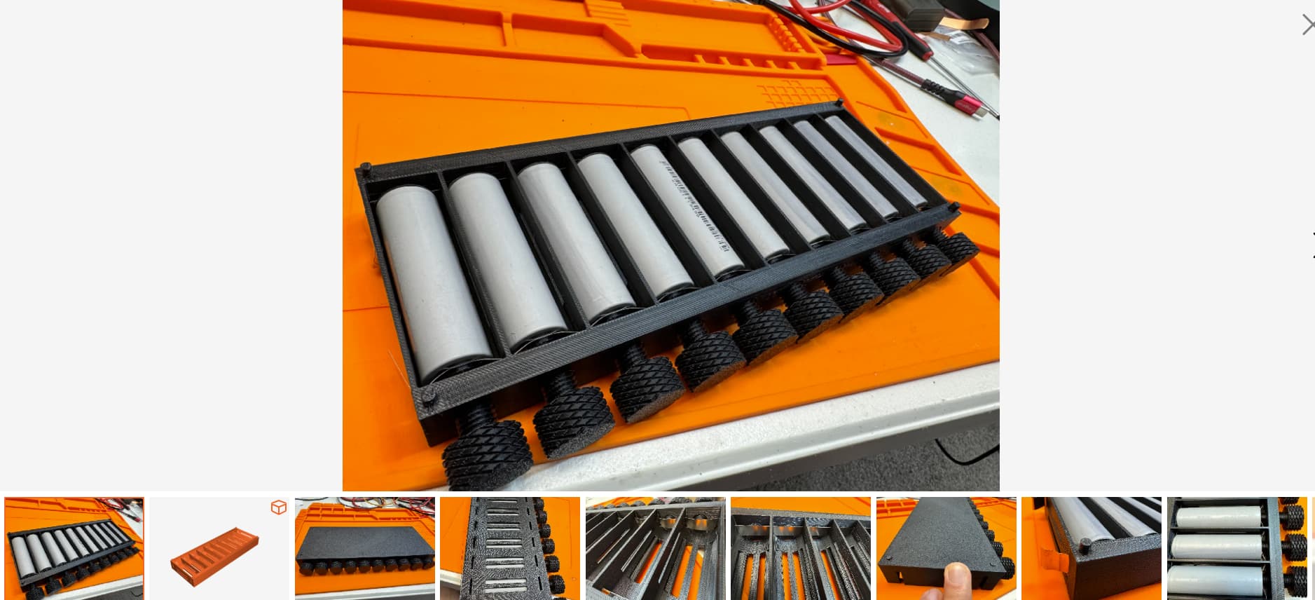

Also as alternative you can print this model for 3D printer that you can do from 10 at the time. The model is stackable and does not require welding. You need to insert the strip on the slots.
Yea doing two strips of steel n magnets was my plan. I guess that’s the easiest way.
If the p-groups have a .1v variation it’s ok I guess
Make sure you connect the positive in one side and the negative from the power supply in the other side to make sure sync well.
Probably 60 on each side
I made 2 large variants.

That perfectly works and is very easy to do.

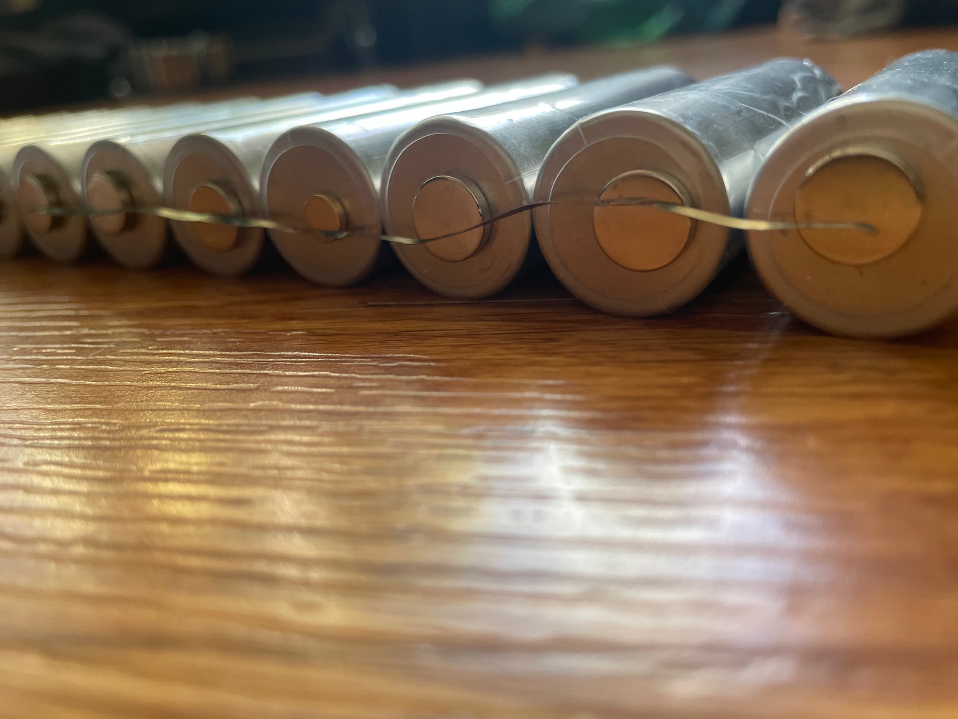

Some closed cell foam insulation pushing a 0.1mm nickel plated steel strip against the fishpaper rings and cans.
If I had 36 magnets I would have used them, but this was pretty easy too.
These lightly used 50E’s were all within 20mv of each other, and have not budged for a few weeks, so this was unnecessary.

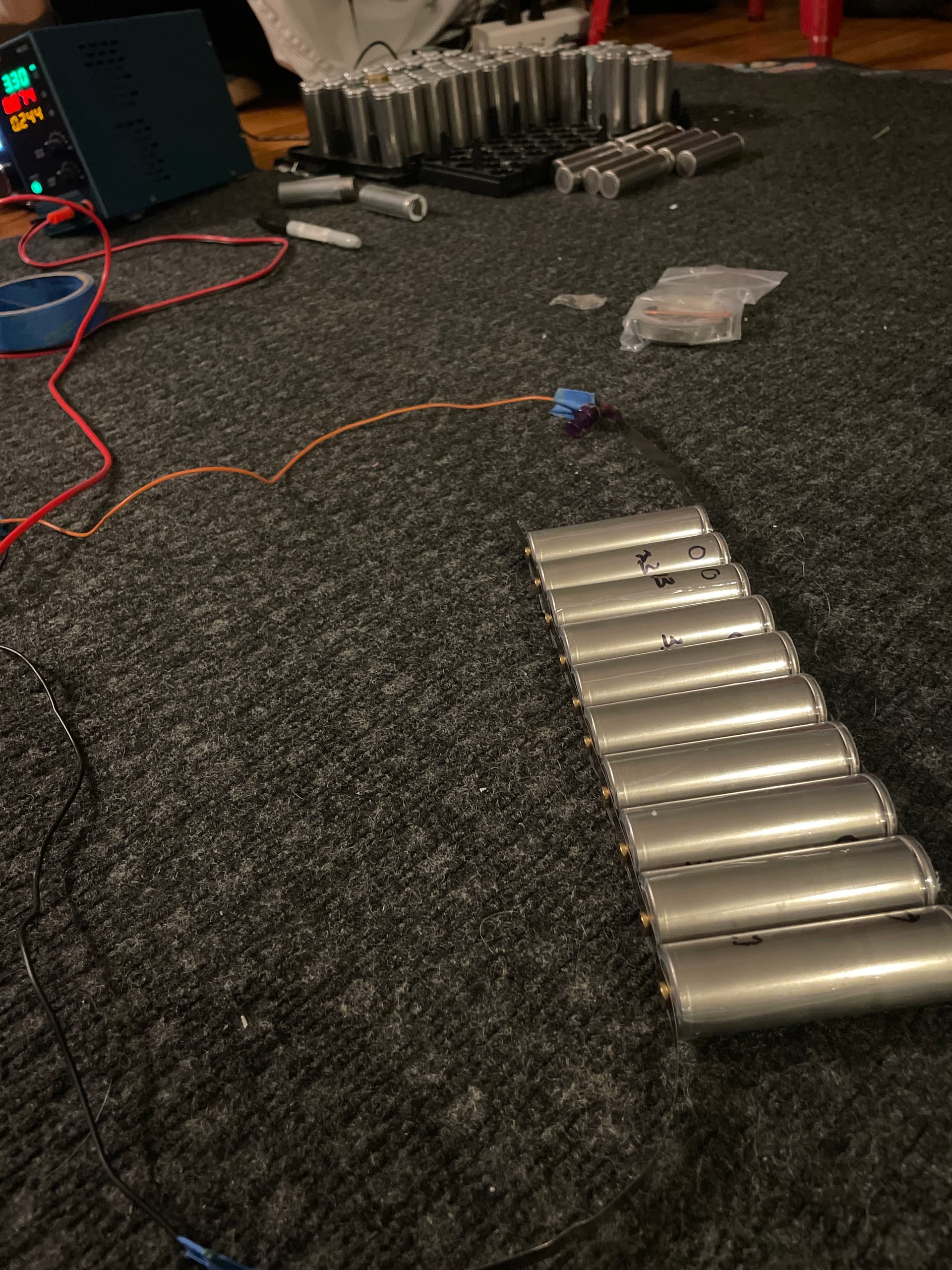

In my case of the 18 Samsung 50E’s, none are going in an esk8.
6 will be dedicated for 6s1p to power my TS101 soldering iron, I was considering just forgoing a bms entirely, or a BMS that balances, but did order one which supposedly does.
12 will be for a 3s4p, and I have a 40 amp BMS for it which supposedly does balance, but I don’t trust that it will, So I’d like to start with them as close as possible.
I was going to balance them all to 0.1mV and see which ones drifted, and then deicide which to choose to place into P groups and which to choose for the 3s4P and the 6s1P.
When I put the voltmeter on them before tightening the clamps I saw none had really changed at all since I first got them, and I didn’t really need to do any of this, but oh well.
I like this method w a sliver of nickel n magnets. The thin nickel adding resistance and a fuse. I put a bunch together spread from 3.1 to 3.5 and the sliver was not noticeably warmer.
