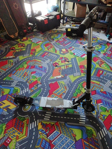

Got it running but its still missing a nice enclosure. My beloved didn’t like the feel of it, she said it feels insecure so now I’ll use it at work. Have to bring it there after the Corona shutdown :slight_smile: I actually like it, its a fun thing but not good for longer trips :smiley: The hub motor had surprisingly good torque at 8s and 15A.
Wow, thats a lightweight one !! Nice slim and slick DIY :+1:
8s, 15A with VESC ? You need a buildlog too :stuck_out_tongue: want to know more !
