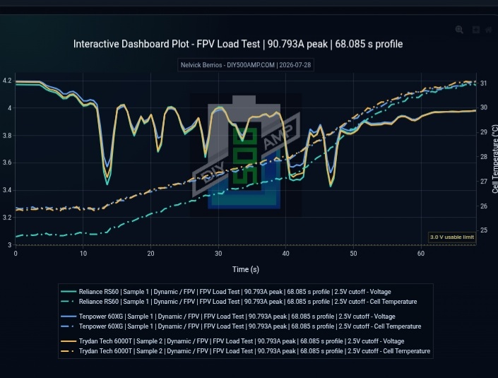

Nelvick @DIY500AMP.COM has a pretty sweet set up for Testing cells, and just recently has uploaded data logs from a FPV flight with dynamic loads as high as 90 amps.
It is data from a FPV drone with what I think is a 6s1P battery, maybe Tenpower 50Xg cells.
Here is the data regarding how the 3 preproduction Sample cells he has applied these dynamic loads to performed.
I find it interesting how the Tenpower 60XG sags the least, but then recovers a bit slower than the Reliance RS60 or the Trydan Tech T6000 ( A newish Indian based battery company)
I know some of you guys have ride logs/ telemetry data, and are really pulling some serious power.
He wants the Data and wants to test not only these Future power/hybrid cells, but existing cells as well, and not just a 97 second FPV drone flights.
He is just getting started with Dynamic load testing and has a passion for this stuff.
I asked him how much Airflow a FPV drone has around the battery, and it seems there is a good amount.
So Data from a powerful esk8 pushing a compact insulated enclosed battery hard, would yield an interesting comparison, and perhaps help us all choose the best cells for our specific needs going forward, and perhaps help explain why @Pecos and @MichaelWA P45b packs woefully underperformed, range wise.

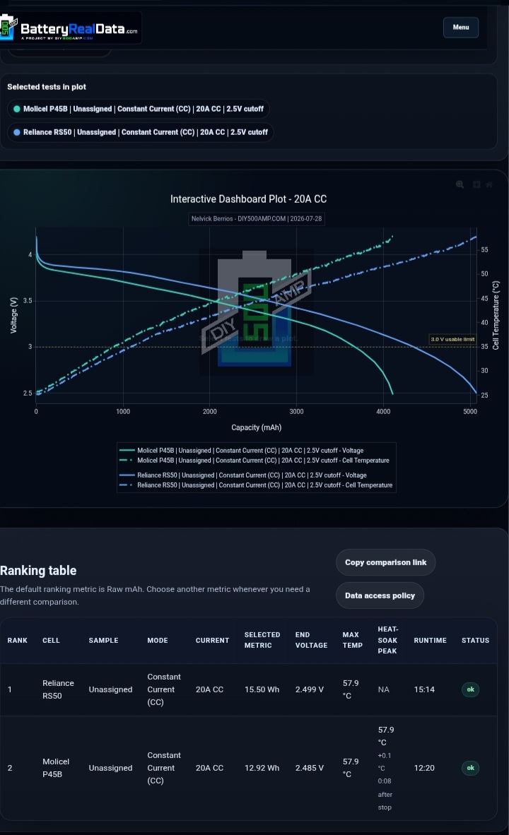

P45b underpeforming was unexpected, we didn’t know it was that bad. @Pecos ride pretty conservative and his range was pretty far off from his calculations, and he was being plenty generous with it already. For me it was pretty bad. :joy:
RS50 vs P45B
Selected metric is wh down to 3.0v.
Anybody hammering a 1p or a 2p pack and have a ride log?
So at 20A continuous with P45b you’re down to about 4.1ah usuable capacity. Real world pack shown to be quite a bit lower than that. We got the math down to like 3.7-3.8ah usuable capacity.
