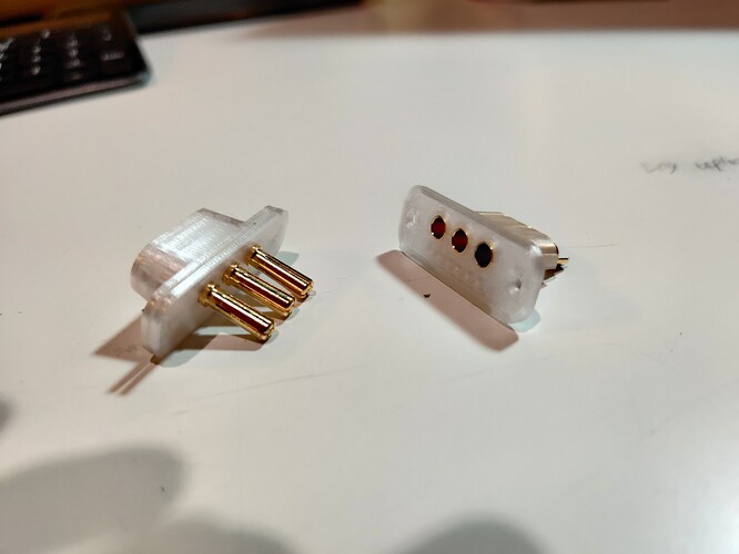

Ok, new rev on the panel mount. Printed in clear PETG. The pins are just pressed in for now, don’t think im gonna mount these. Need another rev.
Thoughts on the wire shroud? I was thinking of how to make a clip on one like Amass connectors, but then I thought it would just be easier to bolt it all together since it’s getting bolted through the enclosure anyway :man_shrugging:
ugh, those 90 degree angles
I think that in this use case, a non-panel mount MR69 epoxied into the enclosure at the correct angle is going to work better for you.
Due to the way that I am leaning for production of these connectors, I dont see how I could easily make an angled panel mount. Plus, there isnt one angle that will work with every enclosure.
I want to keep the first batch of these fairly simple, so I think just panel mount and standard will cover the most bases with the least number of SKU’s.
