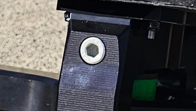

Heyo Dualities hivemind, is this bolt here red or blue loctite? Also does it matter which direction to insert the bolt?
There is a Nord-lock washer that keeps everything together, no thread locker needed. You shouldn’t really remove that unless you’re flipping the hanger direction.
Do you mean baseplate direction?
On the 5 degree baseplate (single removable pivot arm) it matters. On the 0 degree baseplate (two removable pivot arms) it doesn’t matter
Nevermind, I’ll just put it back together exactly how I got it. Do you have to remove that bolt to change the bushings?
afaik you should be able to pull out the queen pin to change bushings?
In order to remove the board side bushing it does require removal of the truck from the board (unless you have access to queen pin from the top). Remove roadside bushing, loosen set screw, remove queen pin from bottom, replace board side bushing and reassemble. Board side bushings slide out without removing pivot arm.
