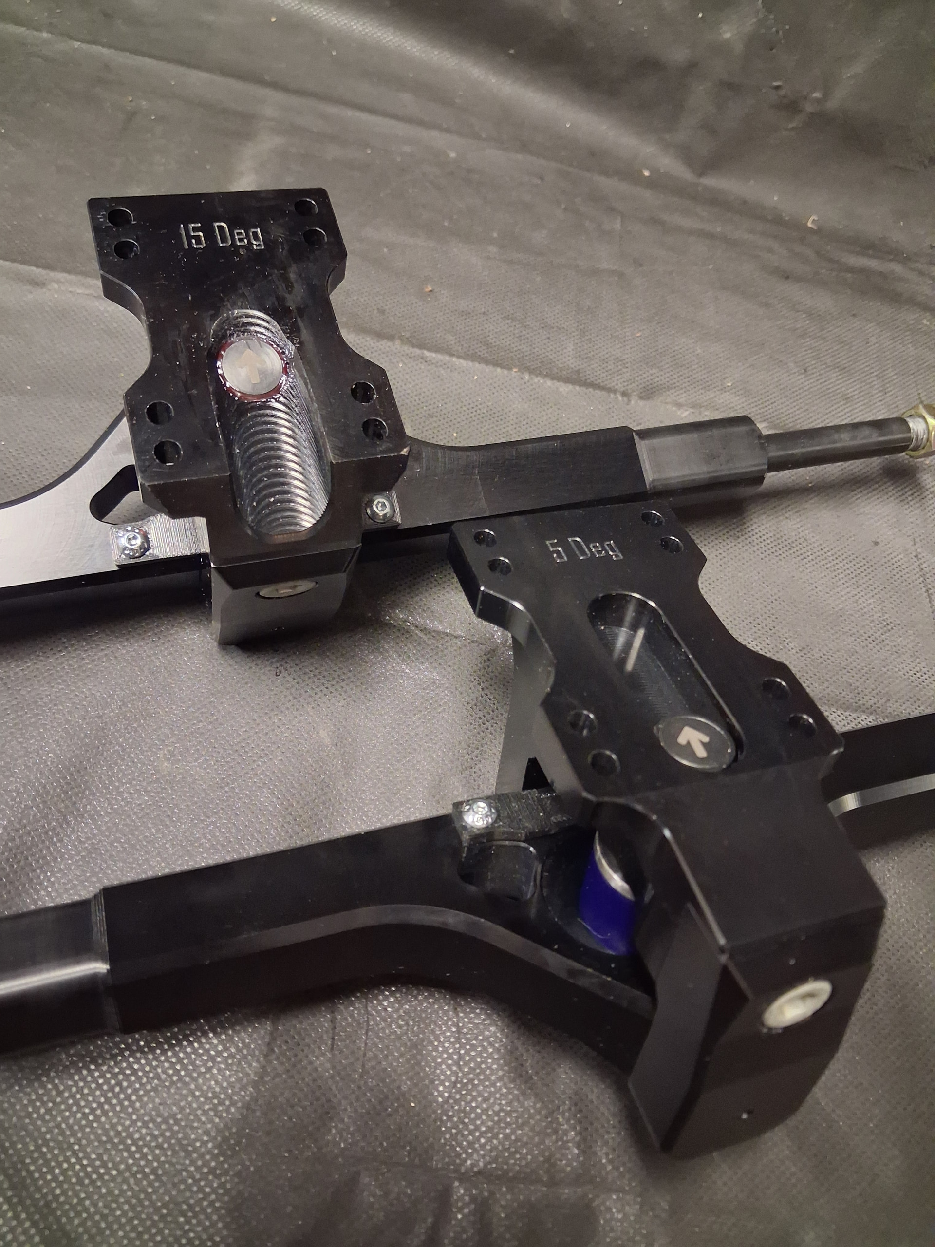

In ‘Assembly 101’ don’t forget to mention that the arrows point to the center of the board. I’ve seen more than a few posts where folks have both arrows pointing forward and thus the front trucks are installed the wrong way (as I copied, did, and got wrong).
I flipped it around last night, and am going for a ride in about an hour, pretty interested to see (feel?) what difference flipping the front makes.
I’ve also swapped out a blue for red on the rear, so am now running red/red back there - trying to get the board (EVO Mk1) less slack-line floaty at anything over 25mph with the Titos.
Arrows? Can you give us a visual?
Sorry, normally I photograph everything so I can document it, but I thought the trucks would be straightfoward so skipped the photos. Having regrets of this now….
On the face of the truck that mounts to the board there are about 5-6 etched arrows that look like this >>>5>>> They seem to make sense if they are facing the front of the board. (Mostly because the rear trucks have a clear angle to them).
In the middle of the arrows are the ‘5’ and ‘15’ to make it even clearer which are the front and which are the rears.
@thebaldgeek my arrows point away from the guts of the board :thinking:
Yeah my dualities don’t have those arrows lol
Neither of the sets I owned had those either, must be a newer thing
is that the flatspot in the queen pin identifier?
as i read other threads..
Yeah, super confusing what the arrows are about.
Point in, point out, some have arrows, some don’t.
@Titoxd1000 said they don’t point at all, but show where the flat spot is.
Just had second breakfasts and coffee here so going to check my board for the eleventy eighth time to see how many ways I got it wrong.
they should point to the set screw.
