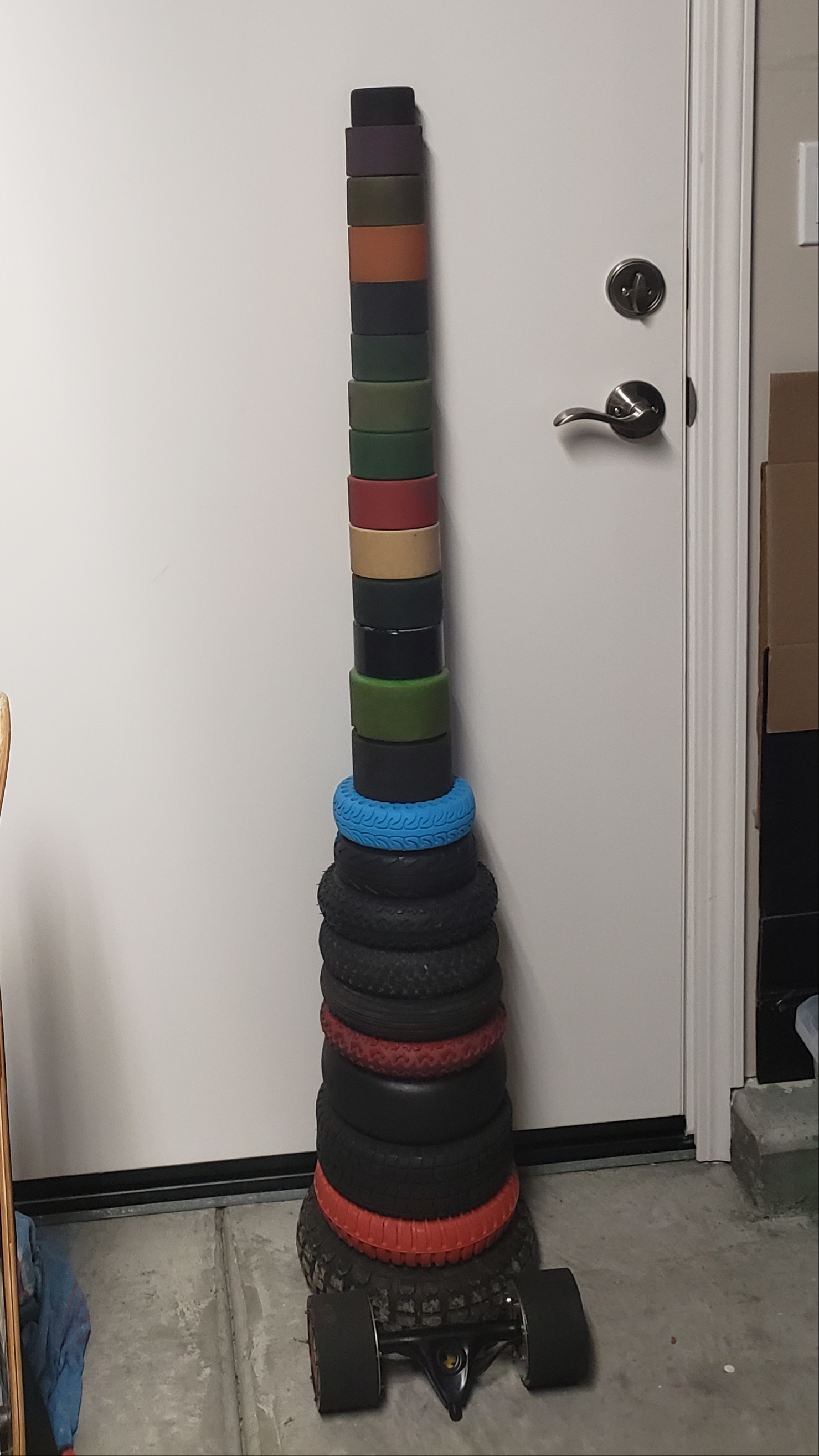

Welcome to esk8, wait until you get a wheel fetish.
If you can return those high KV motors that’s what I would do, send them back, spend a portion of the money on a longer hangar or full precision truck and you’ll be in a better position all round.
Yes a wheel fetish was my introduction to the world of esk8 addiction.
This was a while ago :frowning: it’s worse now.
Did someone say wheel fetish?
That’s just 1 wheel from each set. Doesn’t even include a couple sets of Kegels, Bergs, 110s, 5 stars and more, I’m sure. :grimacing:

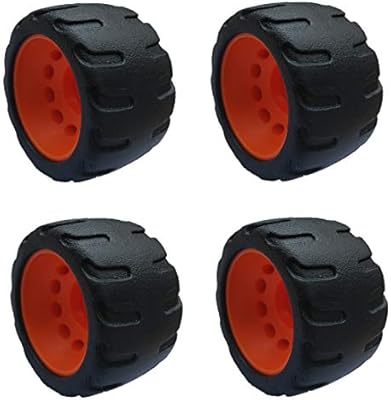

How do you think these ride?
“75A super-high-rebound urethane for unparalleled speed” “Professional wheels”
Skateboard marketing :roll_eyes:
Those look quite odd and for $28 for 4, I doubt quality. 76mm X 45mm seem quite odd for and offroad wheel.
Look like they came off a toy dump truck or something
It’s something you try with the expectation that it is terrible, and to challenge that assumption.
