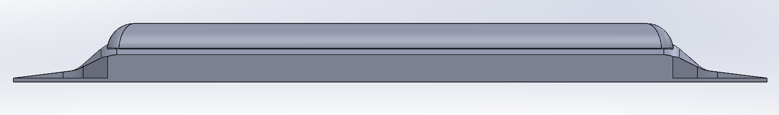

So I have been designing a deck to make out of cf. I was looking into a more classic drop down deck then reading through all of this and the other forum have led me to look into a more Subsonic Century style. Attached is a picture of a possible mold design, though instead of one side up and another down I would have them both be slanted upwards. Any thoughts? I am aware of the challenges of a cf deck in terms of construction. I am asking more about the shape.
In the next few months I hope to develop a double drop made out of composites. The goal would be a complete integration with a top access.
