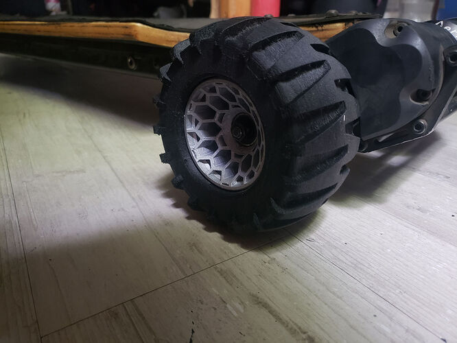

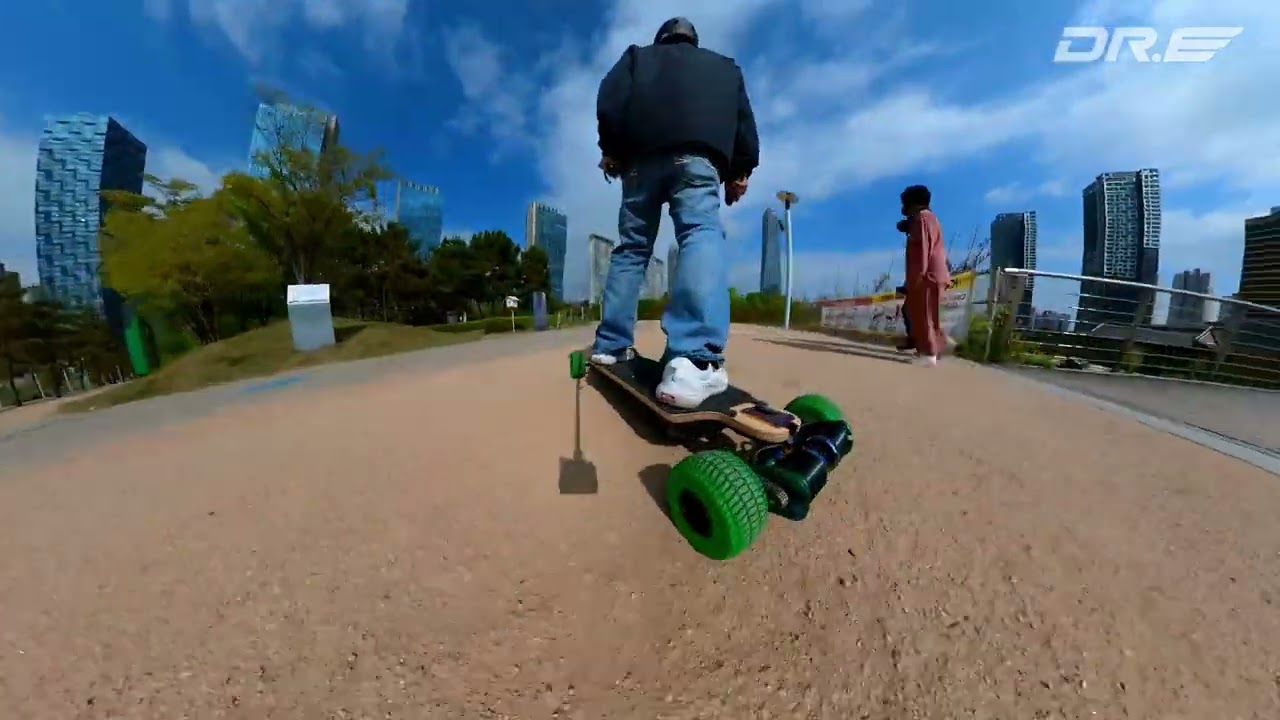

I designed these wheels more for comfortable riding and long commutes, I actually don’t recommend it for racing competitions for example. But that will be for the future. These are wheels are perfect for those of you who want comfortable wheels that can go over bad roads and have great traction on light offroad conditions. I personally need this type of wheel and why I developed it that way.
But I am going to develop wheels eventually using softer material, it will cost a ton more so I wanted to develop wheels with filaments that are affordable such as 95a tpu which is only 27 bucks a kg and much cheaper in bulk.

How difficult would it be to make a version with no tread or just the no sideways tread?
Pretty easy just remove treads in fusion360. Literally 1 second job.
I am watching your video right now. The noise is not too bad. At least people can hear you coming.
Yeah these wheels are loud, I think from the treads.
How’s the braking performance? Do you skid much?
Braking is really good, tiny skid only stopping hard from top speed.

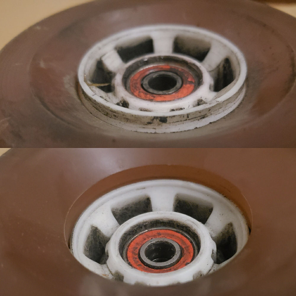

few donuts and 95A TPU tires get hot/soft they pop right outta the cores :point_up_2:
that’s the problem :thinking: HEAT DISSIPATION

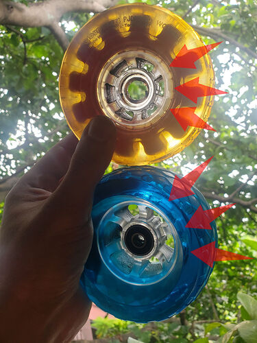

compressing/stretching infill while rolling creates so much heat even rims melt:
Partial infill vs solid :point_up_2:
No choice but use solid ones now:
Massive tires disperse heat preventing melting… even with 83A TPE :point_up_2: like these
but hey, if partial infill tires work on cold/temperate climate regions… Woot, woot :stuck_out_tongue_winking_eye: that’s something already

HAHA, I also don’t brake without powersliding :sunglasses: urethane pops out of the cores but doing it switch pop it back in :sweat_smile:
which is something printed wheels need even professional ones lack sometimes… the spoked core:
Yeah, sometimes superglue is more important than even skate tool :rofl:

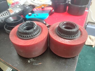

At first I thought you were quoting my post where I melted plastic pulleys. :rofl: Didn’t expect it to be about my old hub motors. The sleeves are still glue together/on but I haven’t used them in a while because bumpy dying hub motors are very uncomfortable.
Melted pulleys look like this btw :rofl:

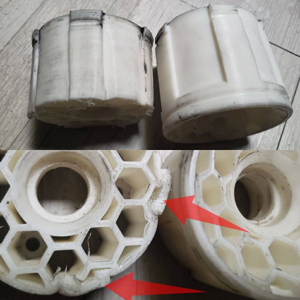

Sorry those are NOT MY wheels, my wheels come with ABS cores and tpu tires and they dont fall apart like those. Please start your own thread for YOUR OWN wheels, instead of putting it here. Thank you so muchy. :wink:

Edit: whats keeping me sleepless all night long is the miracle that you were able to waste the motor Pu that much without breaking the truck and/or motor mounting itself. I can feel the amount of vibration of the board from over here.
No truck can withstand that forces for very long.
