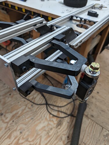

Ok, a bit of forward movement on this, I went away from the rod end bearings to a more robust pivot mechanism
First I setup a heel-toe pivot for the whole board on the bench so I can see how the suspension reacts as I rock it back and forth
Then on to the new A arms
Below is the camber action of the tires which with these flat profile tires would be a blocking problem, but the Mountainboard tires are round profile so might actually be advantageous in terms of wear. Plus hopefully will dig in a bit on turns.

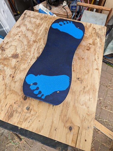

On the upside I did get a friend to cut out some cool Sasquatch feet for the blue deck.
I’m going to install those today and shellac the wood. Probably won’t get it on FS2 today, but hopefully soon.

In other news I did put down my wookie feet on the dyed deck but I don’t particularly like it.
I think I’m going to cut out another deck and cut the feet out of black grip tape next time. I will likely lighten up the dye job on the next deck so the feet pop just a bit more but not as much as they do here.

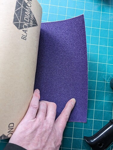

I also realized (duh!) that grip tape comes in colors, so I picked up a few to play around with

Aaand I started making production parts for the independent suspension.
No, I’ve not managed to figure out the exact geometry of the suspension, but I’m getting closer and, honestly, I’m taking a little break from it because I’m waiting for my brain to come up with the perfect solution and it’s taking its time.

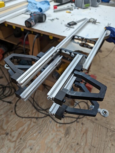

After spending a lot of time and (3D printer filament) playing around with the suspension I came to realize that I needed a little help. I have a friend who is a mechanical genius so I asked him to help under the guise of “learning Fusion” which was on his agenda so it was kind of a win-win.
The first thing he said is that you really need to have longer arms. I’m leaving the final design up to him but I am still trying out different configurations. The latest one is this, with 2040 extruded rail in a vertical/horizontal configuration.
The camber action is a lot more muted which is really good, and the different length of the upper vs. lower A arms seems to enhance that a bit.
I still don’t have a bead on how to get it to turn when you tilt the deck but not turn when the suspension dives or rises.

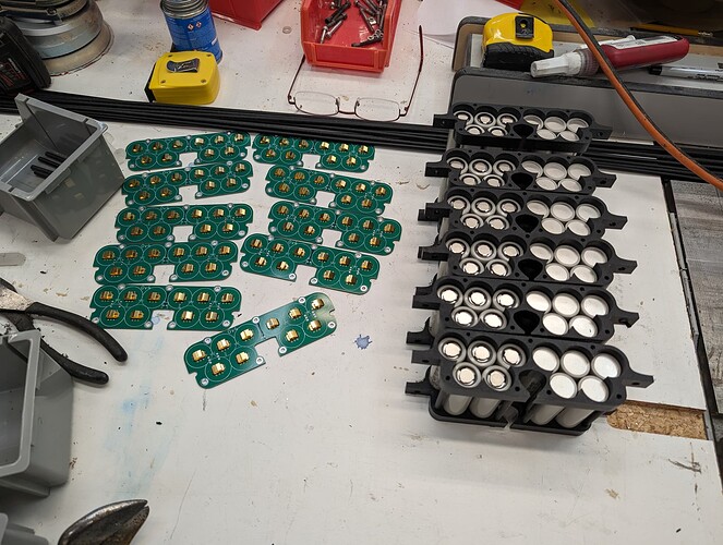

Just for the record, in case anyone else is playing with contact based battery packs, here are the changes I made to the latest run of the PCB’s.
  1. instead of standard 1.6mm FR4 I went to the thicker 2mm to give it more rigidity against the pressure of the spring contacts
  2. I moved the copper fill on the top and bottom out away from the center screw mount. Originally if there was enough vibration I think it would be possible for the metal screw to rub through the solder mask and cause a short circuit across the 2 sides of the board (Yellow)
  3. for whatever weird reason the balance contacts on the earlier board were backwards, where the contact for the positive side was on the negative terminal and vice versa. (Blue) I fixed that.

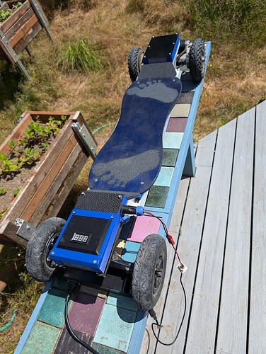

Quick update - I just, basically, wrapped up the eMTB rebuild. It was exactly the same as the F1 rebuild - I ended up touching everything. I know it’s not nearly as interesting a read for me to just say “go up and look at the pictures of the F1 rebuild and that’s also the eMTB rebuild” but here we are.
Here’s a picture of it taking its first charge (outside :slight_smile: )
Note that the panel that will eventually hold the e-Ink display (the only display readable in direct sunlight) currently only holds an old volt meter.
