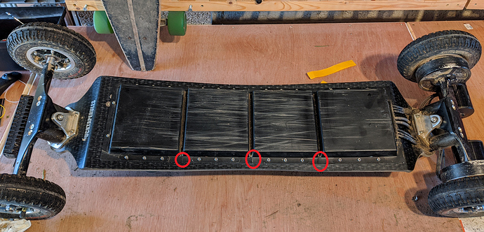

I was wondering, did it crack here too?
Unfortunately it has happened to me, but mine doesn’t look like it has been so much abused haha, you must had done a lot of off roading.
Yes it has cracked slightly but @Kaly said this is to be expected at these flex points. There’s is tape inside to waterproof these points and I’m not that worried about it. I never expected this to be 100% watertight, only splash proof.
In an ideal world it would be IP67 but I’ve yet to find a good bottom mount enclosure solution that achieves this.
I think a fully waterproof top mount board is in my future.

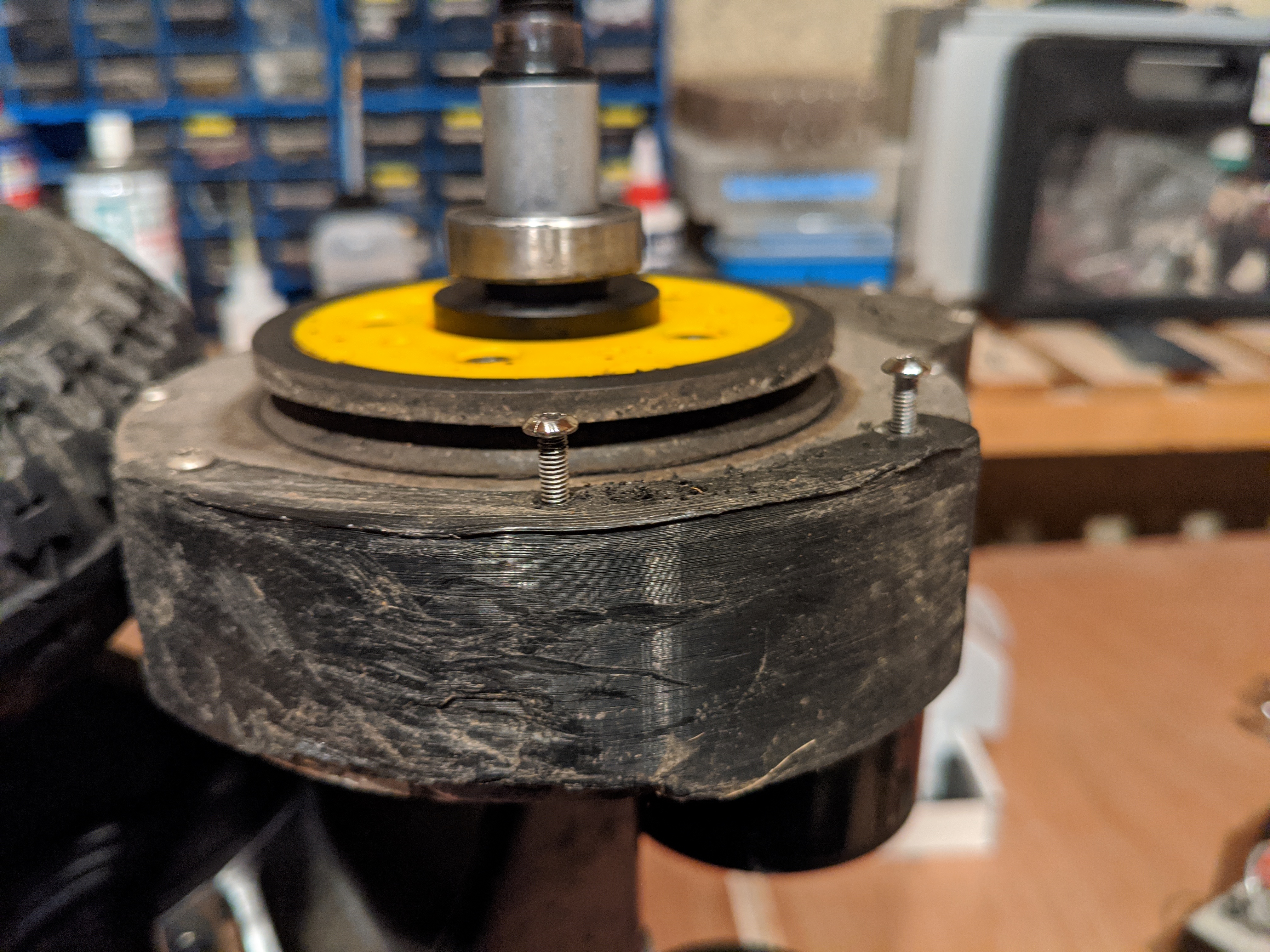

How did gear drive held up after 1000 miles?

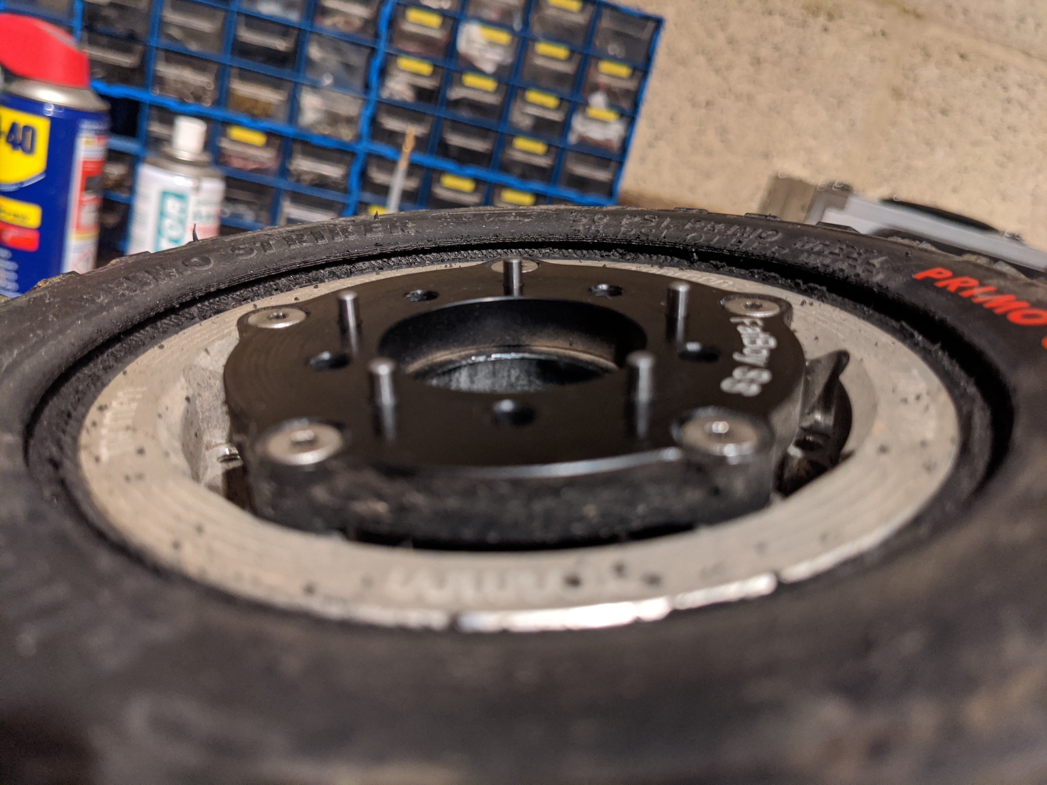

I had one issue where one of the screws came loose
I only noticed because they were slowly working their way into the wheel.
After this I removed the printed protectors and made sure the bolts had some lock tight.
But other than that they are still going strong. Honestly not had to open them since Paris so Im not 100% sure what they look like inside but they still feel and sound as good as day 1.
This is how most of my gear drives are. I’m pretty sure they will just run forever. I just add some Gun Oil™ every 2k or so.
