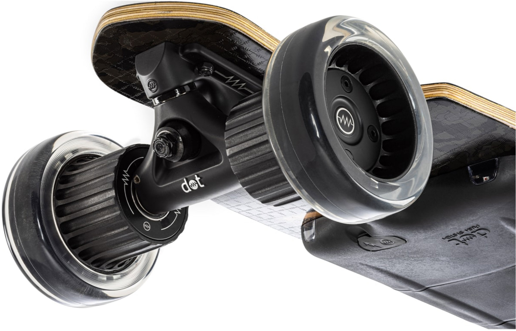

Is it a heatsink for hub motor?
a lot of things about this board are kind of fascinating. Like the power couplings inside the trucks, the motors plug into the hangers. And i wonder if adding packs is a series addition or a parallel addition, an ESC could be set up to allow either, but parallel would make more sense.
the asymmetrical tracking is fucking weird though. However, Jake’s carvon based drop through has a similar asymmetry (boas on 218s on the front and carvons with abec 107s on the back) and he says it feels great.
Well on the smaller single motor / single battery boards, when you upgrade to dual motor you automatically get another battery, thereafter though, it’s all just extra range.
So at least 2P needed for the amp draw on dual motor, then just more P’s after that for even more range.
Makes you wonder though, if they need two battery packs to power hubs, what cells they’re using?

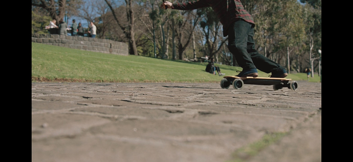

Got to wonder about those AT wheels apart from the looks, pretty ballsy to bust a mini slide on cobblestone in their vid.

What confuses me is that there are only 6 contacts in the battery, I’d assume one is the main positive and the other is ground, but that makes it a 5s…
Probably has BMS per battery. Otherwise it would be possible to connect a full charged group to a dead one and yikes. 6 pins maybe 2 for power and 4 for com between the groups.
