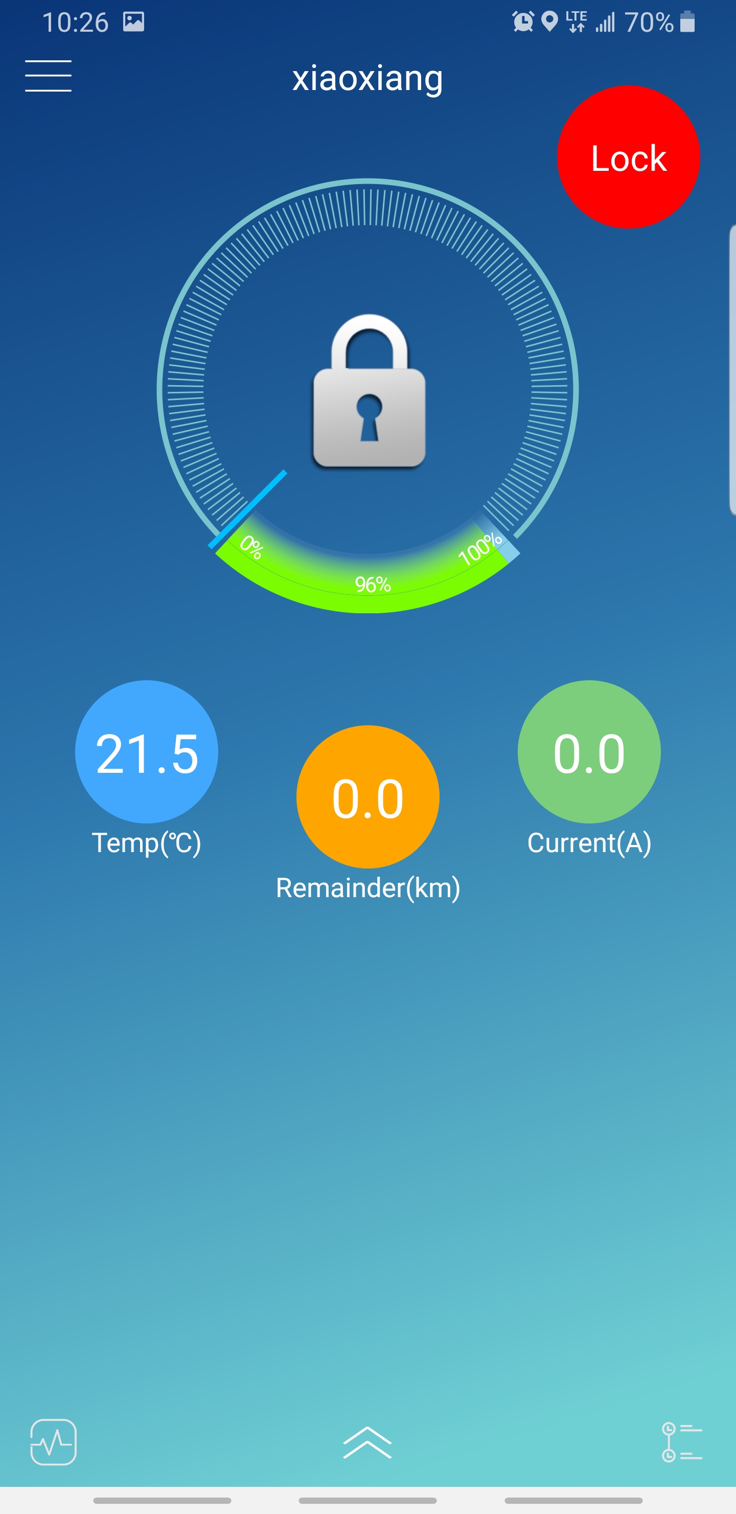

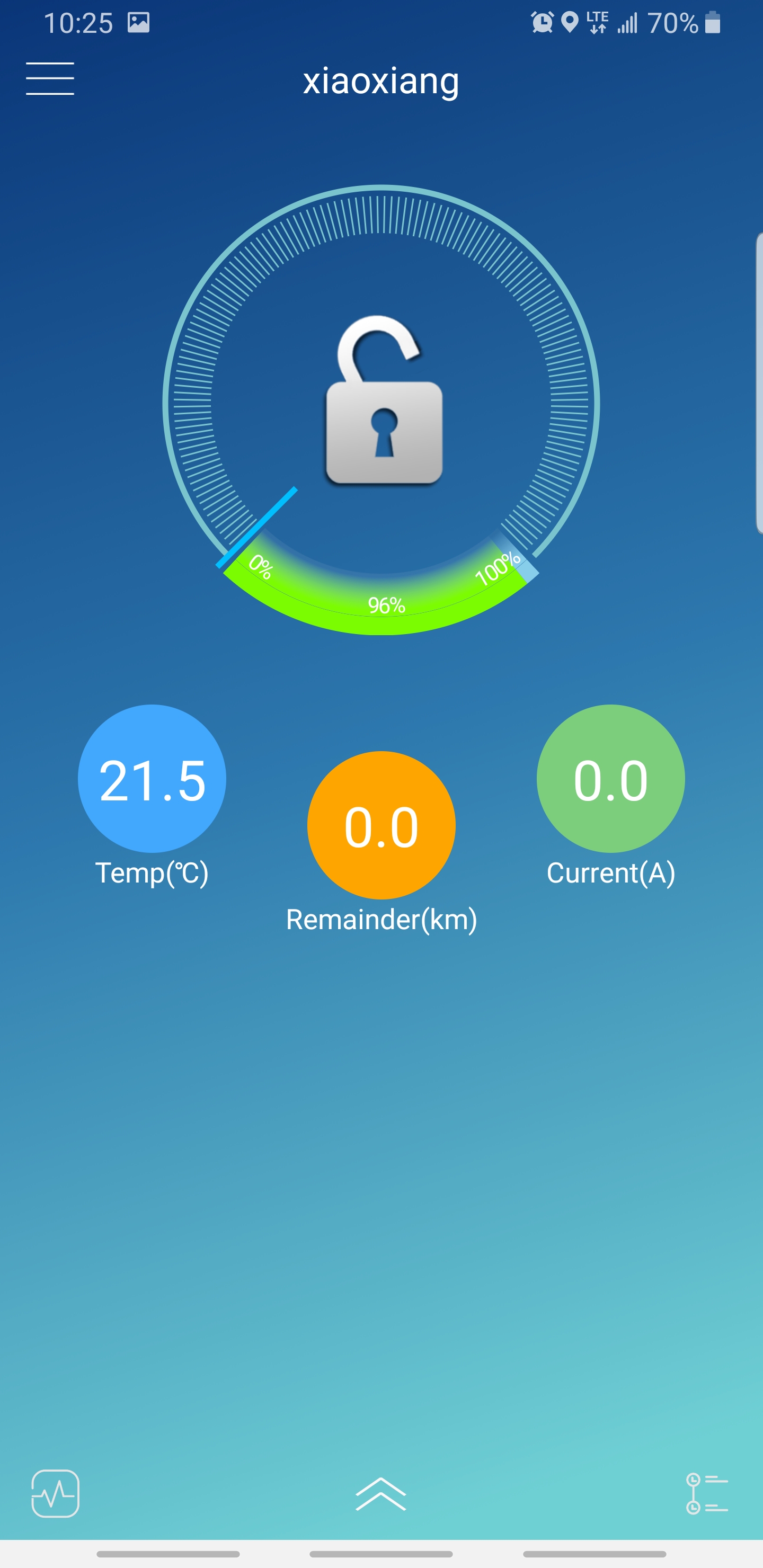

How about a xiaoxiang bms? It has a ble module connected to it and you can cut off the power with your phone?
Forget bluetooth, the smart functions work everytime.
