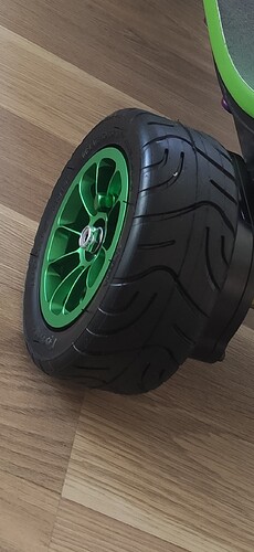

Do you balance your pneumatics tires?
Is 5 grams on the opposite side of the valve a normal way to go? :slight_smile:
Gonna try to balance mine tomorrow.
