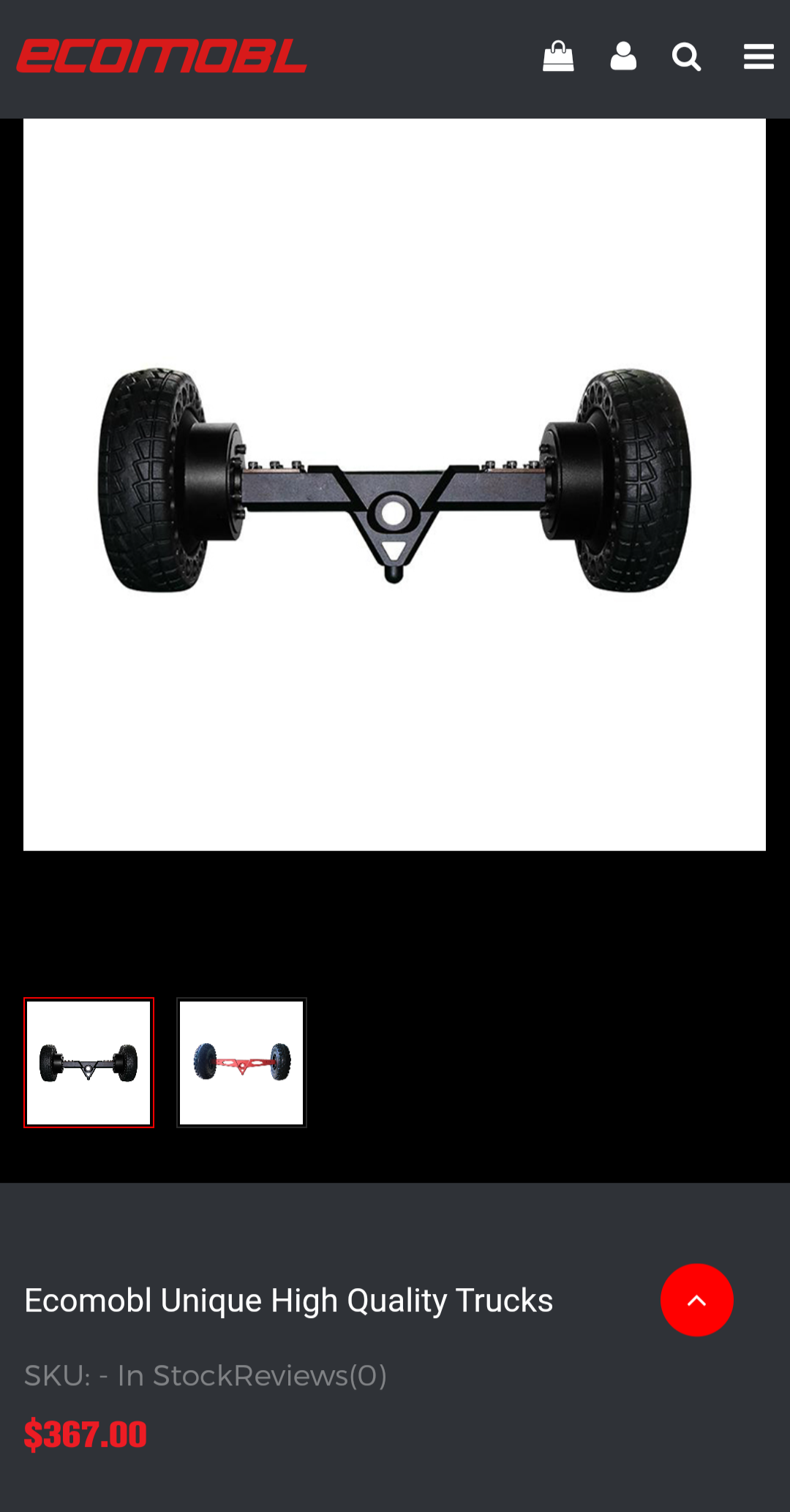

Don’t know if you are still looking for them… but yes they do exist… the spacing is slightly larger so you have to fabricate a wedge though… I use these on my skatepark build… I’ve only heard bad things about Eco mobile and I’ve never ridden in any of their boards,
