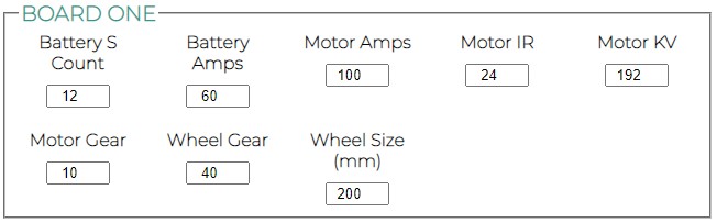

So confused now. If someone can walk me through how long it will take to go from 0mph to 1mph when you full throttle with these settings, I can code it.
Screenshot 2021-07-19 141009
All I’ll say is from 0 to 1 you’ll be hitting the motor current limit and not the battery current limit but at a higher speed you’ll be hitting the battery current limit and not the motor current limit.
I know this. I have factored this in already. There is three potential motor currents:
  • using the formula sqrt(Max power / winding resistance)
  • the motor current setting in your Vesc
  • actual motor current available depending on your duty cycle and battery current.
We have to pick the lowest of these three at every increment of 1mph. Am I correct?
Can someone help me work out the latter two?
Yes you need the actual motor current based on the battery current limit, speed and duty cycle.
Thats what I am asking help with. lol. How do I get this?
just use algebra with the equations I posted. you have everything you need right there.

It’s trying to get to 5000rpm but not necessarily going 5000rpm. The reason it can’t get to 5000rpm is when you do the calculation you’ll see that the motor current and battery current drops to 0 right when it reaches that speed under those conditions.
I’ll save you from pulling your hair out…
You can use:
((d * ((e+sqrt(e^2+(4 * h * f)))/(2 * d)))-e)/f=g
where d is battery voltage, e is bemf, h is electrical wattage, f is winding resistance, and g is the motor current
then you can find the duty cycle by dividing the battery current by the motor current.

if you run that formula for a given battery voltage, back EMF, electrical wattage and resistance, and then you decrease the resistance, you will see the motor current increase, and that’s why you can feel more torque with a bigger, lower resistance, same kv motor.
I got stuck on this for a bit because I was thinking how can motor_current be independent of battery amps (2nd equation) …
but I think i got it …
  • the battery amps are in the wattage_electrical (3rd equation)
  • I had been thinking a fixed voltage. voltage is not fixed it will sag.
  • either that or vesc will hit battery current limits and reduce duty_cycle.
Lets say you know the electrical wattage (battery amps * battery volts), motor rpm, kv, bemf_v, and winding resistance, it will be hard using those equations to deduce the motor current and duty cycle that makes all of them valid (except by trial and error or rearranging them)…
that’s where this one comes in handy:
(ps winding resistance is ohms not mOhms)
The motor amps are separate from the battery amps because they are at a significantly different (lower) voltage than the battery voltage, and the duty cycle determines how much lower. If you apply the full battery voltage to the motor at low speeds (100% duty) you would get way, way, way too many amps and too much power.
