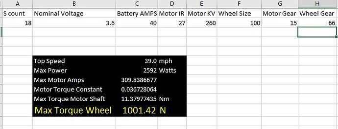

Now try it with 18s, 260Kv, and an absurd gearing and see what you get.
You’re better off with a multistage reduction at that point because with the torque involved you want as many teeth in mesh as possible
Let’s turn this into an online calculator.
The calc is inaccurate, see ohms law…
As one example, with 64.8v and 98mOhm, max possible motor current is 661.2a, not “162.6a”
I suggest starting a new thread since this has gotten far off topic.
But to summarize the answer to the OP’s question, 10-12lbs additional thrust @ 15mph is plausible by dropping the motor resistance from 70mOhm to 20mOhm with a larger, same kv motor and changing nothing else. I assumed 2 motors, 12s, geared for about 40mph, with 30a bat and 80a motor limits per motor. At 15mph, they’d be hitting the battery current limit and not the motor current limit, and essentially the lower resistance motor has more motor current at that speed than the higher resistance one on account of lower I^2R losses (both have less than 80a motor current available at that speed on account of the 30a battery limit, but the lower resistance motor’s motor current is higher).
If you’re getting 162.6a motor current with a motor that isn’t turning, and you have 98mOhms, then the voltage to the motor is 15.9v. (see ohms law) That’s also 2590 watts. Since the battery voltage is 64.8v that works out to about 40a battery amps.

Just simply calculate the I^2R losses of 2 motors (same kv) at a given speed and torque… a larger one with lower resistance and a smaller one with higher resistance. You will see the mechanical output (and motor current) is the same, but the I^2R losses of the smaller motor are higher, resulting in lower efficiency… you need more current from the battery to supply the same performance plus the additional losses of the smaller motor.
