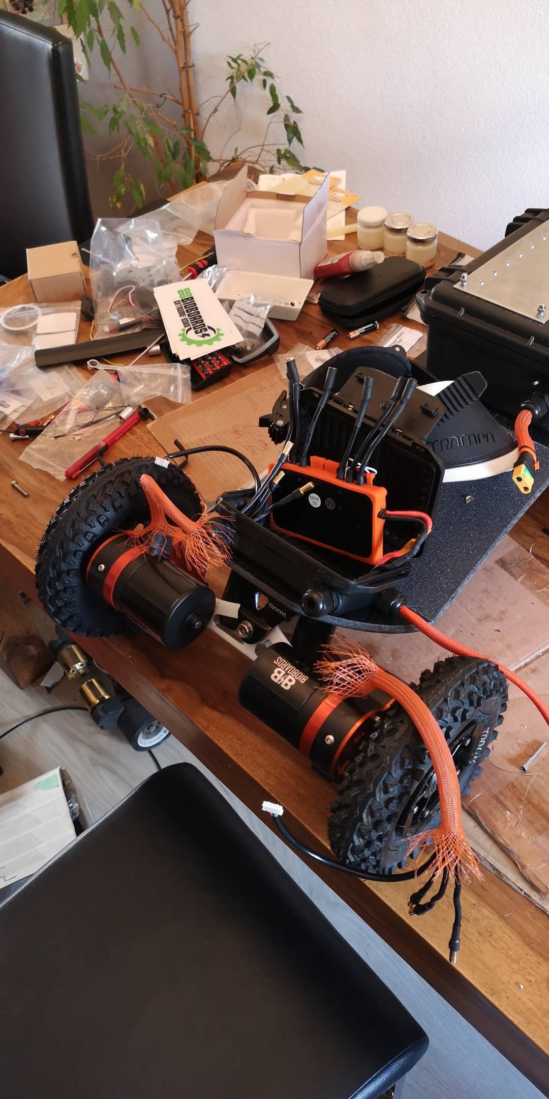

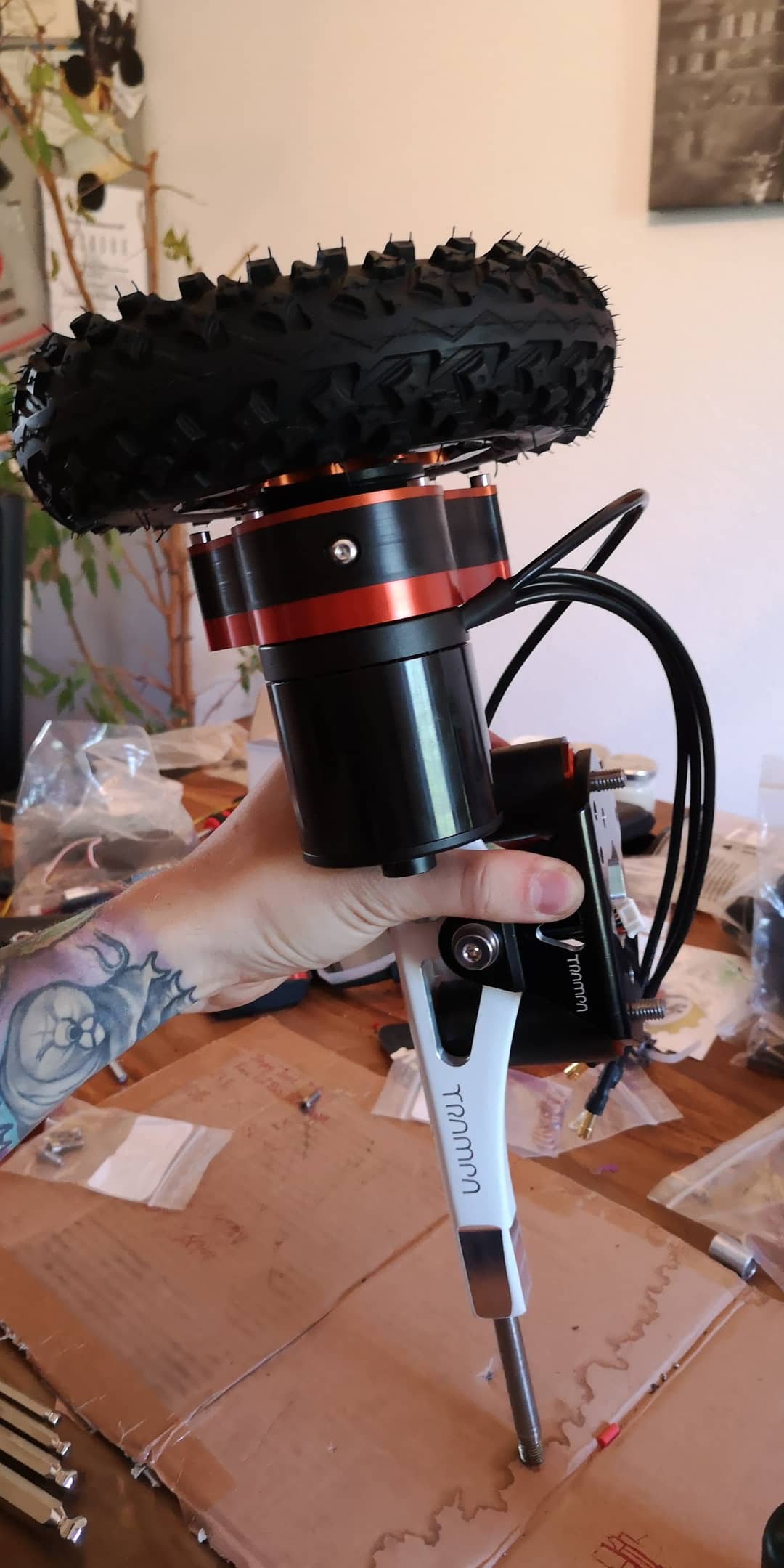

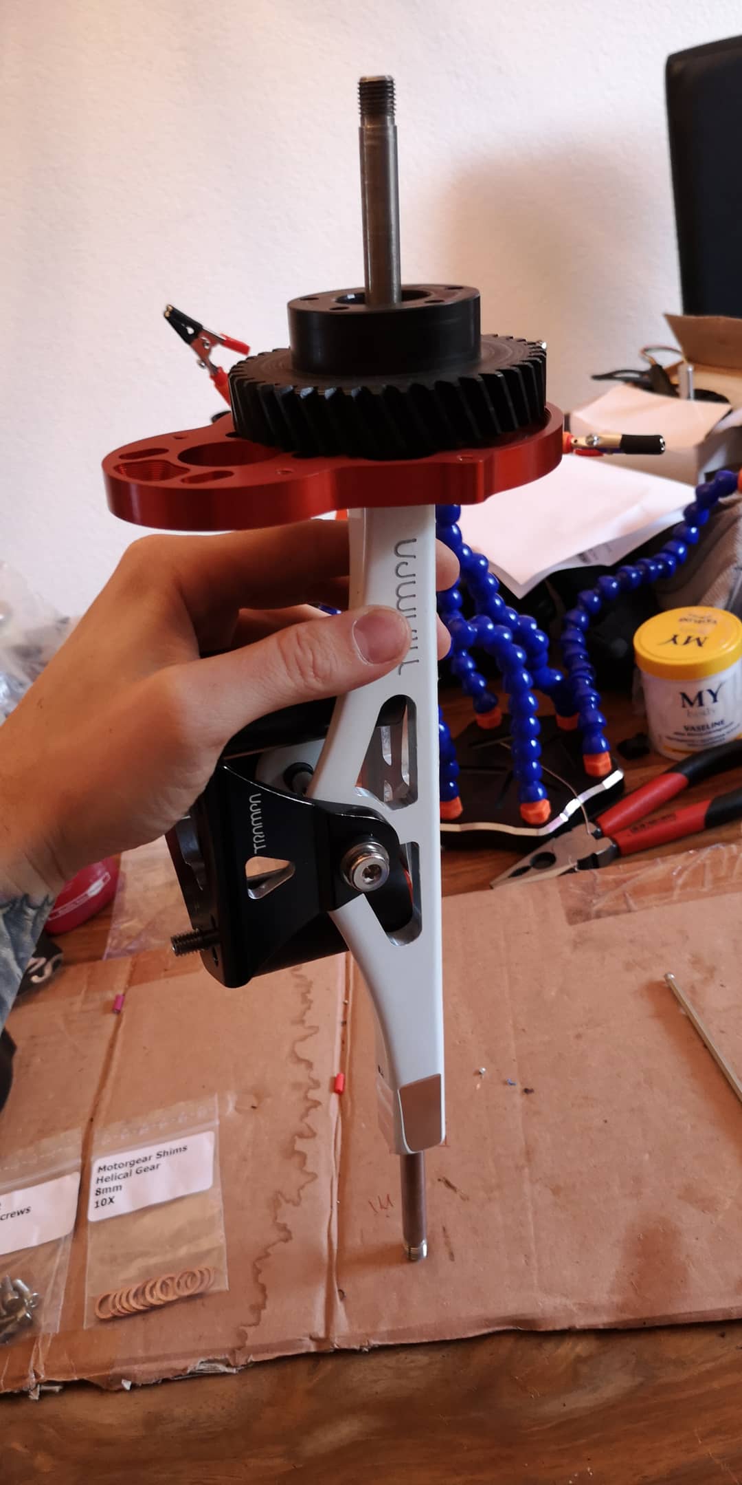

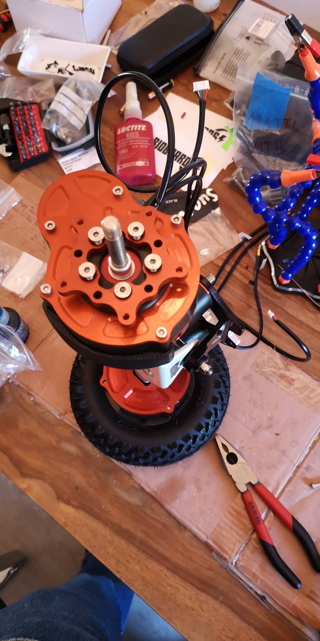

Hey there :slight_smile:
I just wanted to share my building process with you guys!

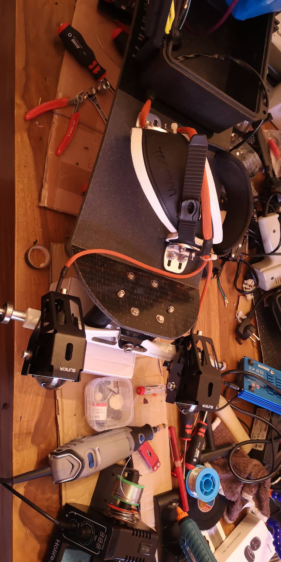

Specs:
–> TRAMPA Mountainboard with 9.525mm TITANIUM Axle ULTIMATE Trucks RATCHET Bindings
–> ULTIMATE WHITE - CNC with 9.525mm Titanium Axles
–> BLACK Innova MUD-PLUGGER Tyres 200mm

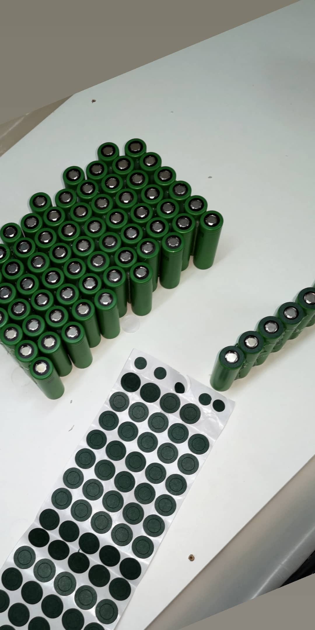

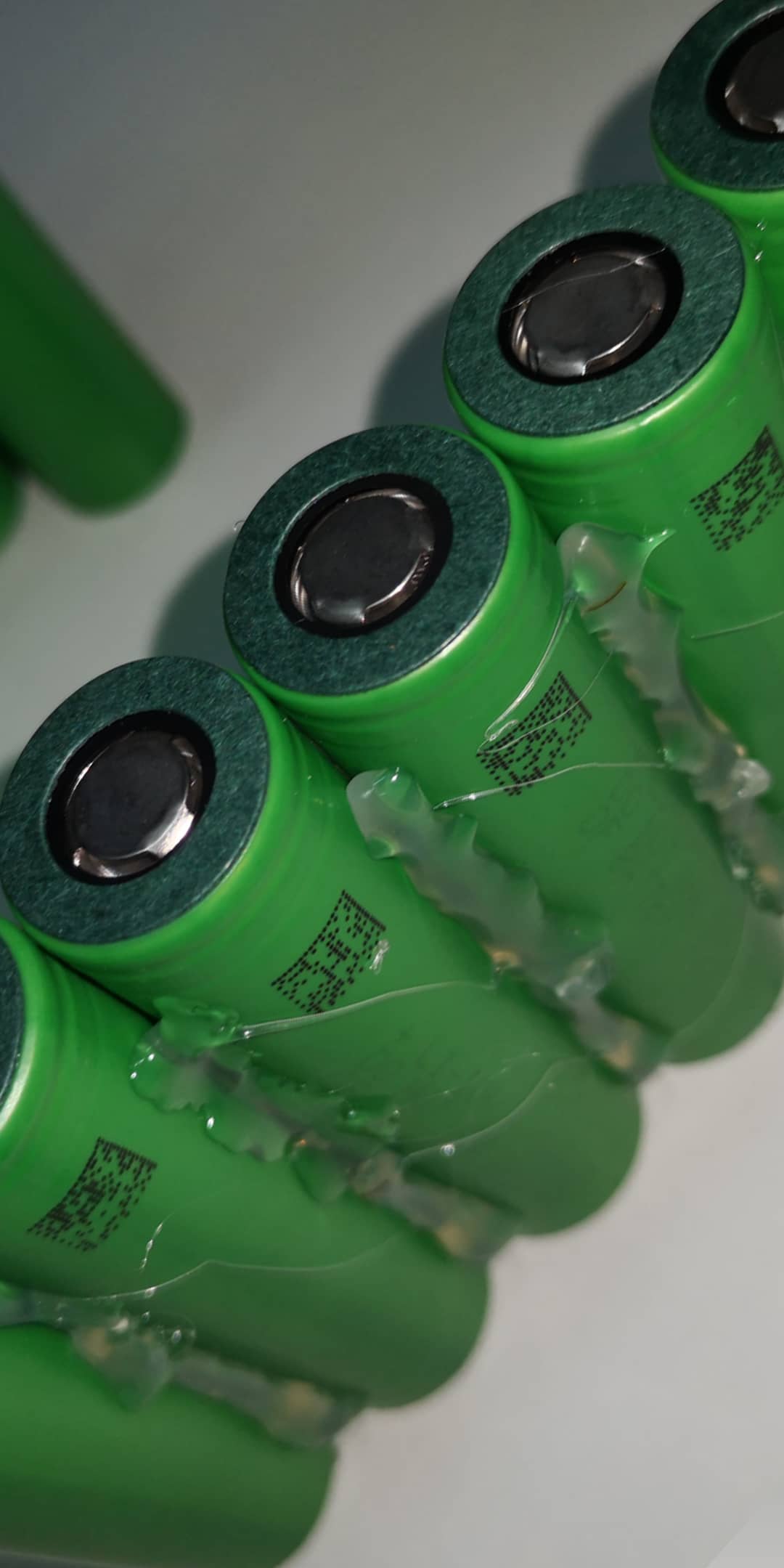

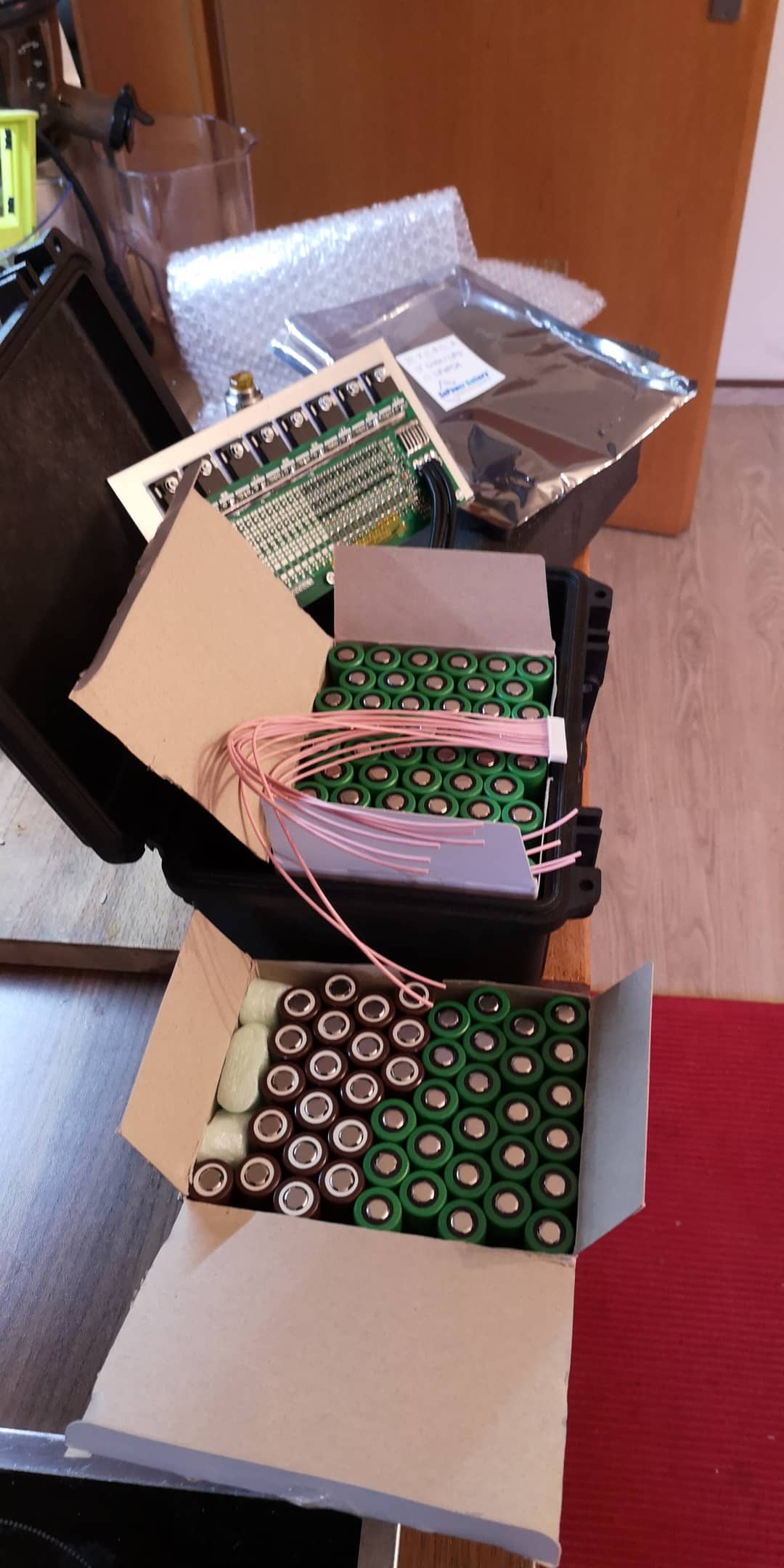

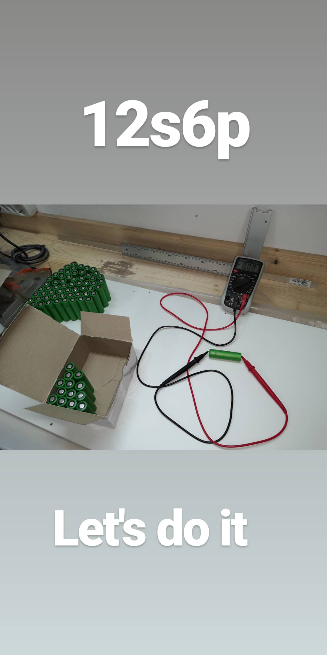

–> 12s6p Sony VTC6 18650
–> 150A BMS
–> Mini Helical Geardrive E-Toxx 8mm
–> Elastomere Damper E-Toxx
–> 2x 6374 150kv Bioboards

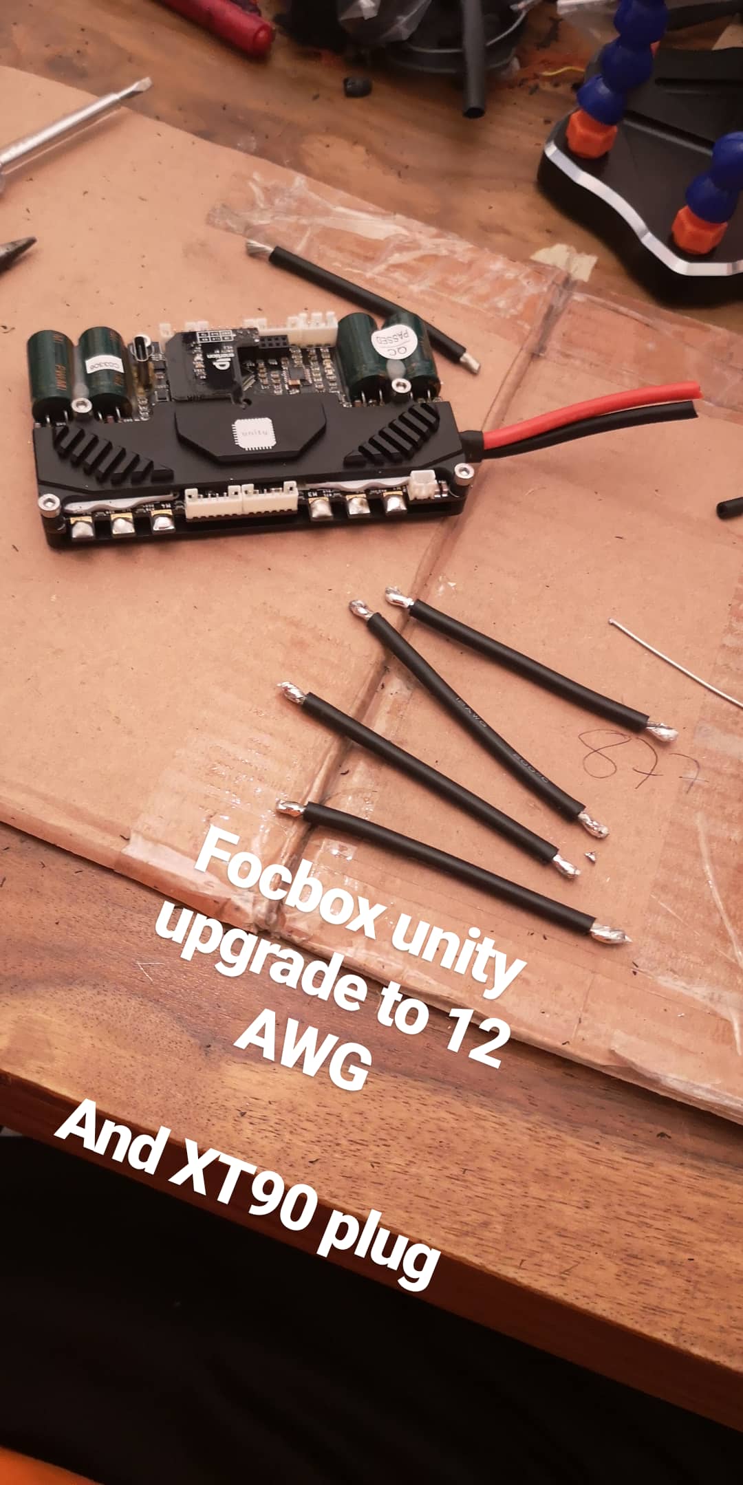

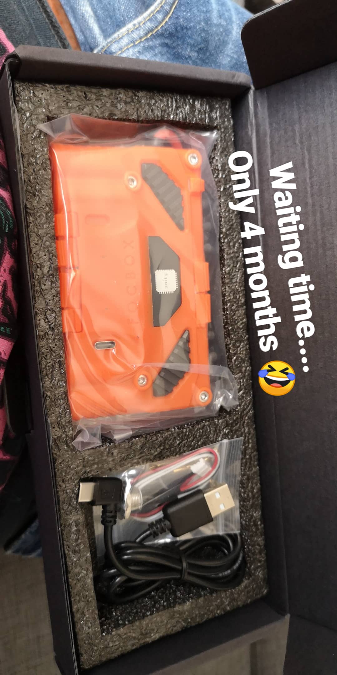

–> Enertion Focbox Unity
–> GT2B Remote MasterCho Mod

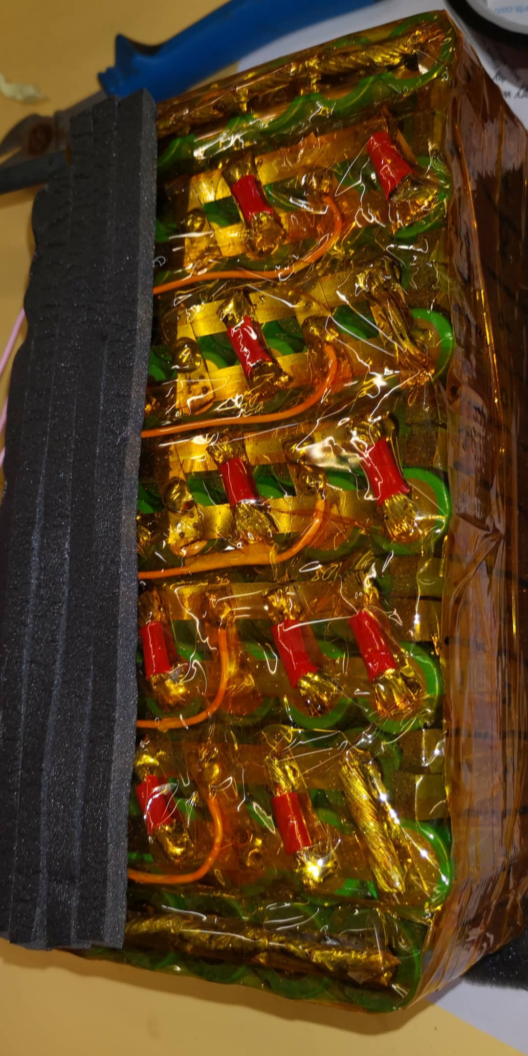

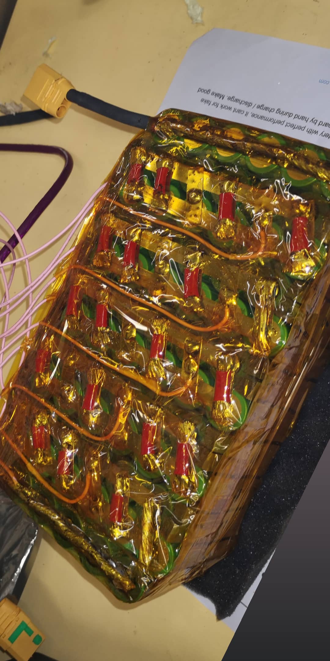

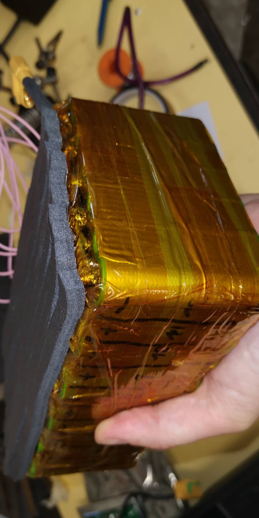

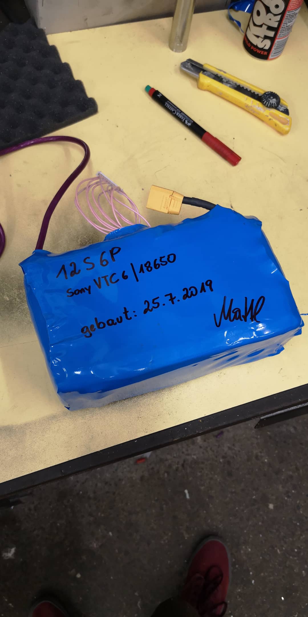

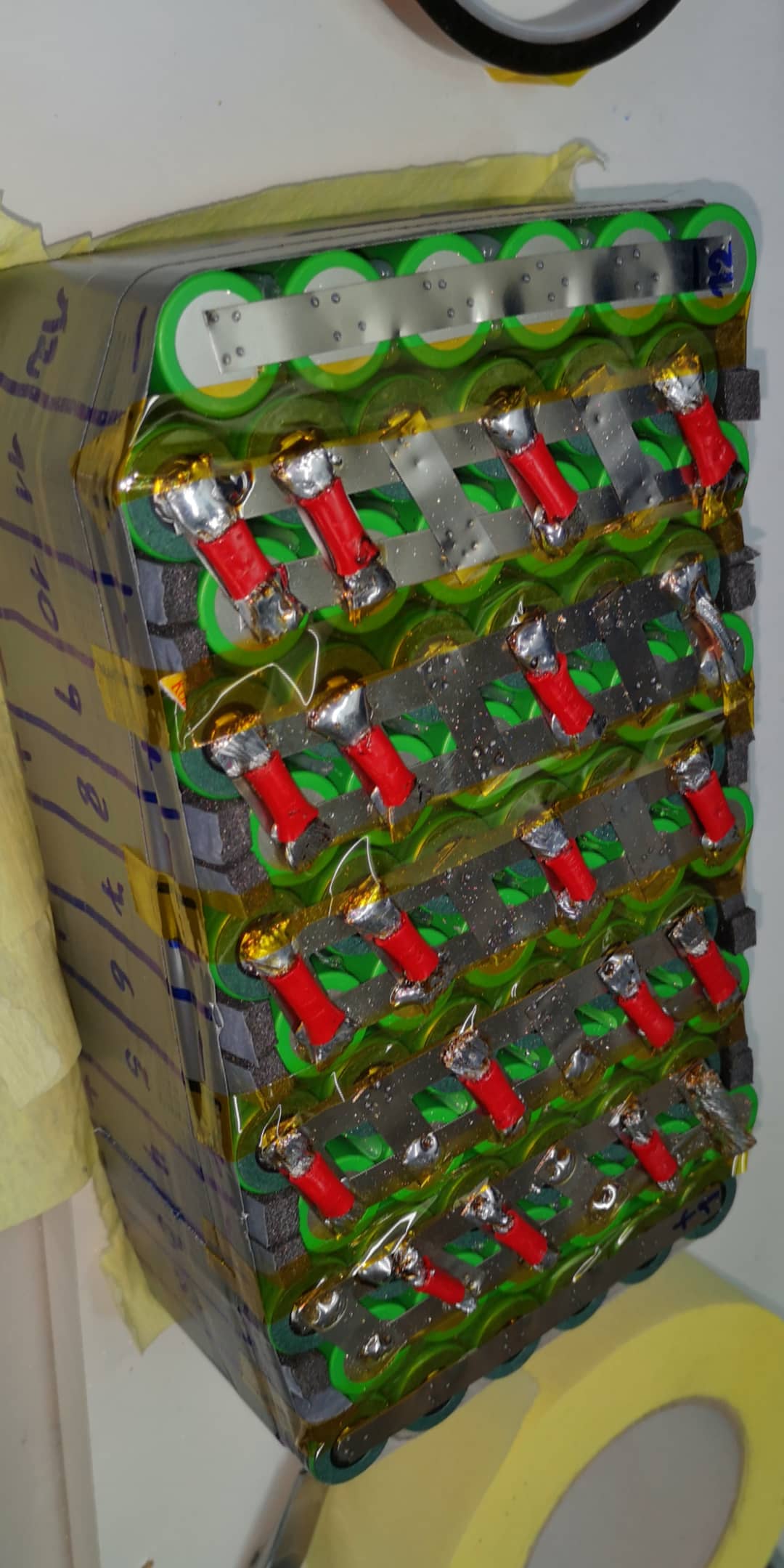

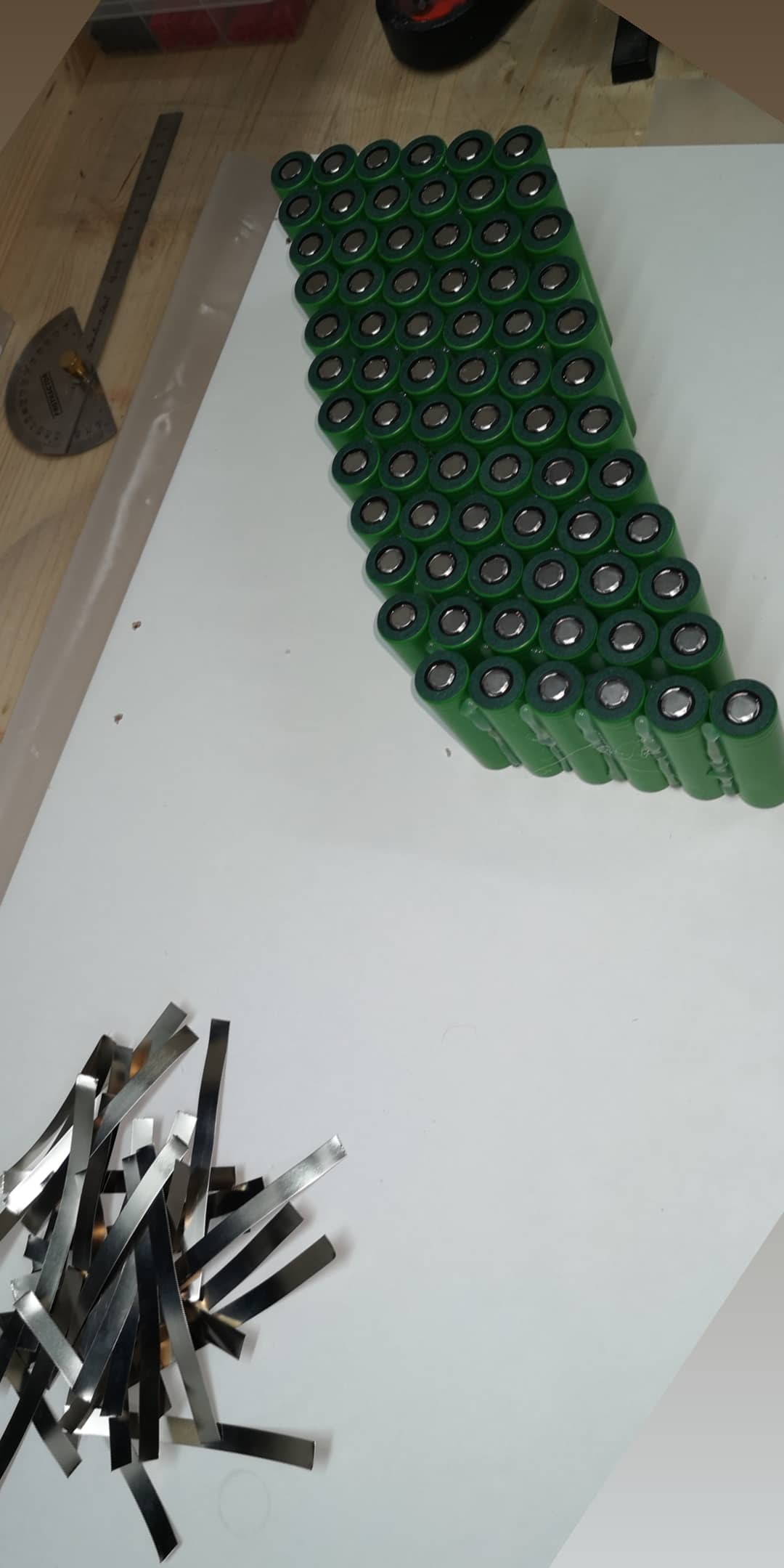

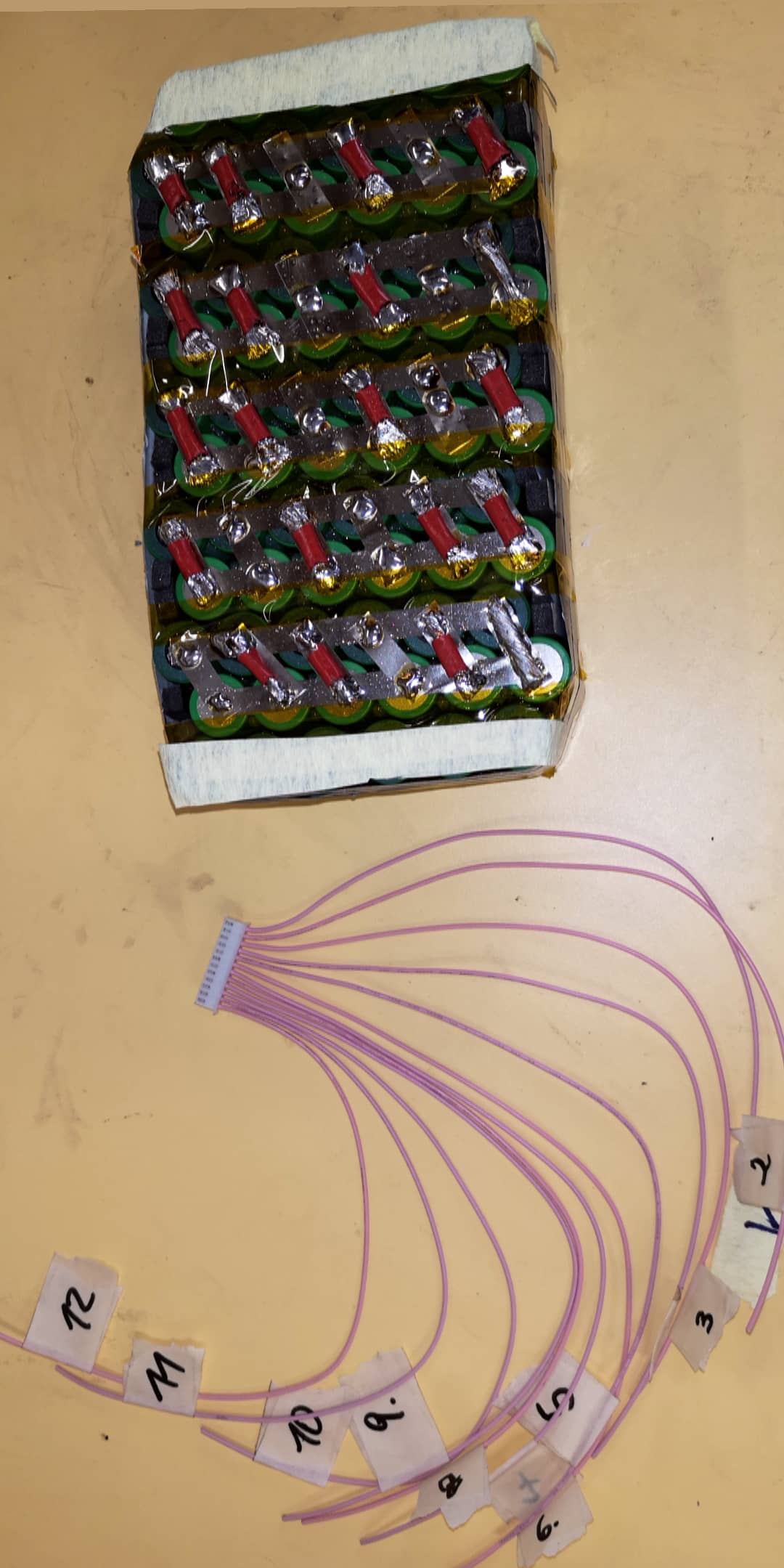

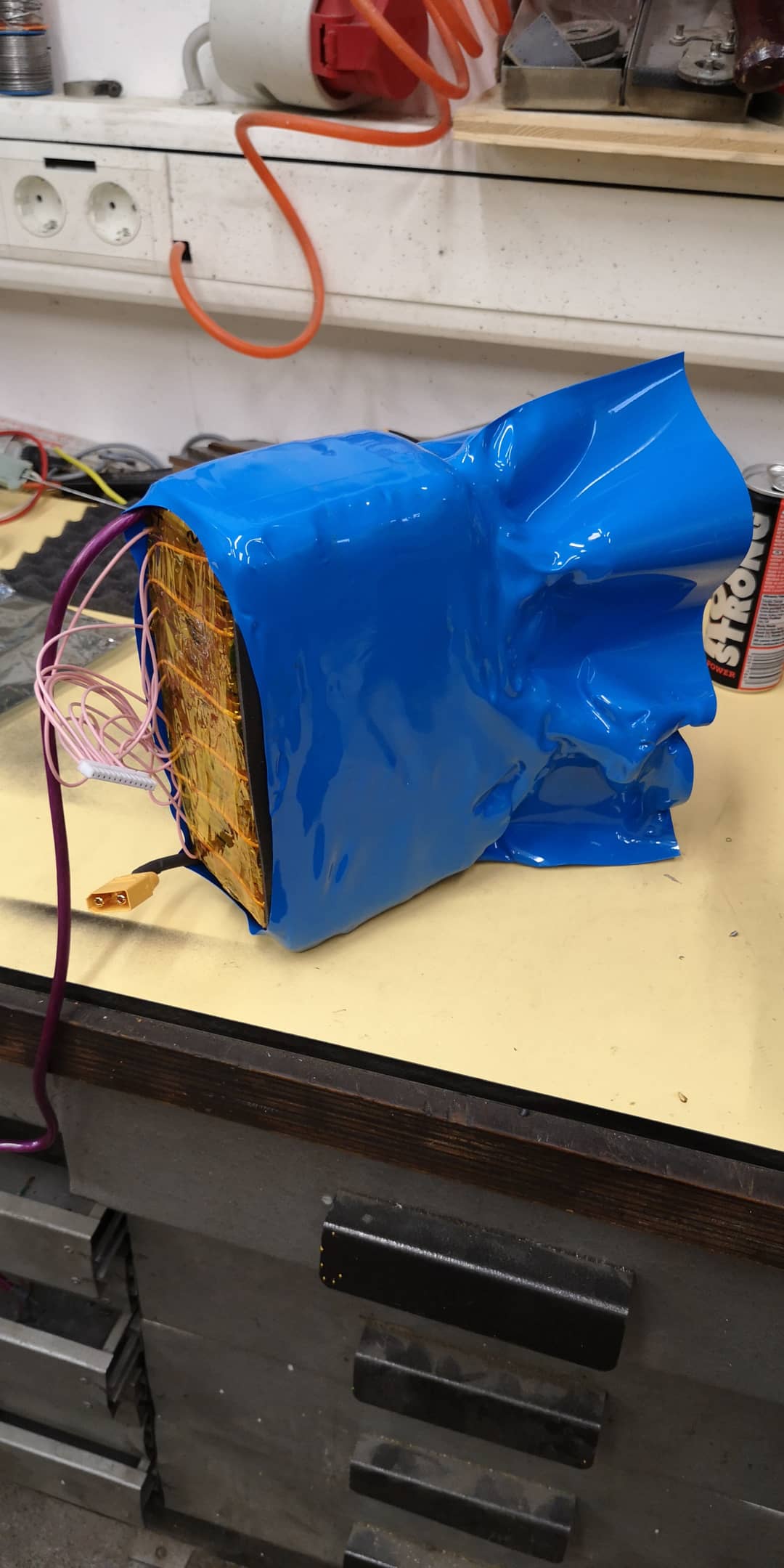

Here are some building impressions. Sometimes it was a pain in the a** but with a little help of some amazing friends I did it. I also know that some things could be done better - especially the battery. For example to the nickel strips round etc. But I am happy with the build and and in case of electronic safety I did my best.
I have to mention these very amazing people in the forum who helped me with this project:
Thank you - @RyuX - my sensei in all electrical issues !!!
Thank you - @Sharky - the eskate allrounder - his knowledge is from another planet !!!
Thank you - @Lee_Wright for the e-toxx installation video on YT !!!
Thank you - @NoWind (E-Toxx) for instant help and delivering !!!
Now it’s time to but on the safety gear and grind the tyrolean mountains :slight_smile:
Ride safe - best regards Mattl

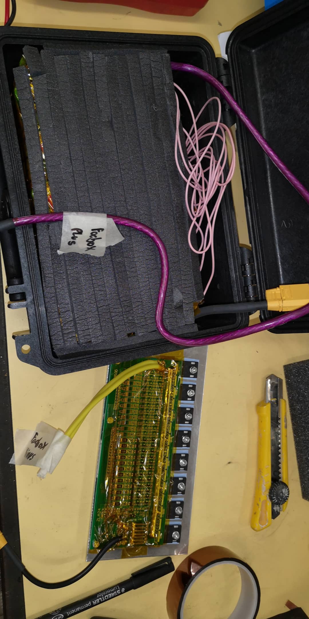

BMSSimultaneous or separate?
How was the ride and what range did you get from your battery in the mountains or hills?

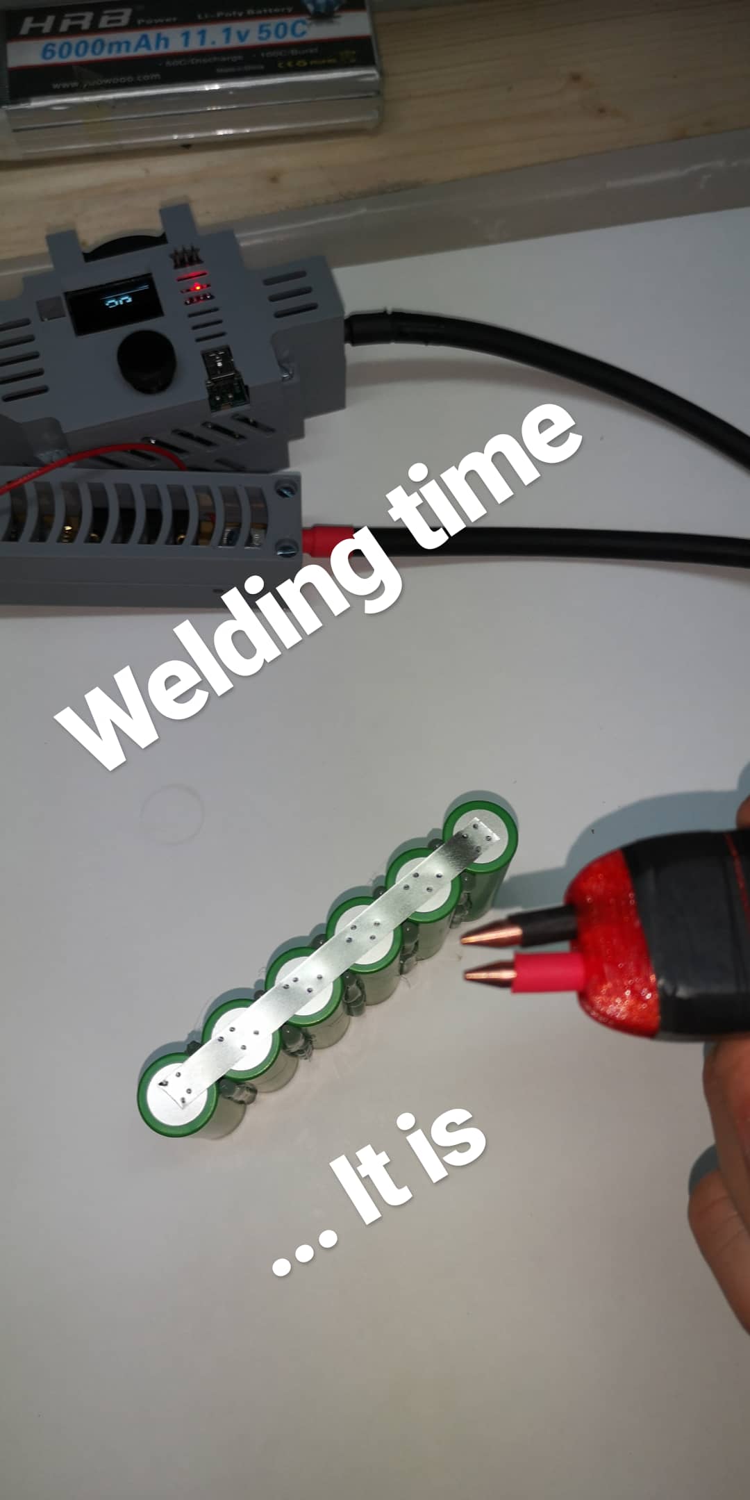

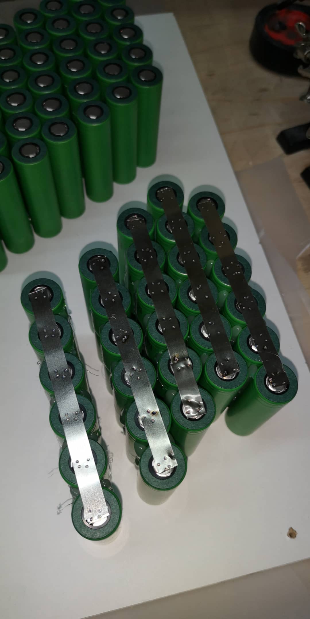

Where did you get that β€œholder” for the two welding probes on the malectrics spot welder? Is it 3D-printed?
Loving the build btw
you mean BMS only charge? I’ve got a 120A BMS and ride with 60A. The BMS is wired charge an discharge.
my longest ride was 1000 meters of altitude/height and 30km distance - one charge and 30% left in the battery. with my 12s6p sony VTC6
thx man - glad you like it - this is the spotwelder of my friend @Sharky and he 3D printed it, so pls ask him :slight_smile:
