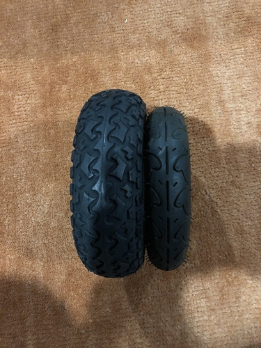

I live in Minneapolis, MN and enjoy the winter however have had to adapt to difficult eSk8 conditions. I ran with a Chen Shin 200mm x 50mm tire see below:
The tire was OK …at best… as it was an improvement over the Kenda 200mm x 50mm slicks I run on the roads most of the year (that are great in all conditions except Ice and snow).
The Chen knobby just did not do well on ice and left me wanting more traction.
