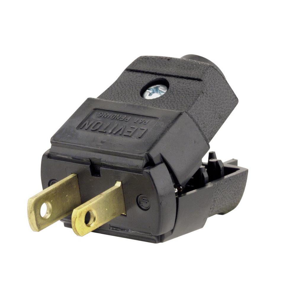

One, two prong socket ends for each lamp
