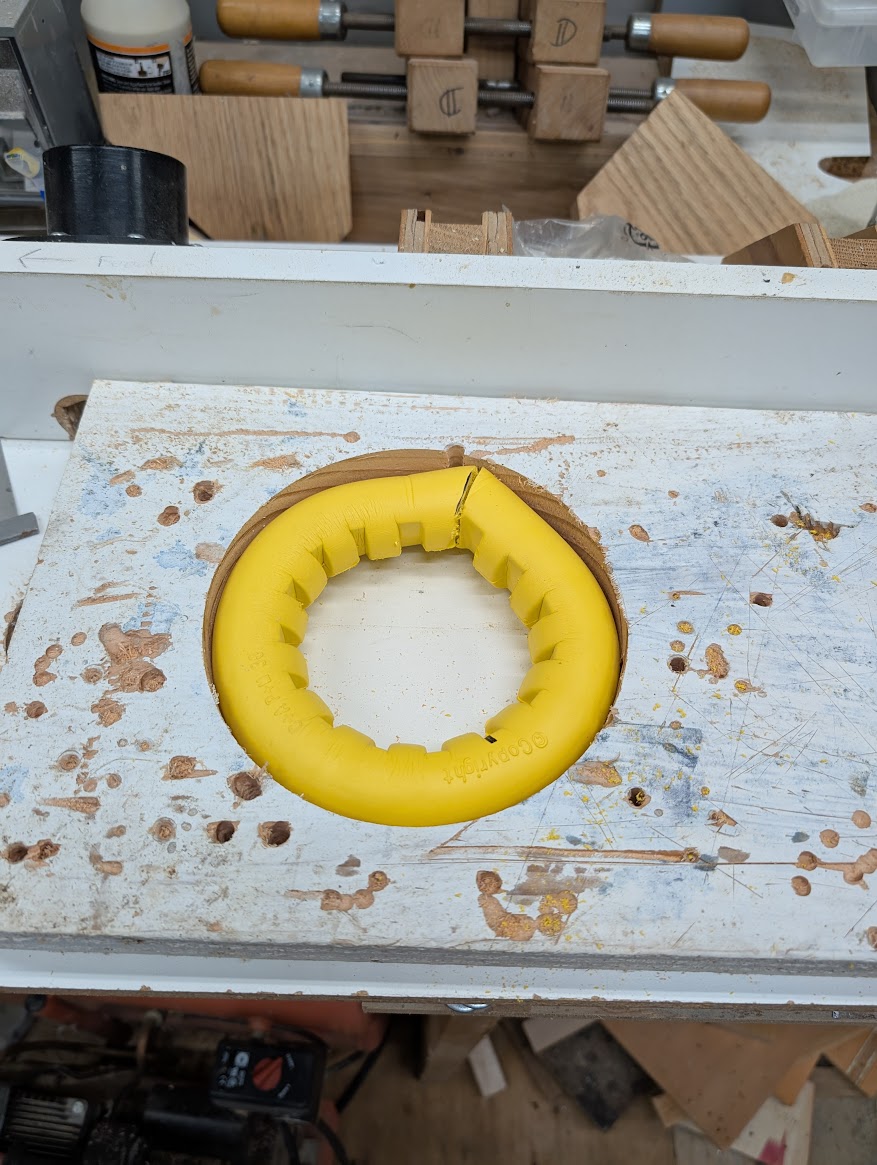

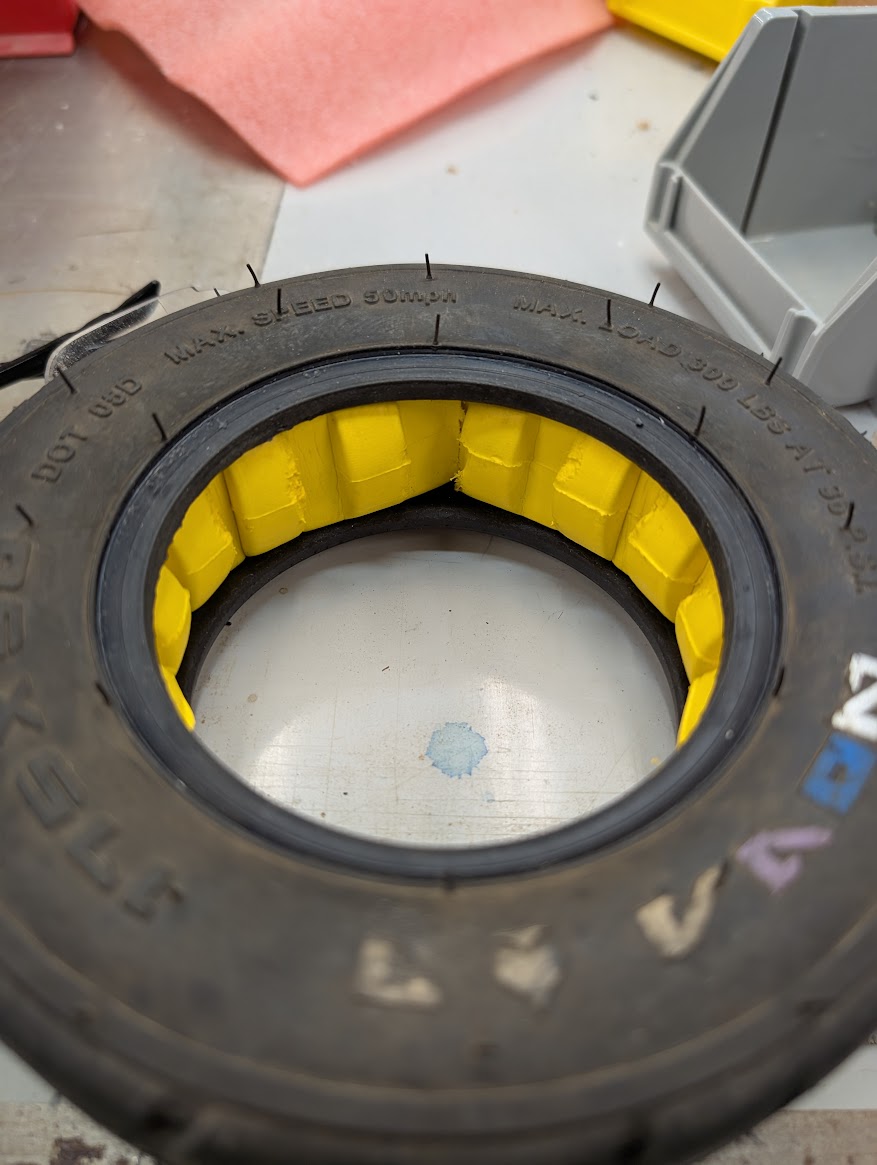

Worked better than expected. Squish equivalent to around 35psi. Much flatter profile means larger contact patch and better grip (in theory). Feels almost exactly the same as tubes with no loss of range. i was expecting some loss of range/ tyre roll while carving hard or vibration but its spot on.
If you’re heavier/ like to pump upto 50psi of course then you will lose some range.
1x 20"x1.75 JUST exactly does 4 tyres. 26" insert would give some room for error.
Didn’t actually need to trim them down. can JUST get them in without trimming and this would then be slightly rounder profile and firmer.
the ‘stop-a-flat’ are nice dense inserts
Should work on other tyres such as evolve 6" or 6" Electric Skateboard Tyre Full Set of 4 150x50mm – Eskate.shop
I cut 1 end of each insert at an angle so that there was no dead spot on the outside surface. The photo of it inside the tyre shows a gap on the inside. test fit and if it feels softer at the join a small triangle piece can be added.

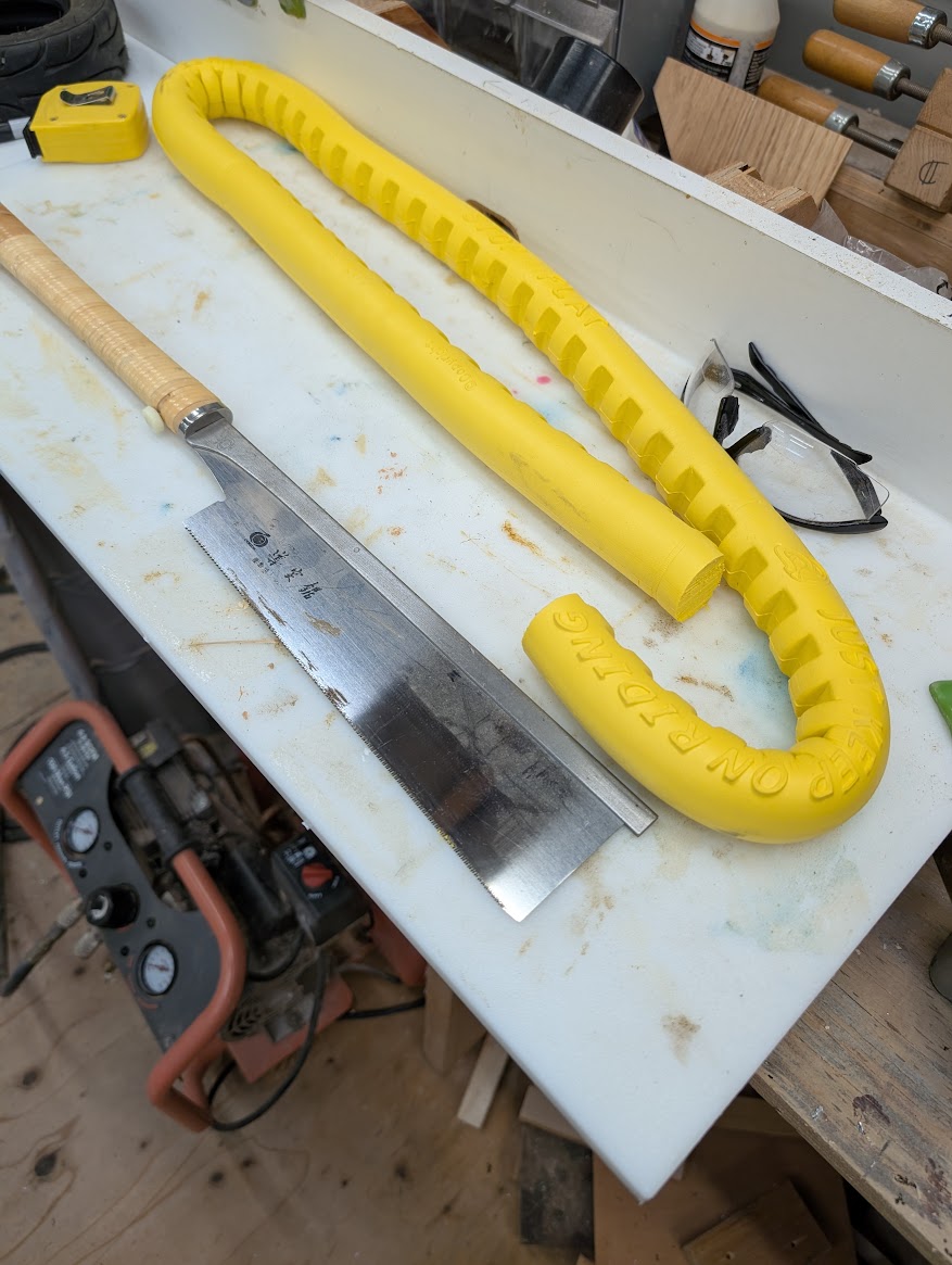

So as followup I’d like to post some piccies of my process

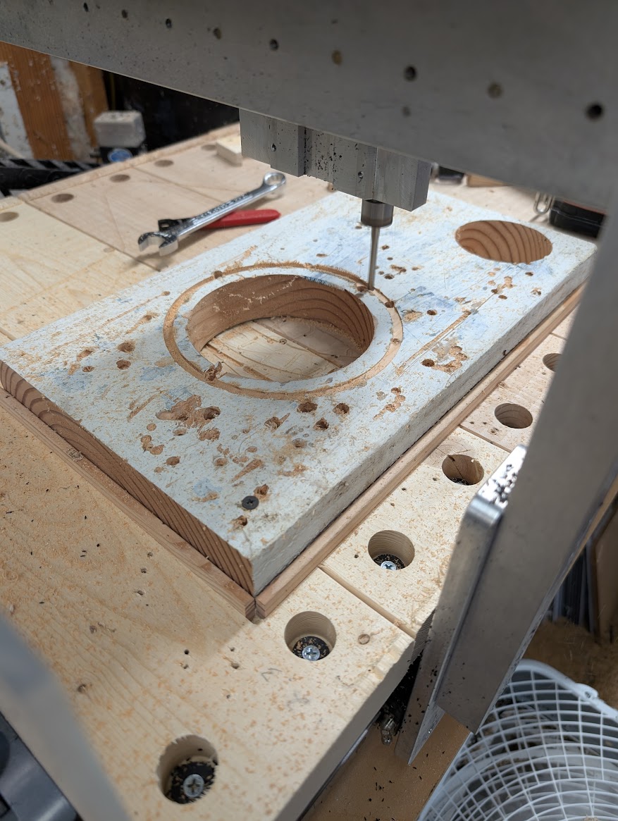

first thing I did was CNC me a fixture that was the same diameter as the Inside of the 7" Nova tire.
chose a suitable cutting device
cut and squeeze

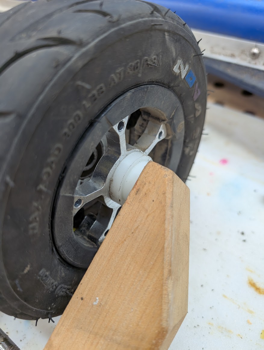

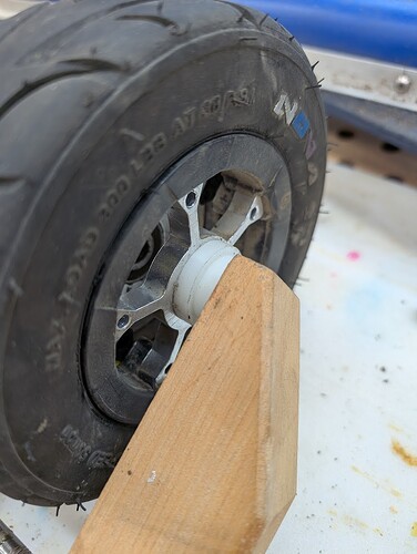

Squeeze and squeeze. You’ll need tough skin for this part. I don’t have tough skin.

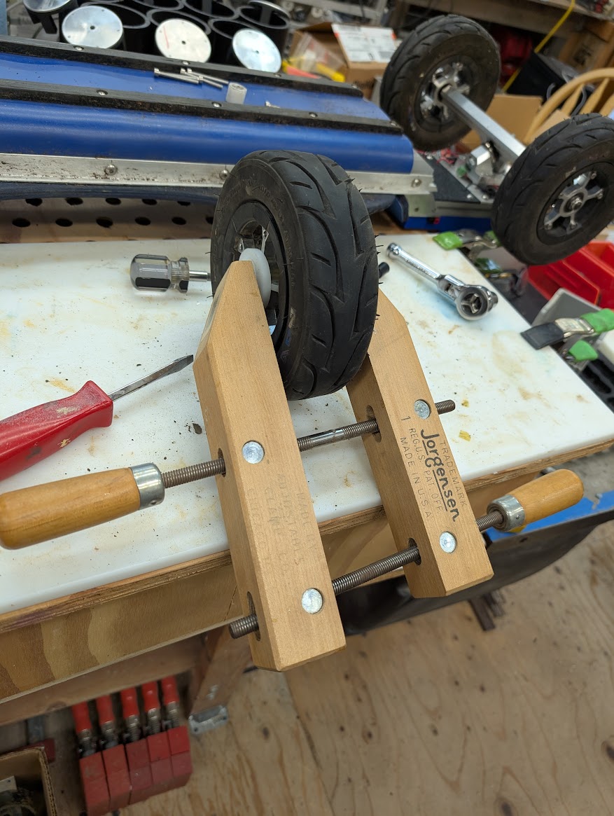

Then because the 2 halves of the rim don’t come together completely you’ll need to squeeze them together to get the screws in. This is what I had within 5 feet.
Throw the screws in, tighten in alternating order a bit at a time until the whole thing seats together flat

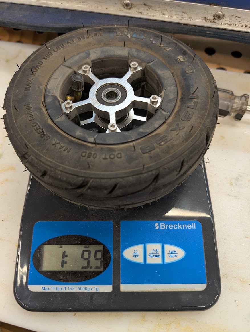

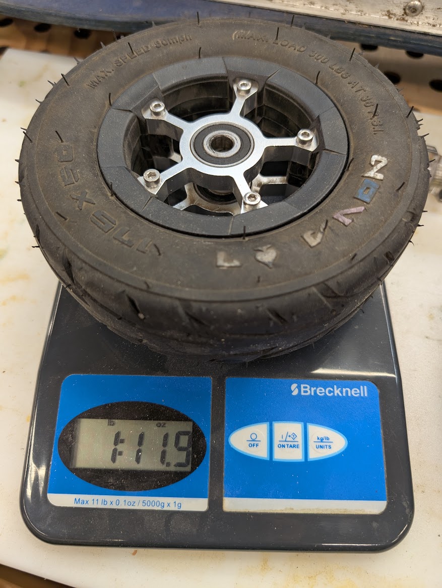

Note that you will take a 2 OZ weight penalty for each conversion.
I can get 3 conversions out of every insert I buy at $37 per . But I’ll take the cost of it over running out of battery midway every time.
