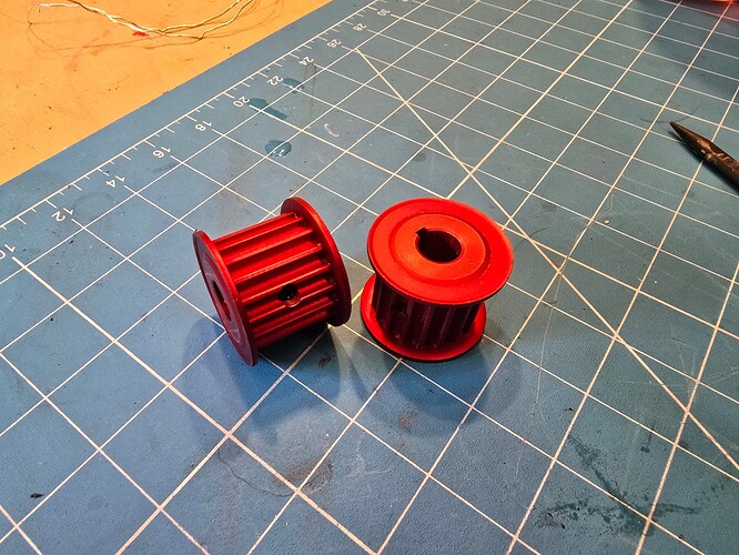

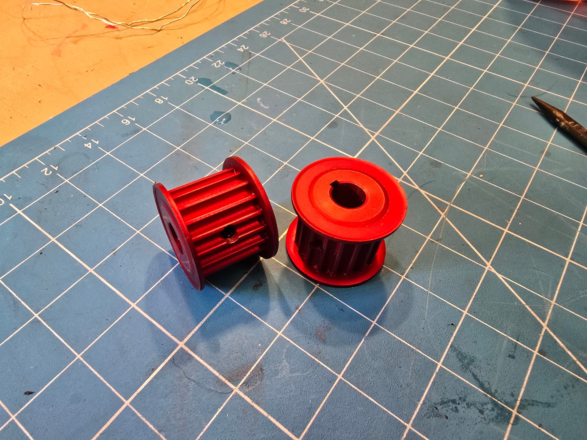

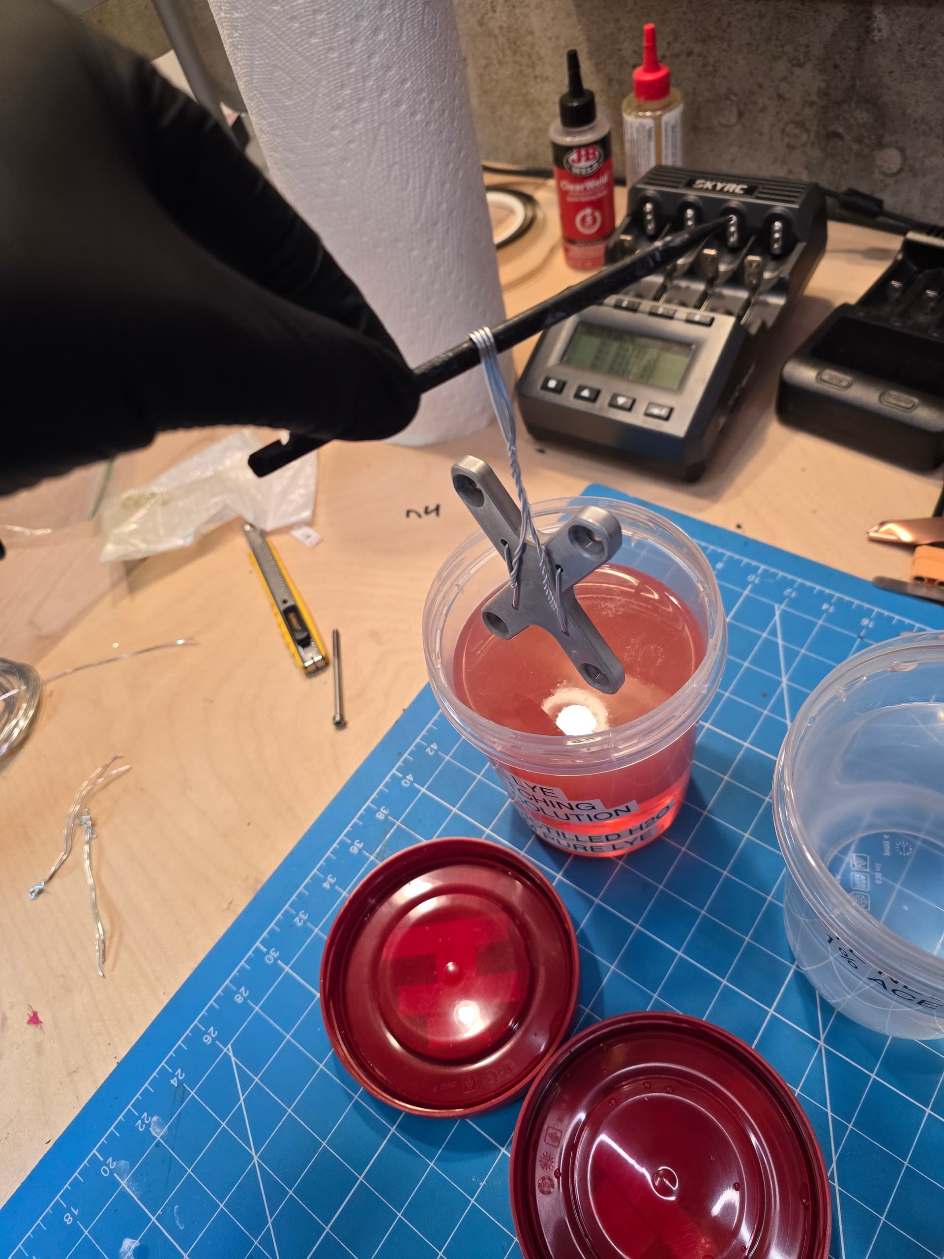

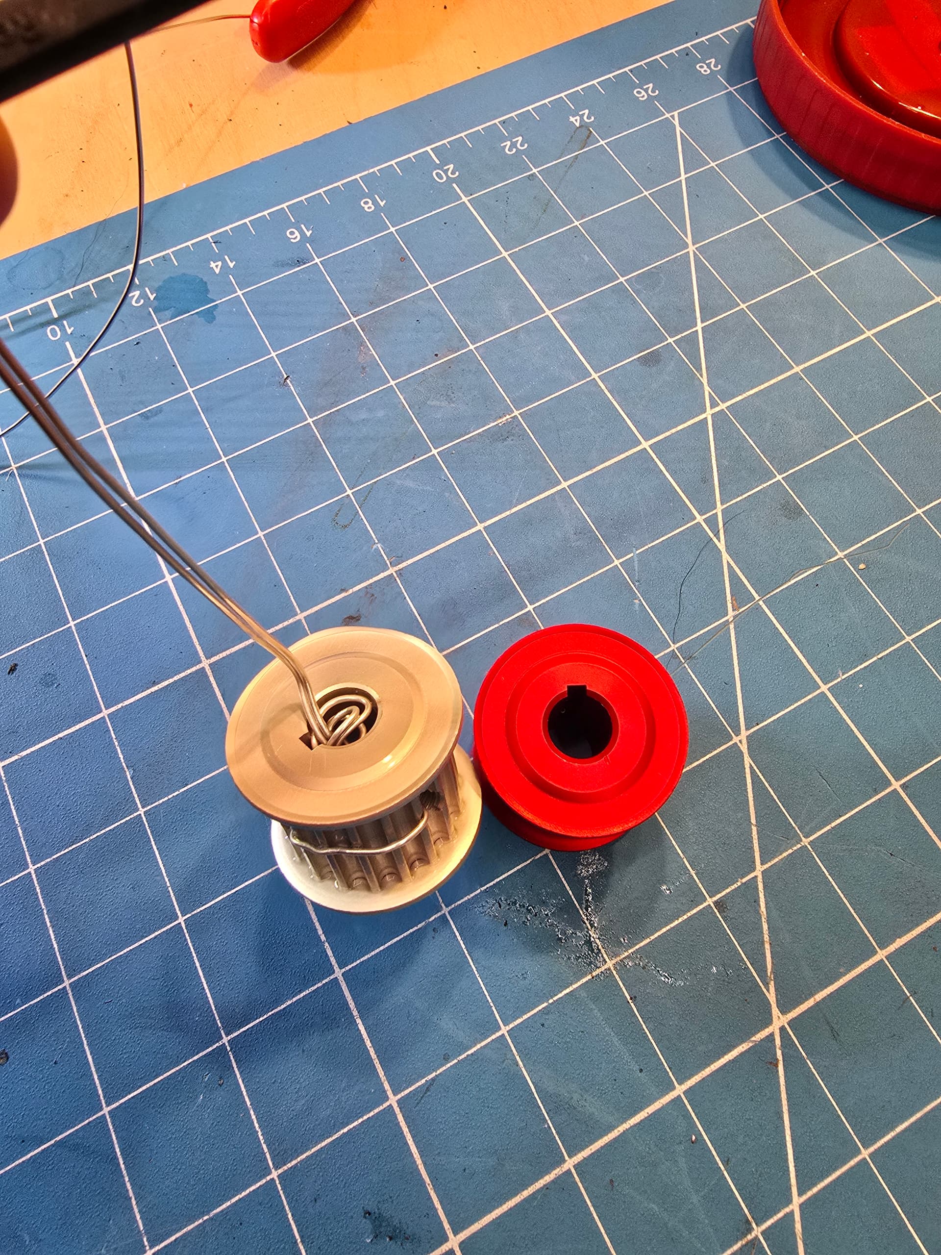

I have messed around with this a little bit. But really haven’t had time to get into it.
I picked up anodizing dye from
amazon

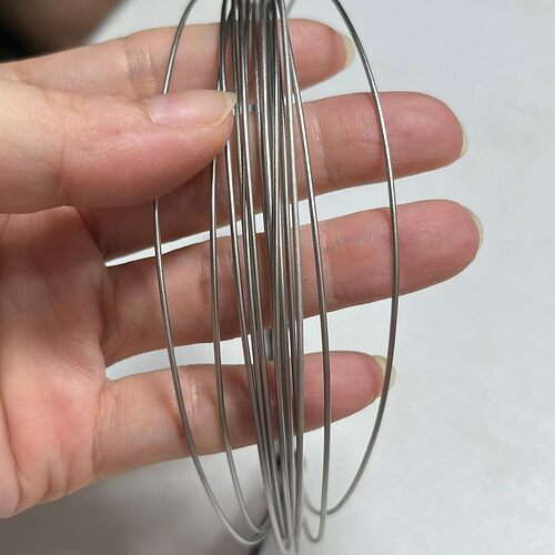

Titanium wire (amazon) for anode (or cathode, i forget which off the top of my head)
Battery acid from AutoZone (had to ask for it and they had no clue what I was talking about, but one of the old timers knew they had it out back.)
Bench top power supply (Amazon)
I tried once before I had the titanium wire when I was being impatient band it didn’t work. I did end up electroplating the clips that I was using with copper.
So a good sign that the setup does work, I just didn’t take the time to do it right and have a handfull of other projects that are higher priority right now
If you wanna get rid of the stuff you bought, I’d take it off your hands. Titanium wire definitely sounds like a must, since aluminum wire will just anodize itself and have to get tossed after using it once.

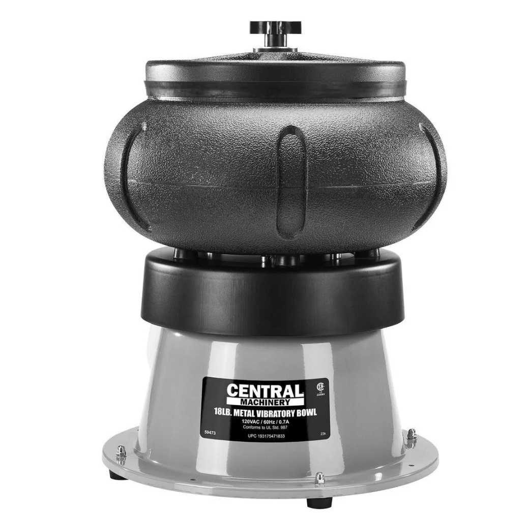

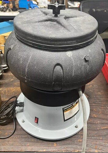

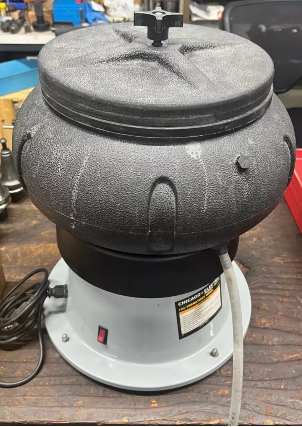

Vibrator
It was emphasized to me that to get professional results one must use a vibrator. One like this for under 100 bucks. It’s for small parts …its a 5lb tumbler with an opening about hand size.
For anything bigger grab a 18lb tumbler like this
You will also need to buy media for different finishes. Use smaller media size that will get into tight places. The media also needs a liquid added to it that looks like this
Many different types of liquid was tried but nothing else gave the needed results so I was told it’s a must have.

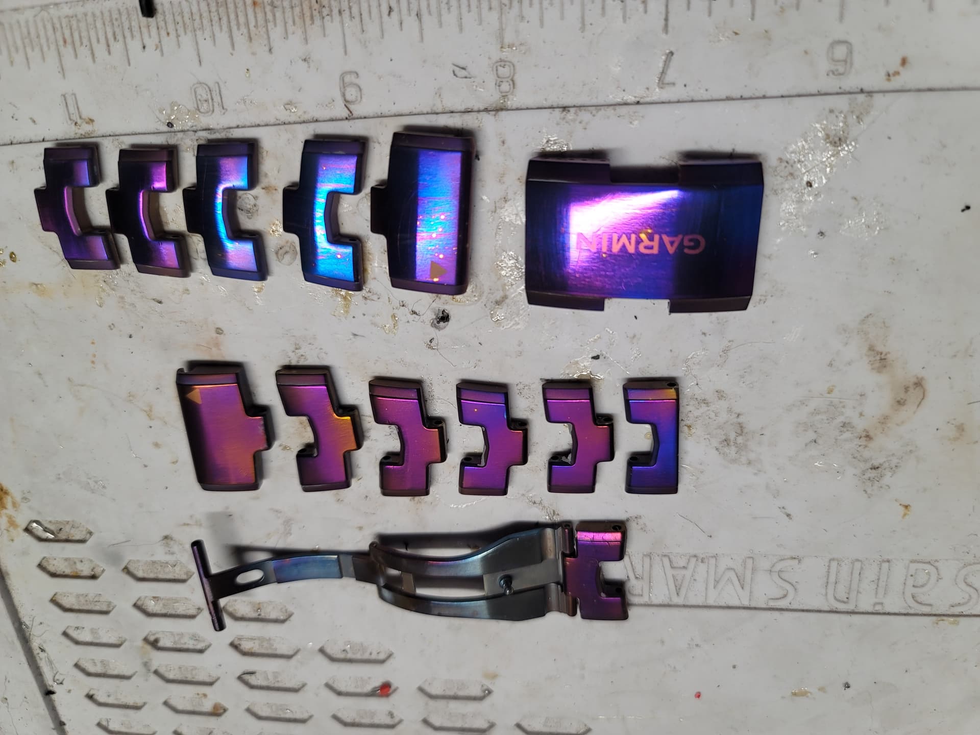

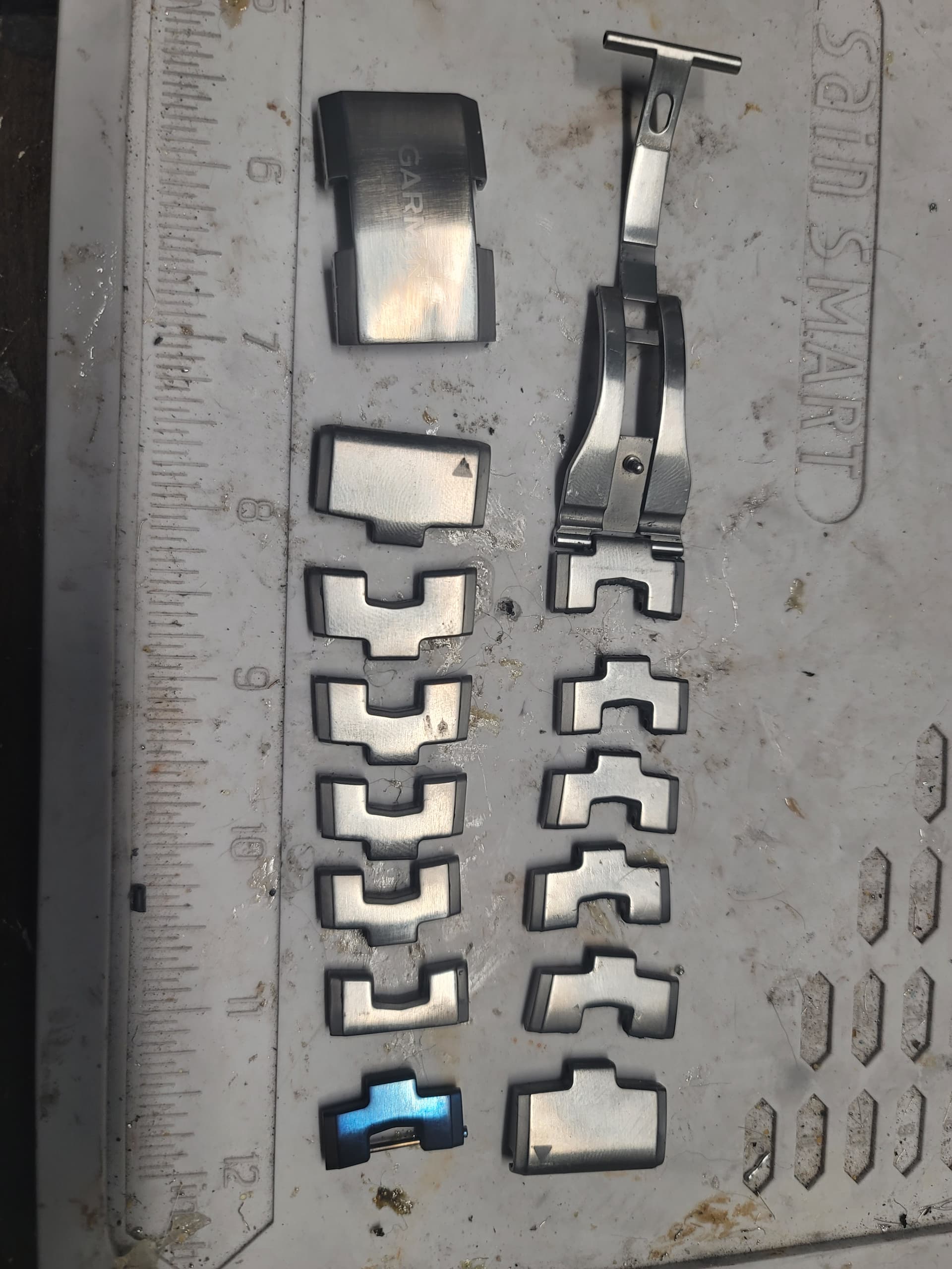

This is heat anodized titanium.
Not the same as aluminum, but still beautiful
Did you decide to anodize these yourself? I just ordered some basic supplies for DIY anodizing so any tips you might have would be great. I know not to drink the battery acid…
Nah, these were done by professionals :sweat_smile:
