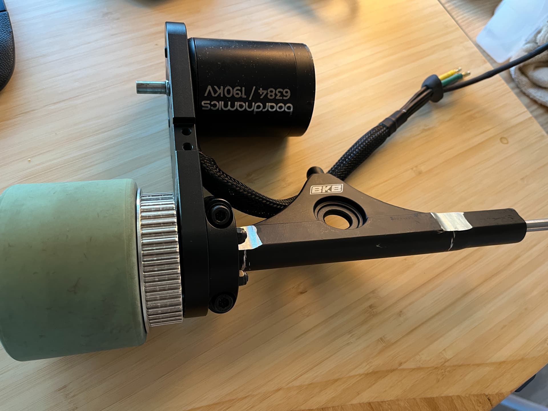

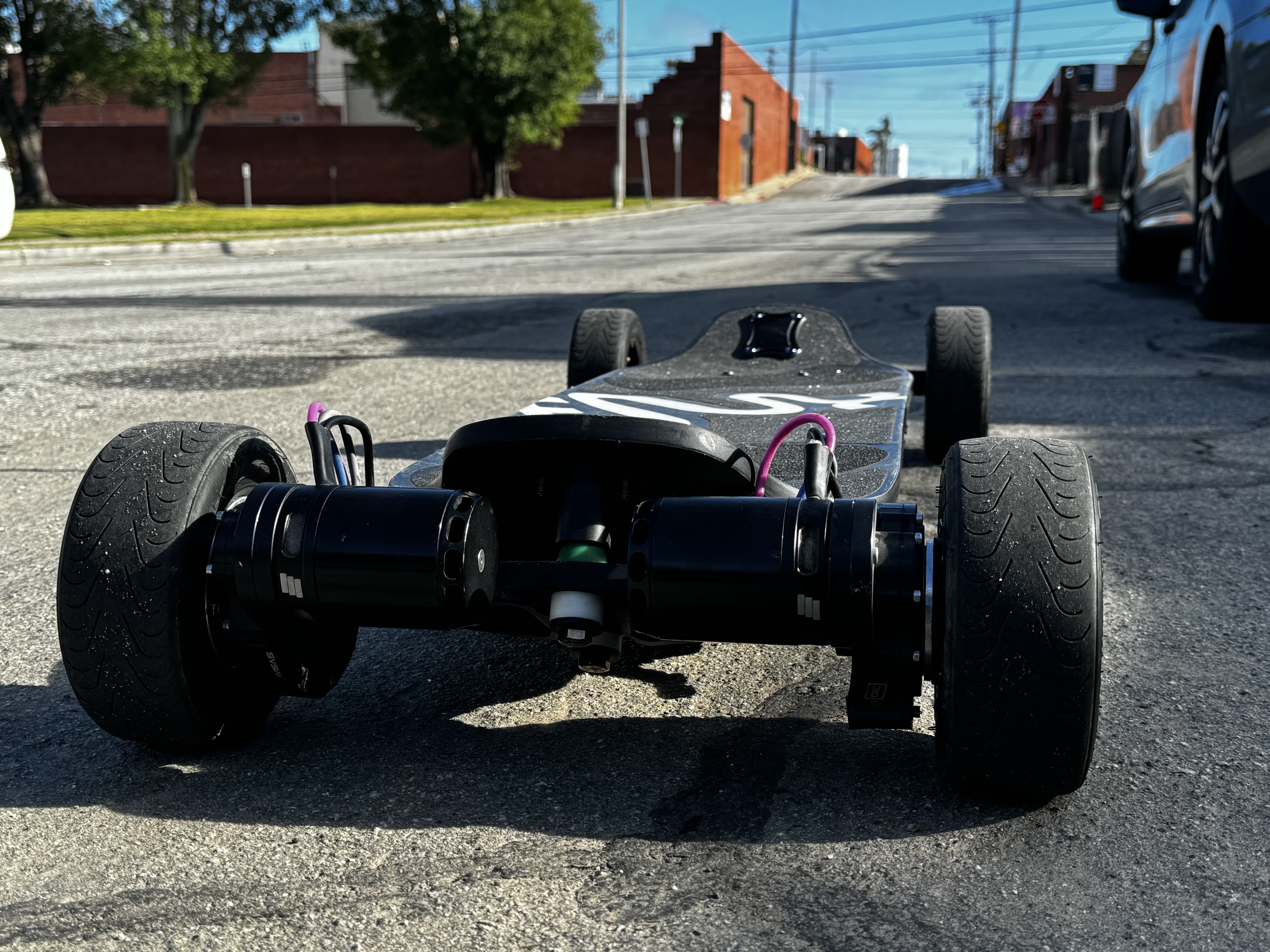

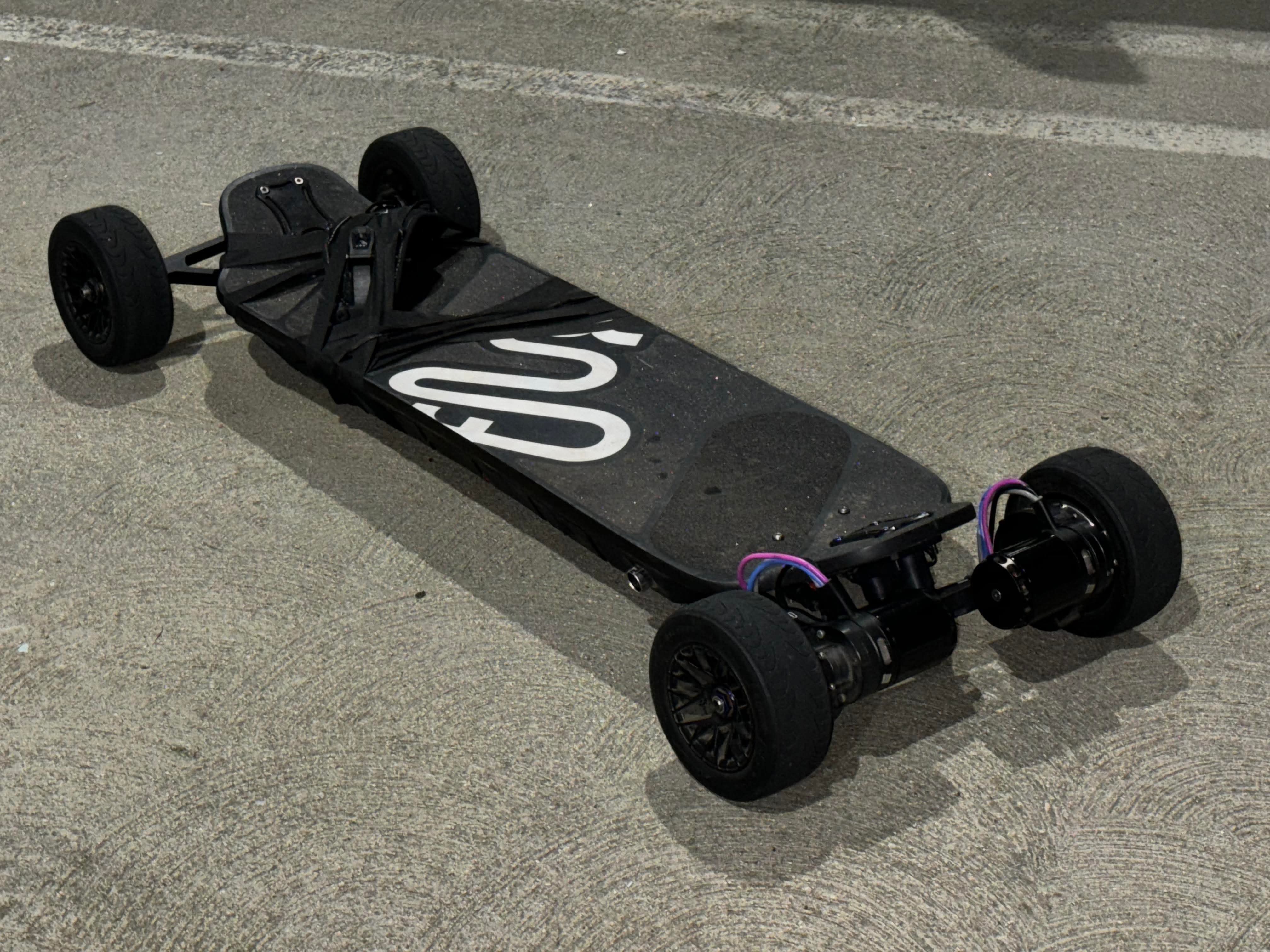

Does anyone know where I could get a 63xx motor mount, Caliber II clamp, with a long center-to-center length greater than 110mm? BN XL on my board currently goes 90-110 but barely not long enough. I know IDEA (efreedom.eu) offers one, but the cost is steep with shipping included. I thought I would ask here. Thanks in advance.

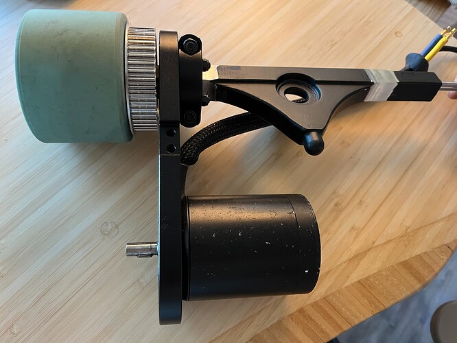

I found an answer and sharing with those who are interested. Torqueboard’s V7 Motor Mount clamps to Caliber II and has center-to-center distance of 103 - 121 mm. The geometry of RKP calls for a long motor mount for motor cans to not interfere with the truck baseplate when reverse mounted (out-the-back motor). This is more or less the unique issue for RKP and not TKP/DKP. And TB’s board has motors reverse mounted on RKP trucks.
As you all may know, with BN220s not being produced within foreseeable future, there is a void of good ~220 mm Caliber II style RKP hangers for street boards. 3D Servisas stocks them but is pricey. You can get TKPs of similar size, but I personally don’t like TKPs. I just think kingpin axis (bushing compression) and pivot axis should be perpendicular for optimum bushing compression.
Anyway, I mixed and matched trucks from BKB (BKB 236mm) and Torqueboard’s motor mount and wanted to document my experience for others looking for a similar setup.
First, if you are using dual motors of 6374 or less, you can just get Torqueboard’s 218mm trucks and their matching motor mounts. However, I had dual 6384s laying around, so I opted for BKB 236mm. BKB 236, however, has very short section where you can clamp your motor mounts. The truck gets thicker than standard Caliber II after this point. This is designed to work with their proprietary motor mounts that does not require much clamping area (Dickyho style) that they don’t sell individually. So I Dremel’d the crap out of the hanger to reduce the thickness of the hanger and was able to clamp on Torqueboard’s motor mount. I ground off 3 flat sides and left the curved side of the hanger alone. You just have to take your time and make sure you leave a smooth and flat surface after grinding if you don’t want the mount to clamp on all wonky.
Second, Torqueboard’s motor mount has a lip around the edge that will prevent some motors from sitting flush. BN/Flipsky style motors have a chamfer around the motor face that interfaces nicely with it, but Maytech or Reacher motors interfere with it. You may have to grind off the lip depending on your motor.
Third, BKB 236s have criminally short axles (32 mm of usable length), so you need wheel pulleys with minimal stack height and standard street thane wheels only. Evolve’s pulleys didn’t work for me, but BN’s CNC pulley did. Barely enough length for speed rings, let alone axle spacers.
It was a lot of head-scratching grinding, but hope this helps others trying to build a street board drivetrain. Probably easiest option is Torqueboard’s trucks and motor mounts and sticking to 6374 or smaller motors (which is absolutely plenty).

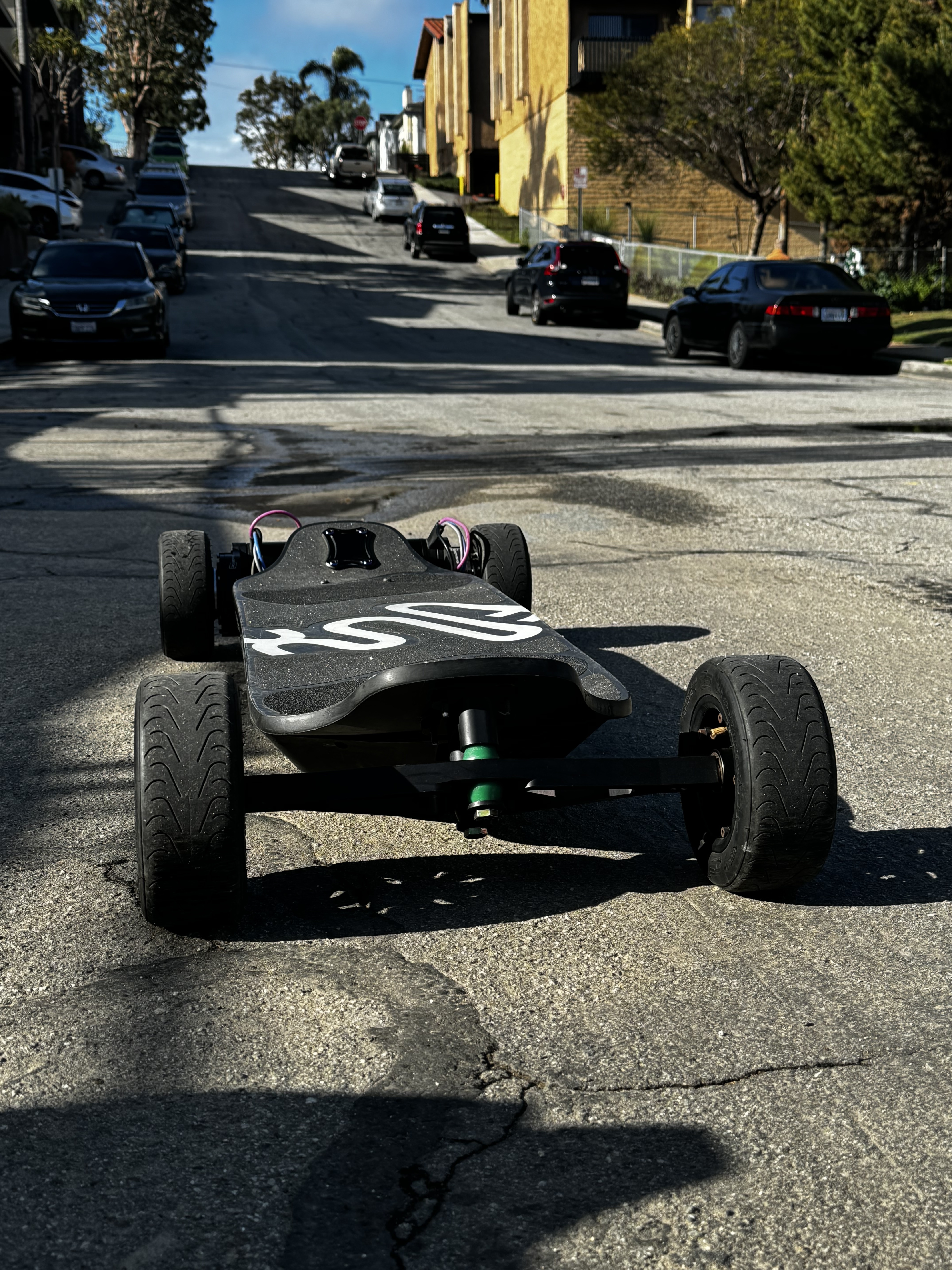

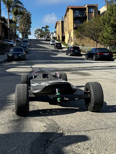

I used to, I sold them to Micheal LoBlue

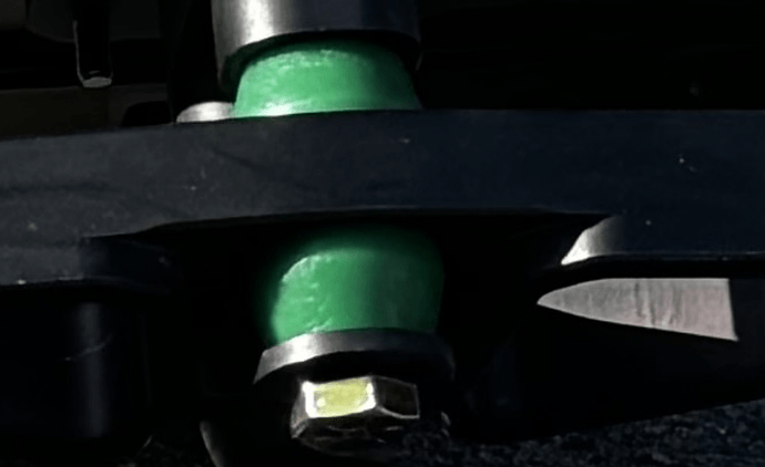

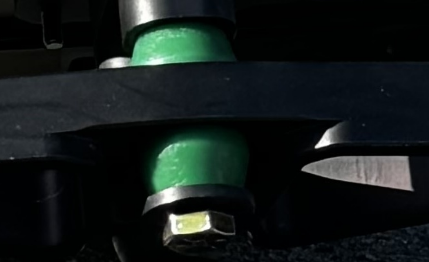

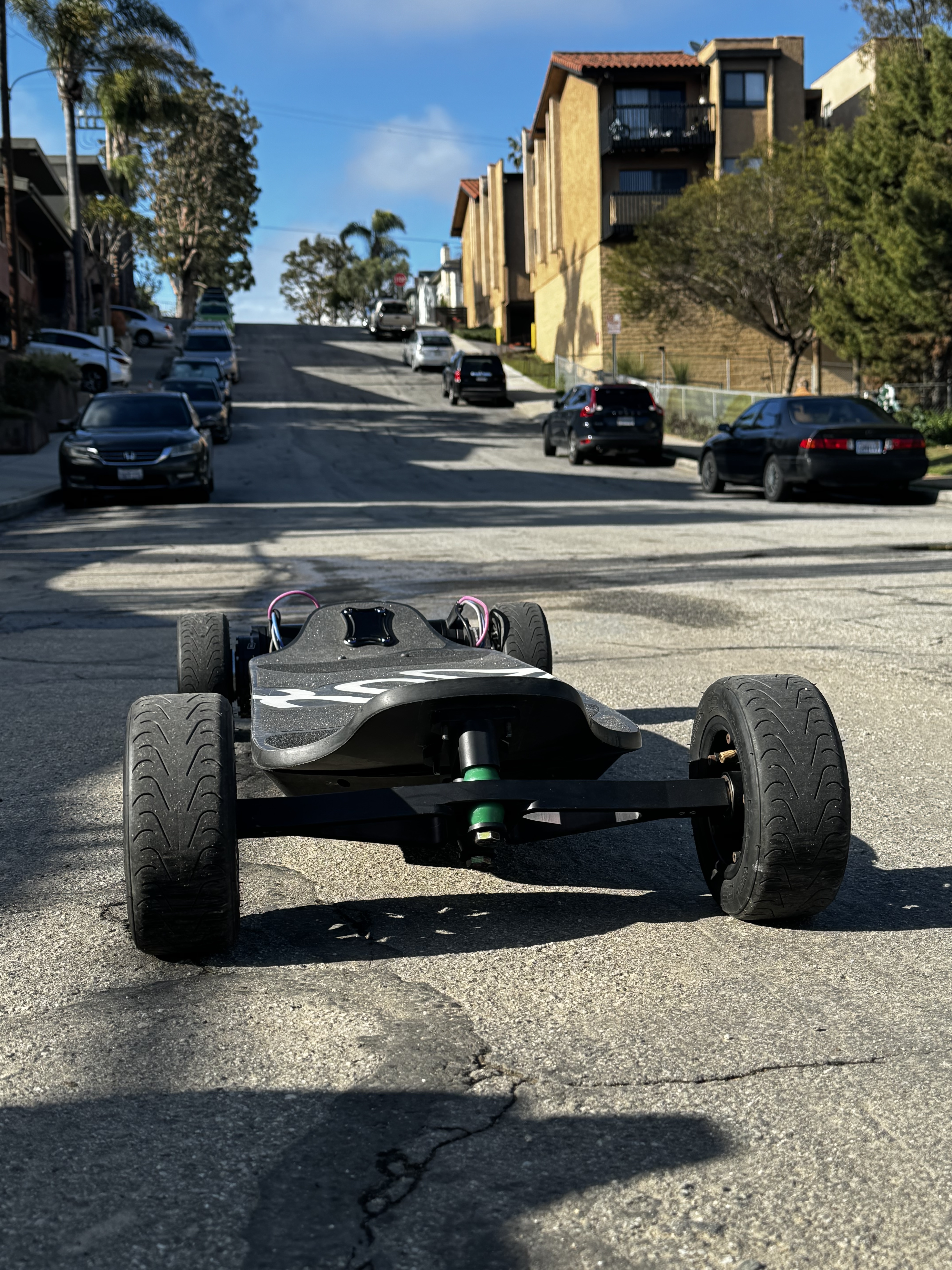

They were pretty sweet for short track until I decided to act like I’ve ridden them at 40mph and hit the throttle really hard rapidly approaching higher speeds resulting in a wobbly fate :grimacing: this was prior to tuning tho. So really user error.
I’d put them up against Tito trucks as a contender
With the right tuning these trucks felt much better than Mbs III trucks.
The bushing setup took some @RipTideSports
( Brad Magic ) at last years esk8con
Brad really helped to make them feel right with a rather odd bushing combination onsite at esk8con and made the trucks feel a little better.
Though he recommended actually modifying the trucks because I believe the hangar bushing inset was side loading the bushing causing a weird feel
@IDEA I never mentioned it but maybe it would be something to try?
The final bushing combo I had for those trucks was a llittle weird
x6 98cone krank everywhere else
x2 white 87 krank barrels on the underside of the rear hangar
Do they turn?
Damn that’s the weirdest bushing combo I ever heard :sweat_smile: Sweet board though!
I think it was actually x6 KranK 90a Cones (green) If I remember, we inverted them so the hanger would not interfere as much with the bushing when turning.
Well, they obviously lean :joy: and it looks like you’re trying to turn.
They just seem like Air’s all over again. From that photo the hanger is still perpendicular to the deck.
