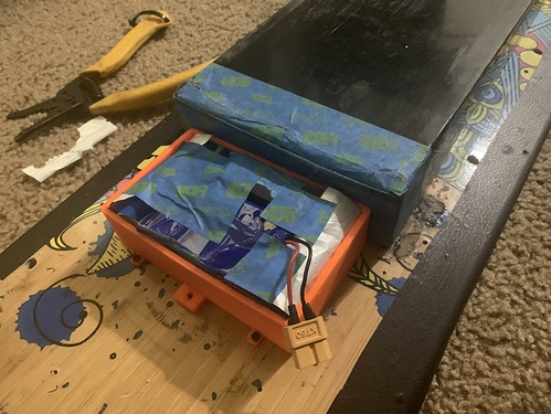

This board has 2 modes on purpose, cruise and launch mode. In the “launch mode”, without load on it, it will just spin out of control. With load on it, it reaches 45mph. I also added a second battery, to supply the lights, horn, sound system, etc. This board is not finished.

Info on the pictures
Yes I know the motors are very low to the ground, I had no problems with them even going off curbs, though I will get longer mounts in the future to be on the safe side.
In the first picture, the board was under construction, but in the last picture you will see that we added a custom case. The fourth picture, in the yellow 3D printed case, is the second battery. In the seventh picture, is the lights which are RGB and can be controlled by the remote.

According to a calcuator, at 12s, 190kv, and 90mm, you need a 0.58:1 gear ratio to reach 45mph, this is very small, I doubt you use such a small gear ratio. 1.5 seconds 0-30 with that seems impossible.

I like the idea between the different modes. What did you do on the software side to differentiate between launch mode and cruise mode? Is it just higher current limits? I imagined launch mode would push or exceed the limits of the hardware for a short period of time, requiring a cool down period of sorts.
