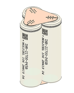

Hey everyone, first-time poster, long-time looker. I am deciding to continue my build I started a while ago, but I am getting to the battery and have some questions.
I am making a 12S 3P battery from 21700 cells, but I am running into a dilemma. How thin can I have my P group connections (I want copper, but I’m fine with nickel for the triangles of metal), and how should I connect my P groups together nicely while allowing for flexing of the battery pack (is soldering a thick wire to the triangle enough, or would that damage the batteries)?
If I have to stack nickel plates, how should I ensure that my series connection is connected well to all plates in the middle?
Each P group is going to be wrapped with Fish Paper (battery “O-rings” as well) and Kapton tape.

Really like the model you have there, looking clean so far. Makes my mocking up look like a crayon drawing :grin:

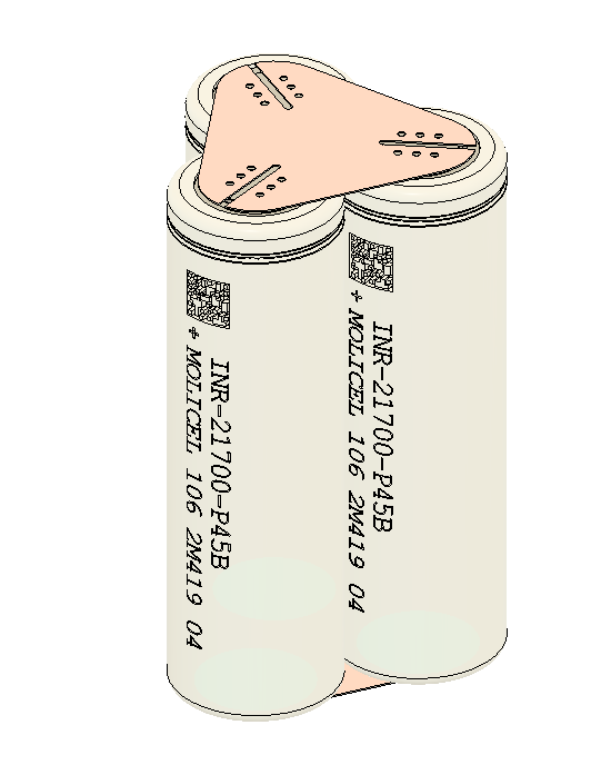

If i were you i’d consider adding a ‘tab’ to solder to.
It allows you a little less anxiety when soldering, as you aren’t soldering directly over the cell and you can introduce cooling as well.
It can be folded down over the side or back on top of itself once properly soldered
I really like that, thank you
Thank you! If only my full board mockup were this nice :joy::rofl:

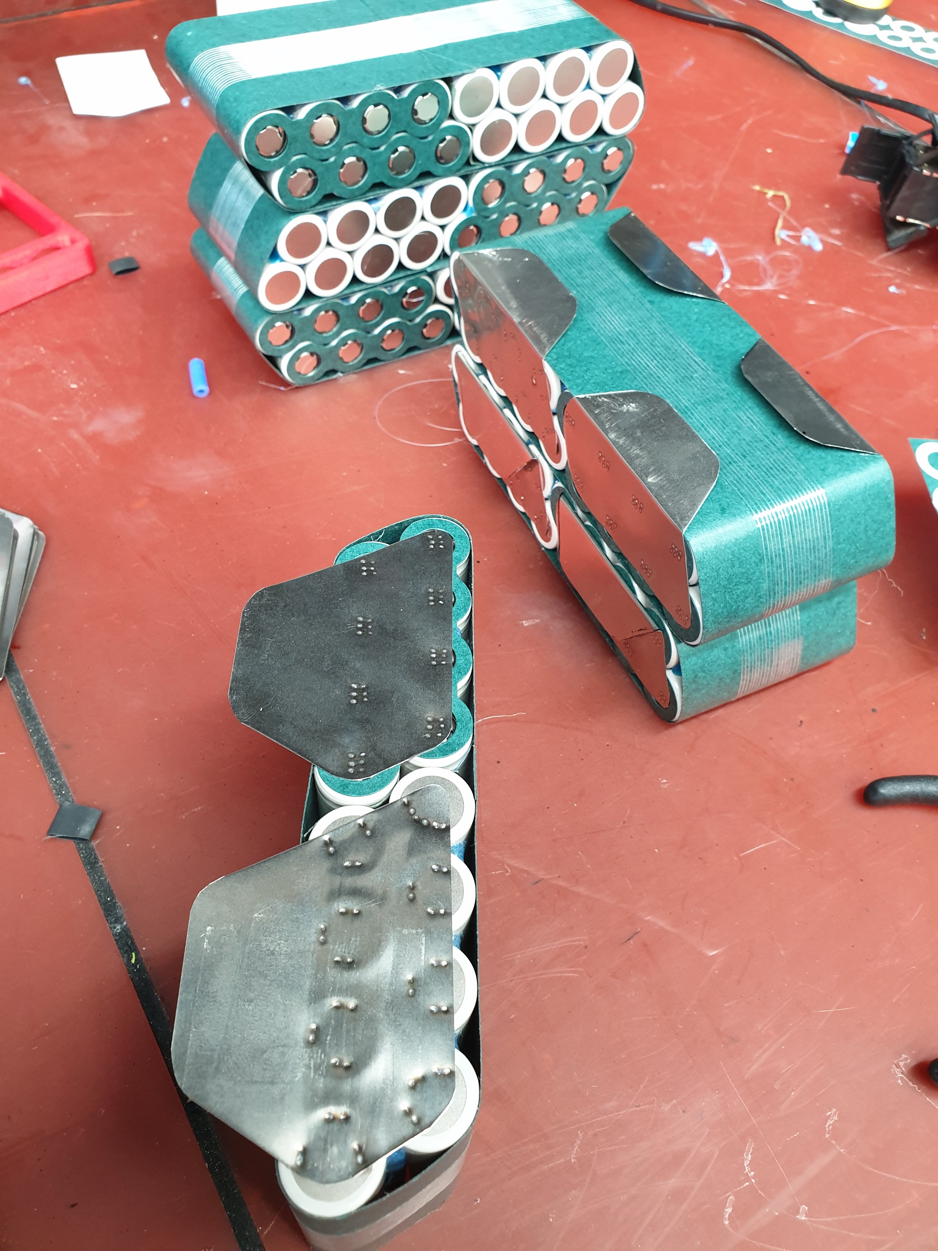

I have used the tab Fold over shoulder method twice now, but soldered after it is folded.
I use 0.5mm G10 fiberglass sheets between the tab and the double fishpapered cell, and can see no heat damage on the G10 when I remove it.
My concerns are that with copper’s great thermal conductivity, that soldering the series connections onto the tabs, introduces a more than deairable amount of heat into the cells, than would pure nickel.
The folded copper tins so easily, and I’ve only done dual 14awg series connections, but I want the copper splayed flat, and the curved tip ceramic tweezers are greT at this, but a third hand to feed the extra solder would be great.

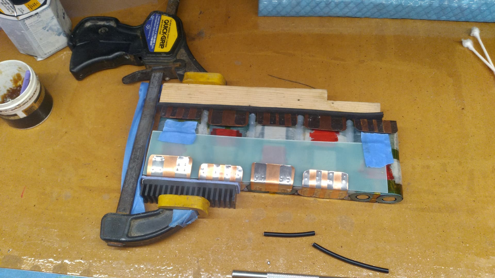

To minimize heat entering the cell I attached a thermal pad to a heatsink, and clamp it to the p groups being soldered together.
I’ve no way to quantify the efficacy of this method, but the heatsink comes away warm, so it does something.
That looks clean. What thickness of nickel sheet are you using?
That was many moons ago, it was 0.15mm nickel
